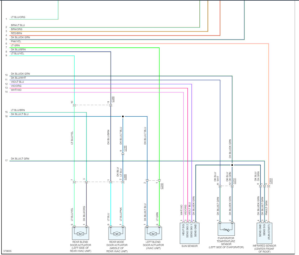

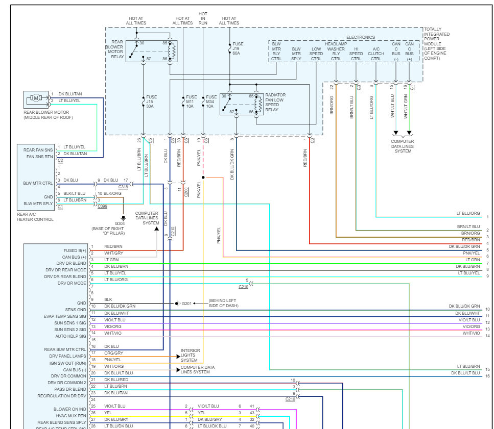

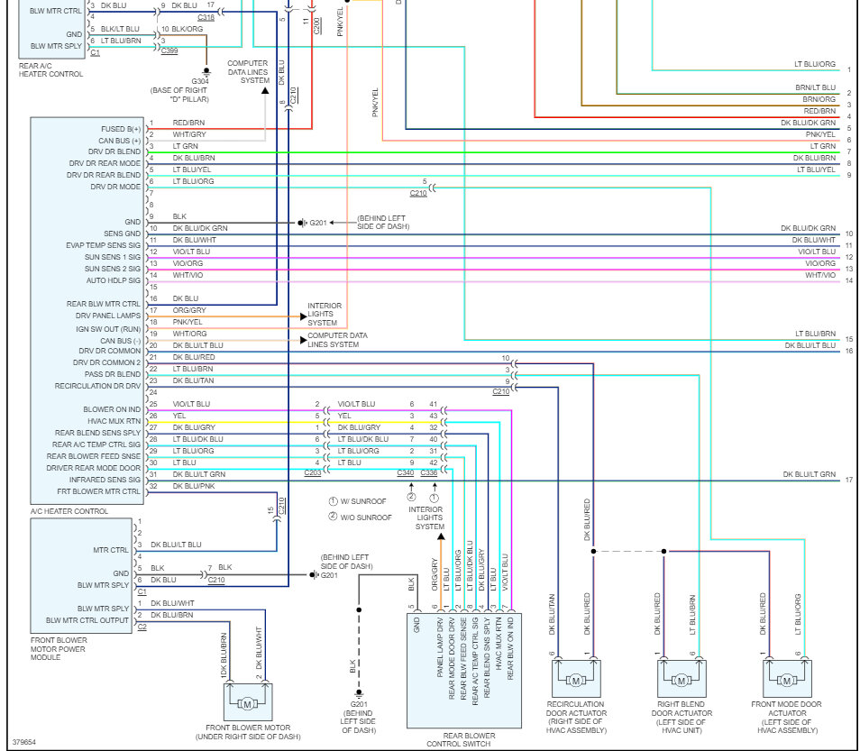

Did this problem happen before the repair? If so, it will not be related, and we will need you to start a new thread. It still sounds like they left something off like a ground wire or an electrical connector is dirty or not plugged in completely. There is a ground G304 at the base of the right-side door pillar I would check, here is the blower motor wiring diagrams so you can see how the system works, if the ground is okay, we should do a CAN scan. You can get a CAN scanner (Controller Area Network) which will work on most cars from Amazon.

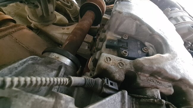

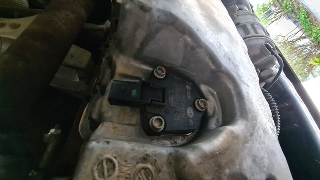

I found a disconnected wire (photo attached).
Thanks for the electrical diagrams, I traced them and found my G304 ground near my pillar. The electrical diagram says G304 is "Base of right D Pillar". "D" means the rear pillar. I had attached 2 years ago additional wires to this ground: my house battery, inverter and dcdc charger. These all predate the problem with the fan speed and have all been working flawlessly for me for the past 2 years.
I have been researching which odb2 CAN scanner to buy so I can run some diagnostics for you. I am leaning towards a Bluetooth scanner, hopefully that supports CAN as well as has the ability to turn off the 'service due' indicator.
So how did I find a disconnected wire?
One week ago, I started hearing some rattling sounds whenever I drive. It's happening all the time but erratically. I imagine there is a tool or something loose in the engine, rolling around.
So, I took the bottom plastic shroud off and had a look. To my surprise, I found an electrical socket that looked like it should have something plugged into it. Then I found a cable not plugged in to anything. So, I have plugged them together and they fit well.
I am in disbelief at my mechanic. Even when I took it back to them and explained the problem, how could they miss this? I am pretty annoyed.
Do you know what this cable does?
Oct 6, 2023 at 4:58 PM
  • 55,423 POSTS
Good find, it looks like the engine oil temperature and level sensor. After you plugged it in and fixed the ground did the blower operation return?
