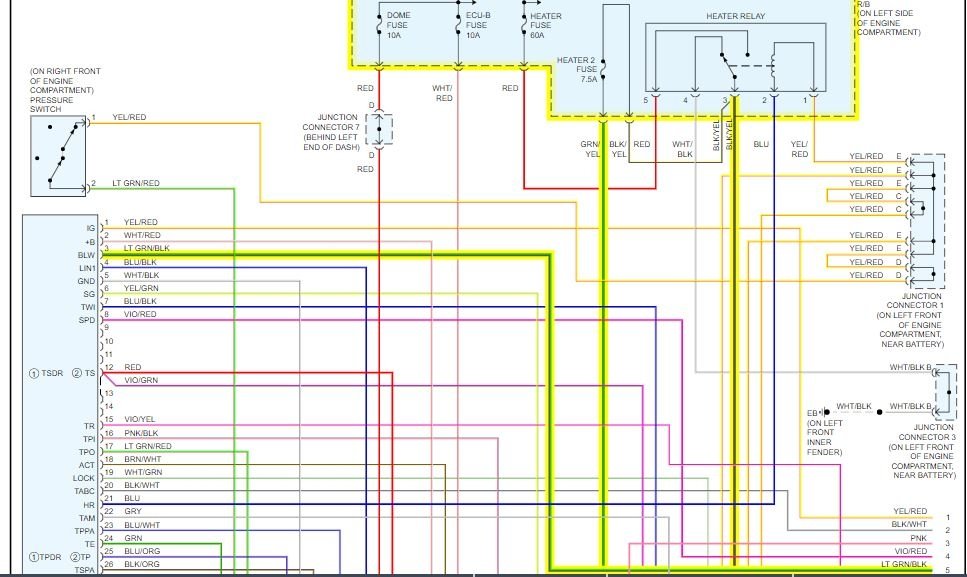

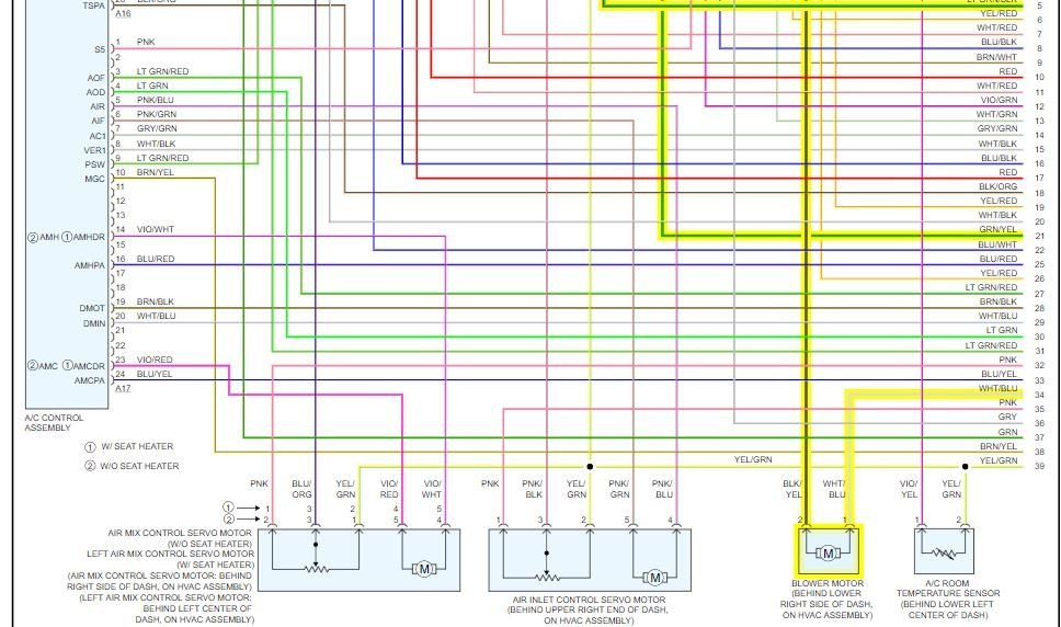

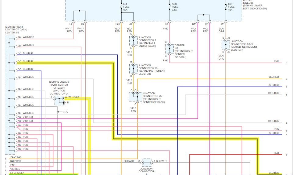

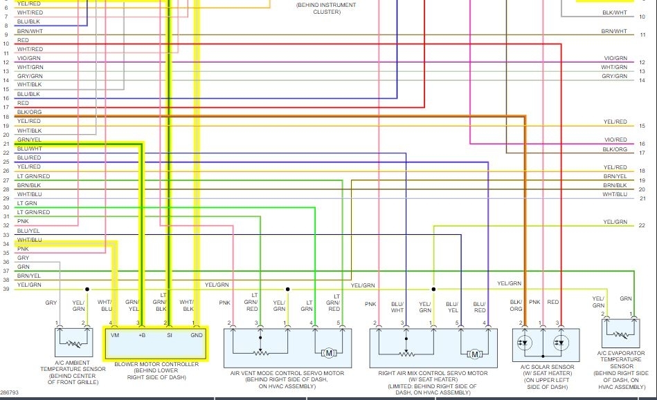

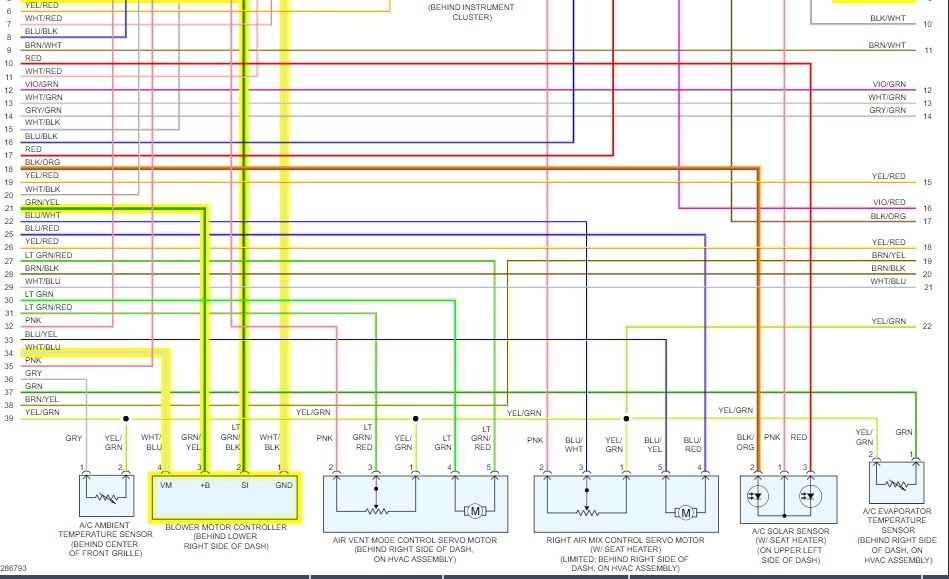

Hello. Thanks in advance for your help.
I’m having issues with my HVAC. Sometimes it works, sometimes it doesn’t. That said, oftentimes if I hit a speed bump it will start working again. Maybe something loose? I do not know.
Please help
Feb 27, 2020 at 7:50 AM

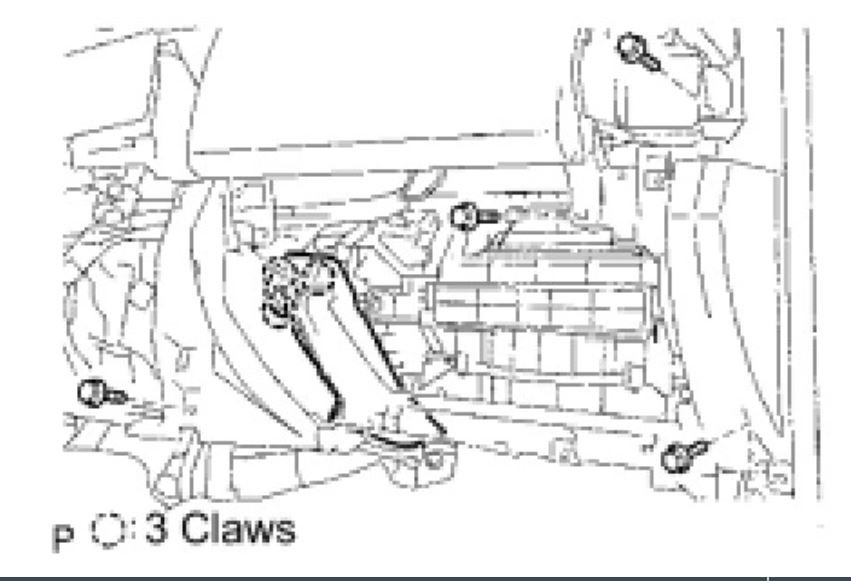

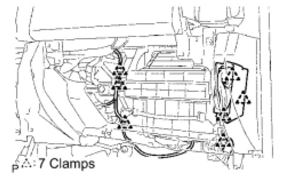

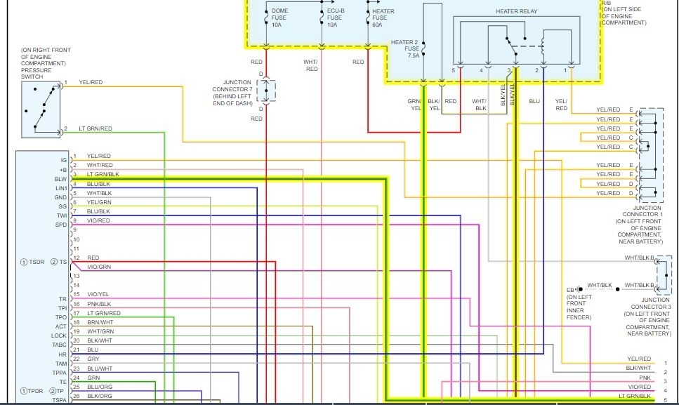

Good afternoon,
It sounds like a bad connection at the blower or the resistor itself.
The blower motor s behind the glove box. I would check the connector at the blower motor.
I attached some pictures and a wiring diagram.

Okay, I finally got under the dash and unplugged the resistor. It doesn't appear burnt, but I'm unsure as to how it's supposed to look. Haha.. Should I go ahead and replace it?
Mar 3, 2020 at 5:22 AM
Did you check for voltage to the resistor?
