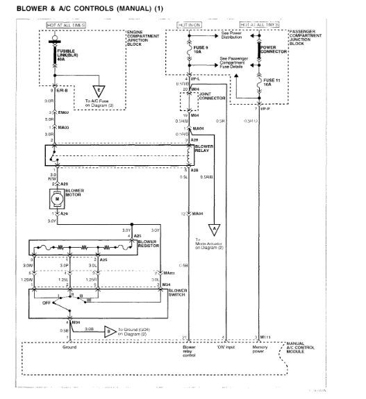

Fan runs on high at all time.
Nov 15, 2018 at 5:53 AM
Good morning.
The most common cause for this issue is a shorted to power blower resistor for the blower motor.
I attached the procedure and a wiring diagram for the resistor for you below.

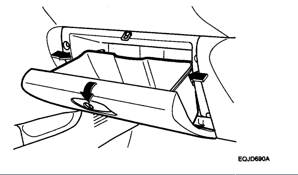

Glove Box
2. After opening the glove box, pull it downward by pressing the both side of glove box inward.

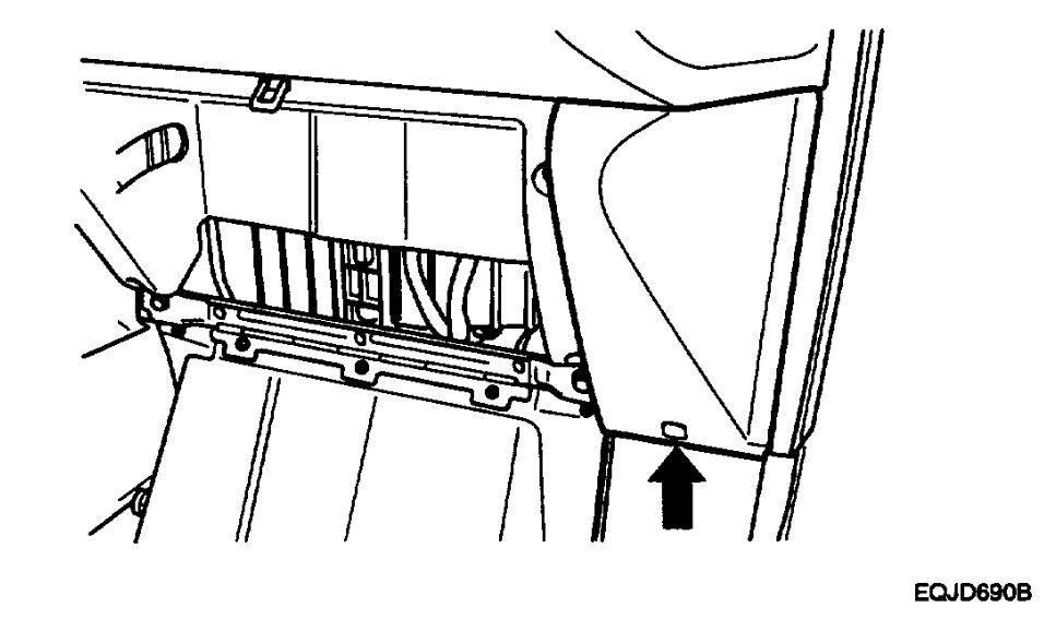

Side Cover Of Crash Pad
3. Remove the lower side cover of the crash pad.

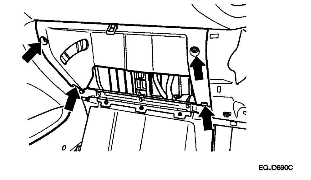

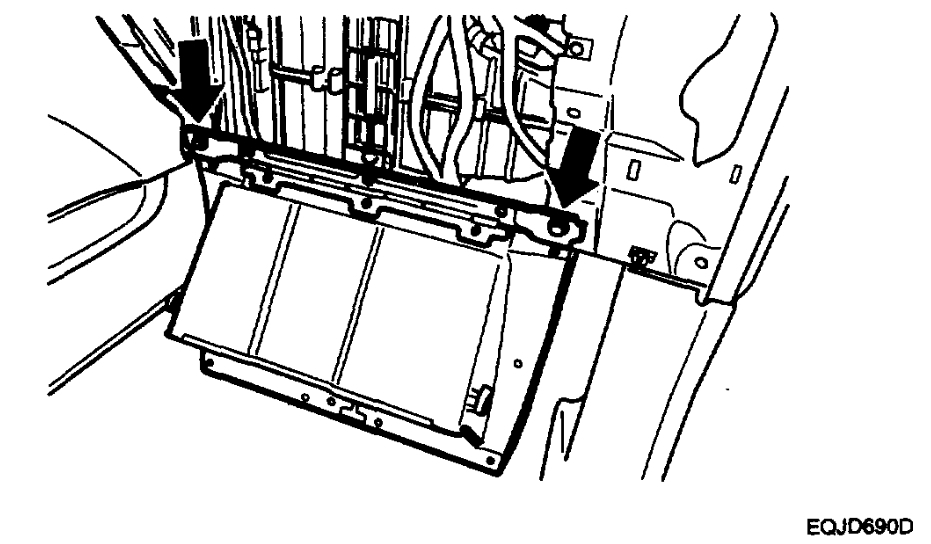

Bolt Locations
5. Loosen the bolts of glove box.

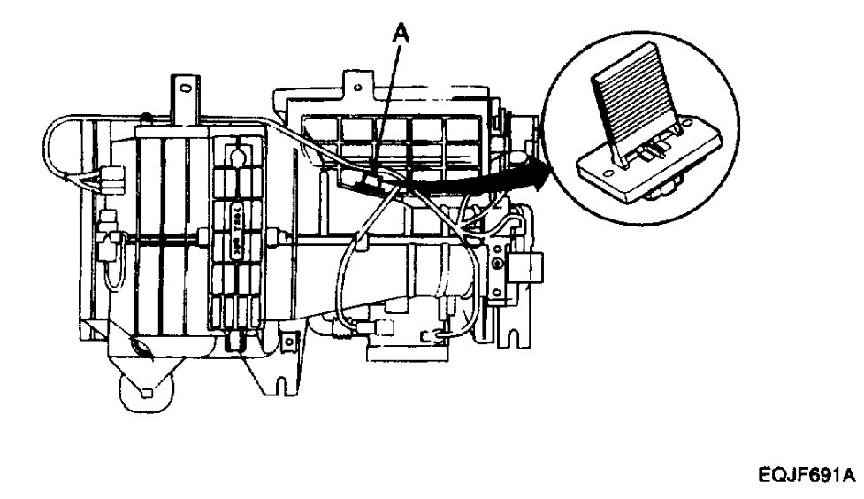

Blower Resistor (Manual)
6. Disconnect the blower heater resistor connector (A).
7. Loosen the resistor fixing screw and remove the resistor.
Caution: Use the short length positive (+) screwdriver to remove the screw
8. Replace the resistor with a new one.
