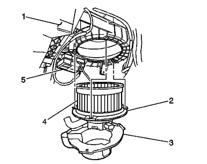

Blower fan stopped working.

Also where is blower fan located? It is my parents did not look at yet usually it is on firewall under hood possibly under dash on passenger side.

Good morning,
I attached a picture and the procedure for you for the blower motor.
REMOVAL PROCEDURE
1. Remove the right closeout/insulator panel.
2. Remove the I/P storage compartment door.
ImageOpen In New TabZoom/Print
3. Disconnect the blower motor electrical connector.
4. Remove the blower motor mounting screws.
5. Remove the blower motor cooling tube.
6. Remove the blower motor (2).
