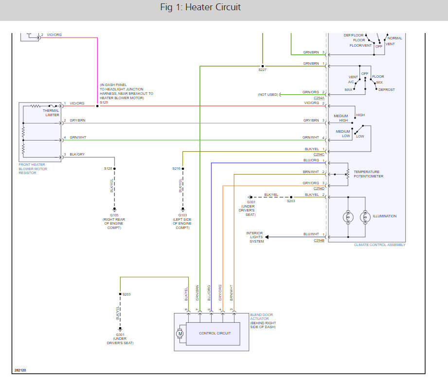

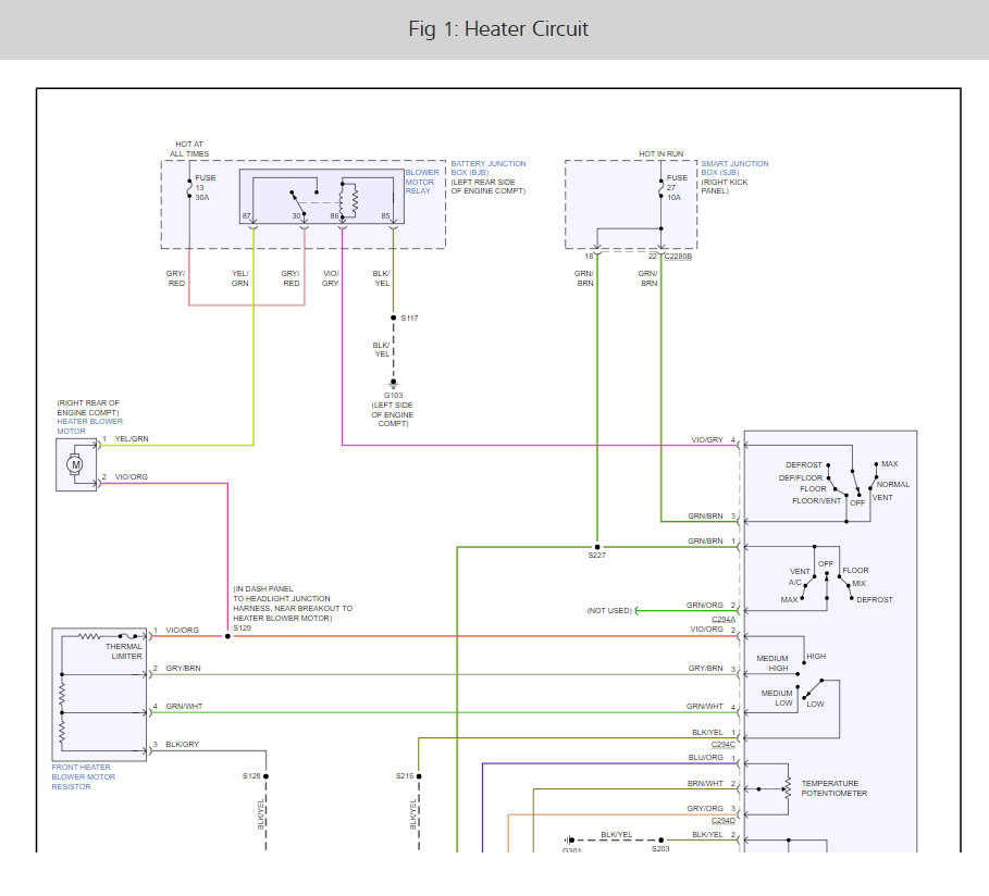

Blower motor not working?
2008 FORD RANGER
85,000 MILES • 2.3L • 4 CYL • 2WD • MANUAL
SNORRI
Replaced blower motor resistor, fan still will not come on.

Hello, I am Danny.
Have you tested the blower motor itself to see if working? Hope this helps and feel free to ask any questions. I have attached a tutorial to show what is involved. Thanks for using 2CarPros.
Danny-
https://www.2carpros.com/articles/blower-fan-motor-works-on-high-speed-only
