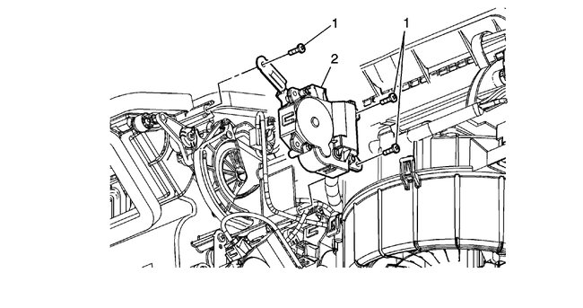

The heater in my car is not working, the air conditioner works just fine.
Nov 8, 2017 at 1:40 PM
  • 55,433 POSTS

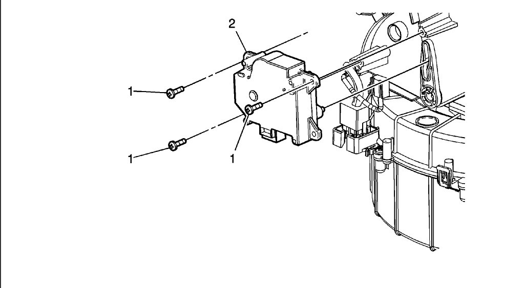

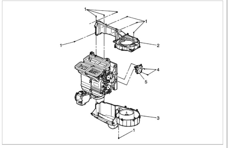

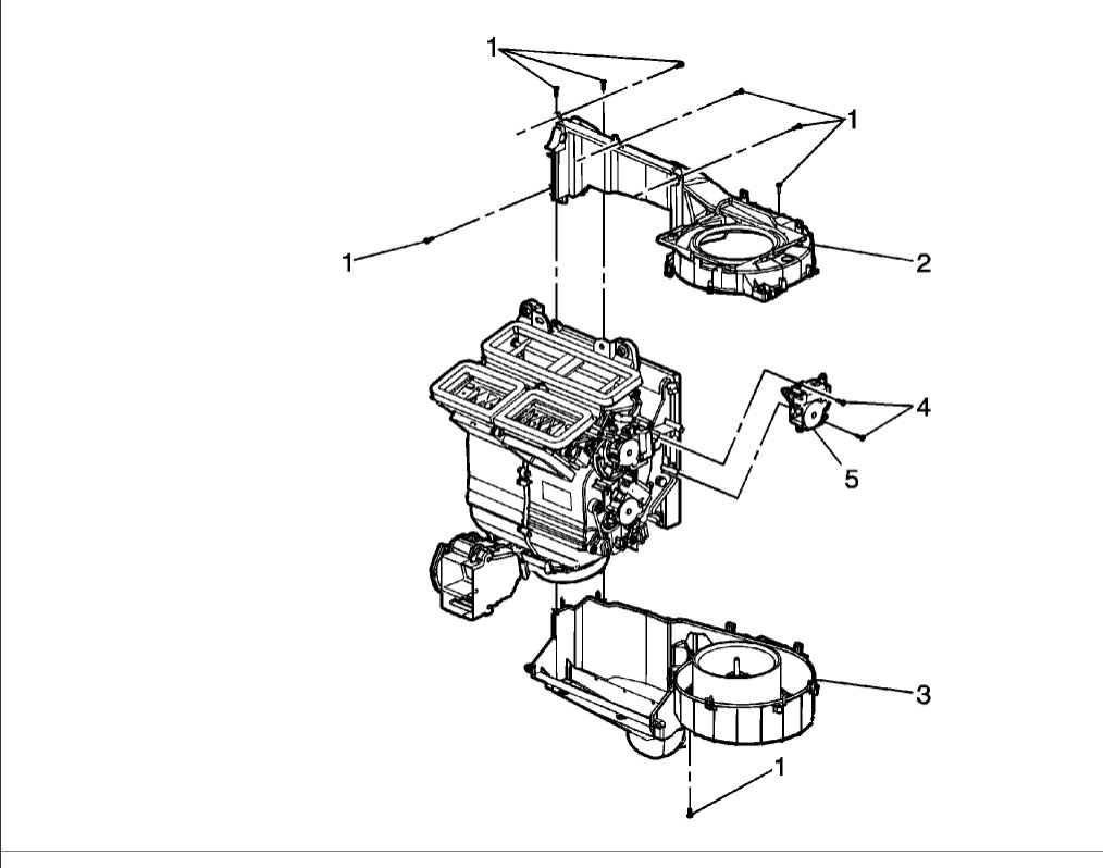

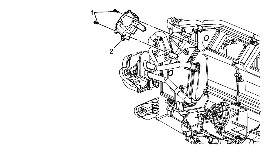

This sounds like you have a temperature blend door actuator that has stopped working. When this happens the door that controls the temperature stops moving from hot to cold. Here are two guides that will help us get the problem fixed. This one will give you an idea of what to expect when doing the job.
and
Here is how it will be like to do the repair on your car (below). Left, right, temperature and re-circulation mode actuators in this order. Non automatic systems are a little different the last diagram is the manual temperature actuator.
