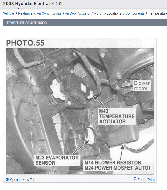

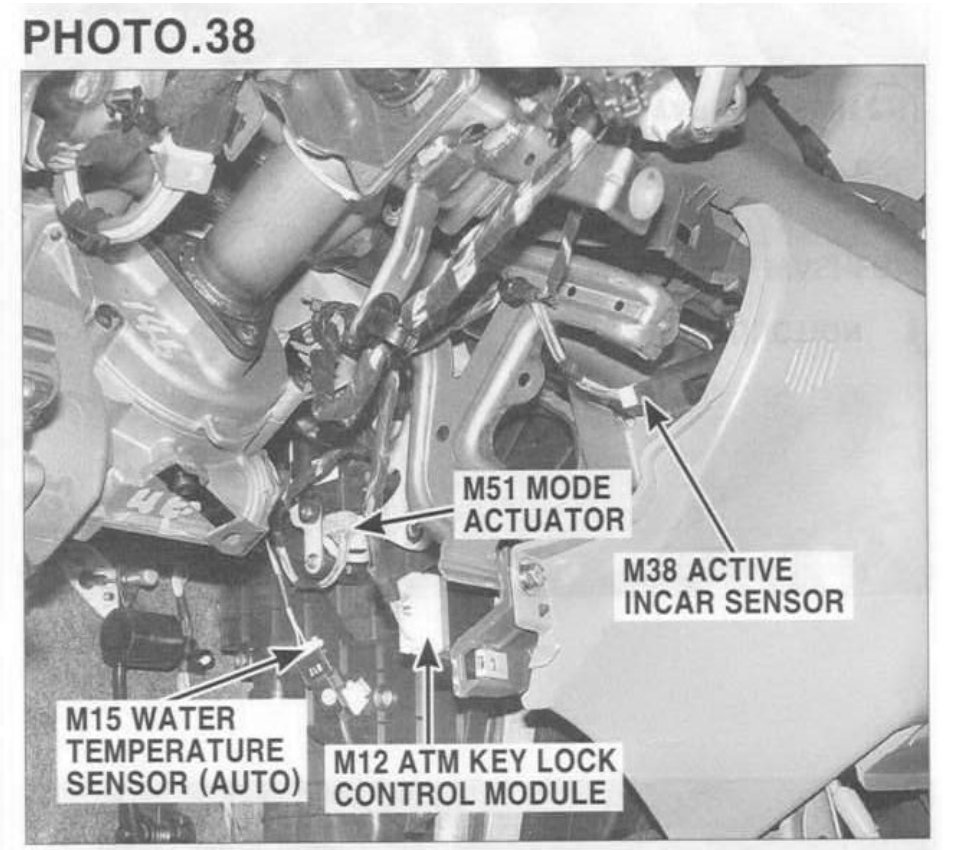

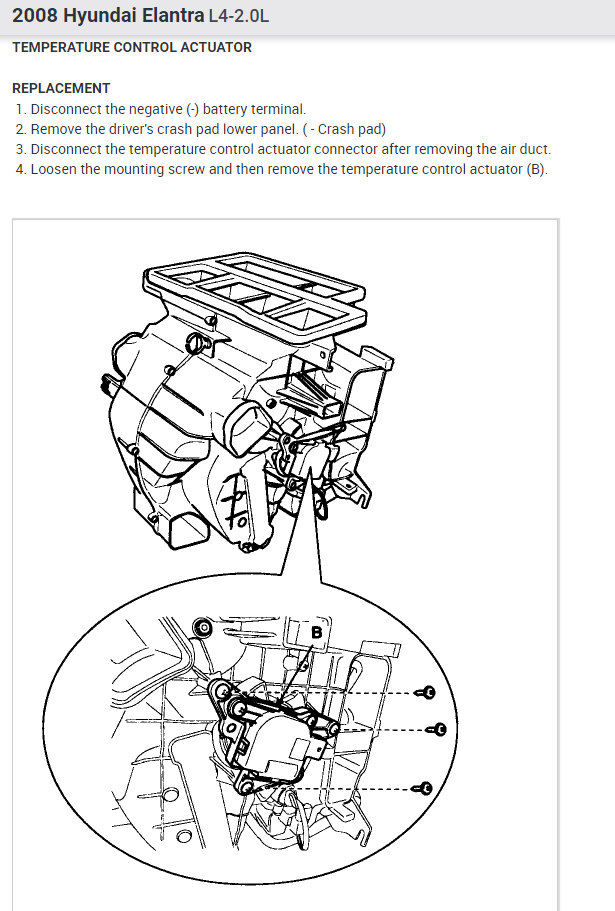

Where is the heater door actuator located?
2008 HYUNDAI ELANTRA
342,000 MILES • 2.0L • 4 CYL • 2WD • AUTOMATIC
KEITHAKINSLAND
where is the actuator?
Sep 20, 2021 at 4:11 AM
SQM
  • 6,383 POSTS

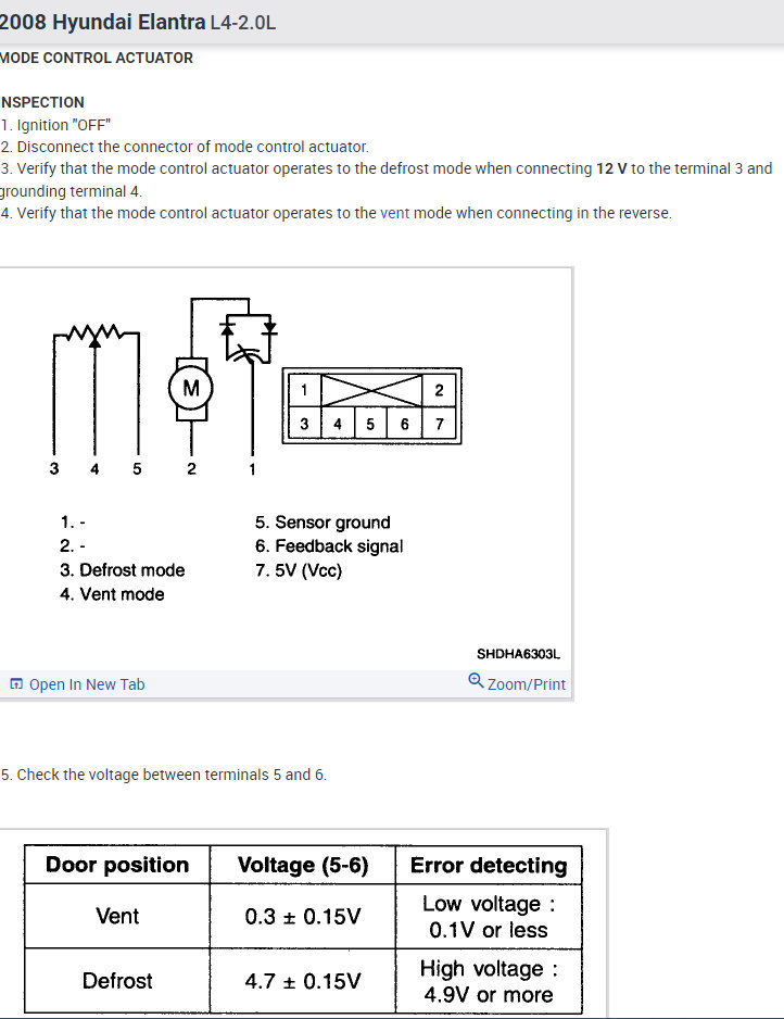

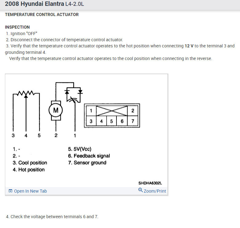

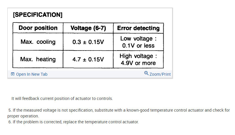

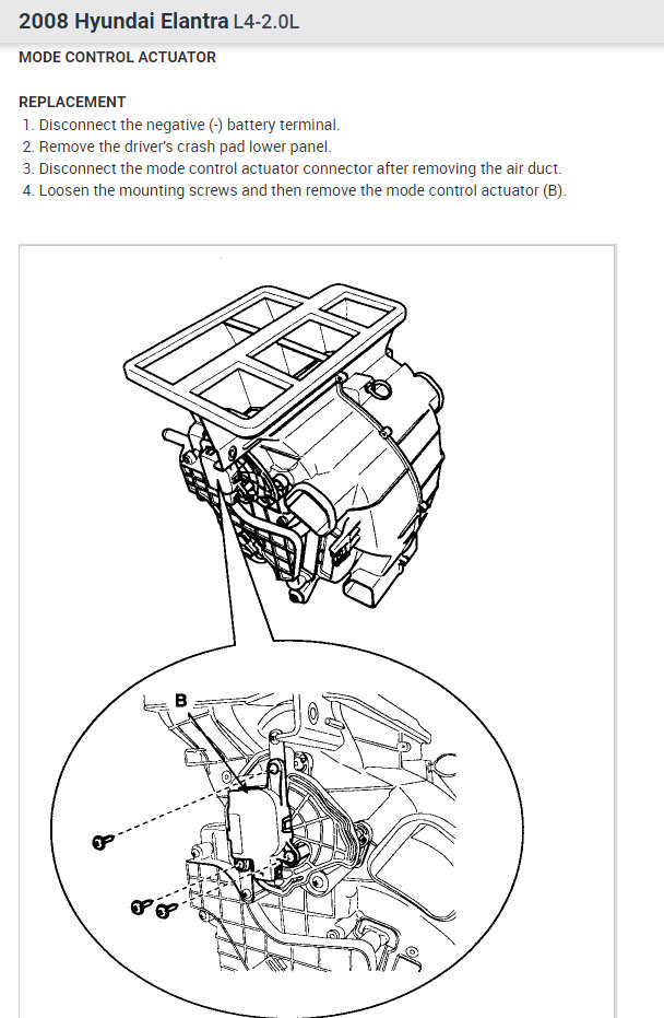

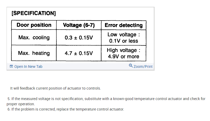

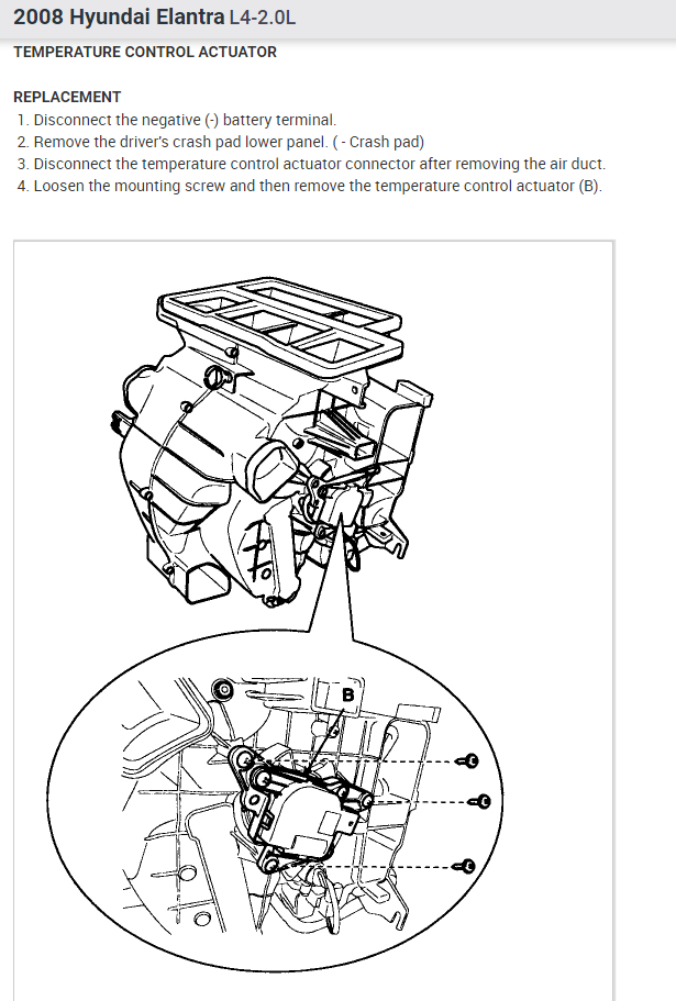

The blend door and the mode door actuators are located on either side of the HVAC box under the dash. The Blend door actuator is on the right side and the mode door actuator on the left side of the box.
The blend door actuator controls the temperature and the mode door actuator control where the air going to come out of.
https://www.2carpros.com/articles/low-or-no-air-flow-from-vents
I have attached diagrams and pictures for your reference (look below).
Pleas let me know of any questions.
