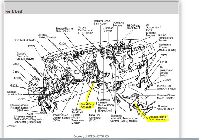

I need to know where it’s located and the easiest way to replace it. Thank you.
Jun 14, 2019 at 11:48 PM
SCGRANTURISMO
  • 4,897 POSTS

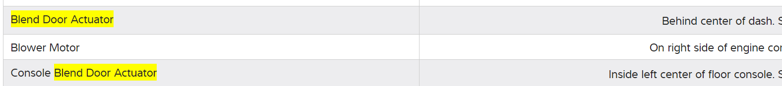

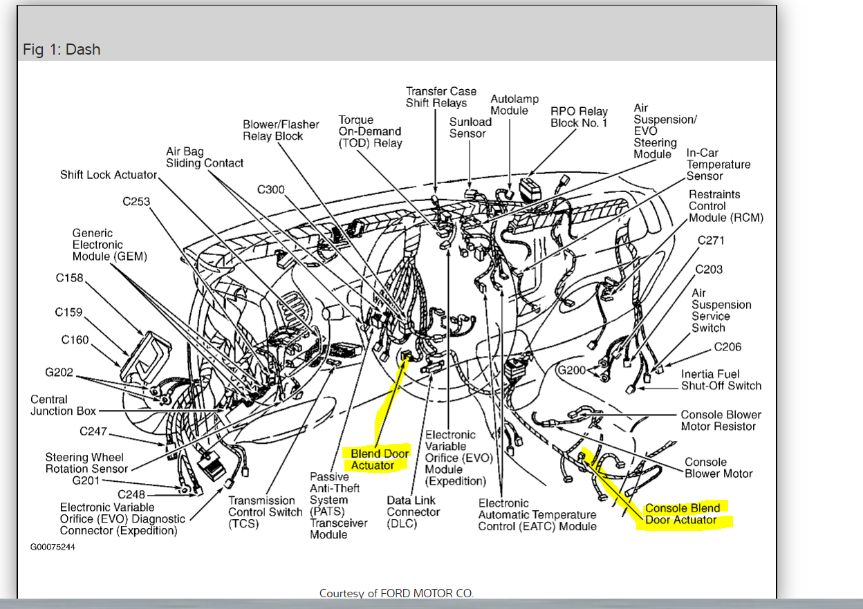

There are two different Blend Door Actuators on your vehicle. I have included a description and diagram showing you where both are located in the diagrams down below. I have also included a link for you to go to below:
Please go through this guide and get back to us with what you are able to find out.
