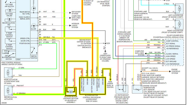

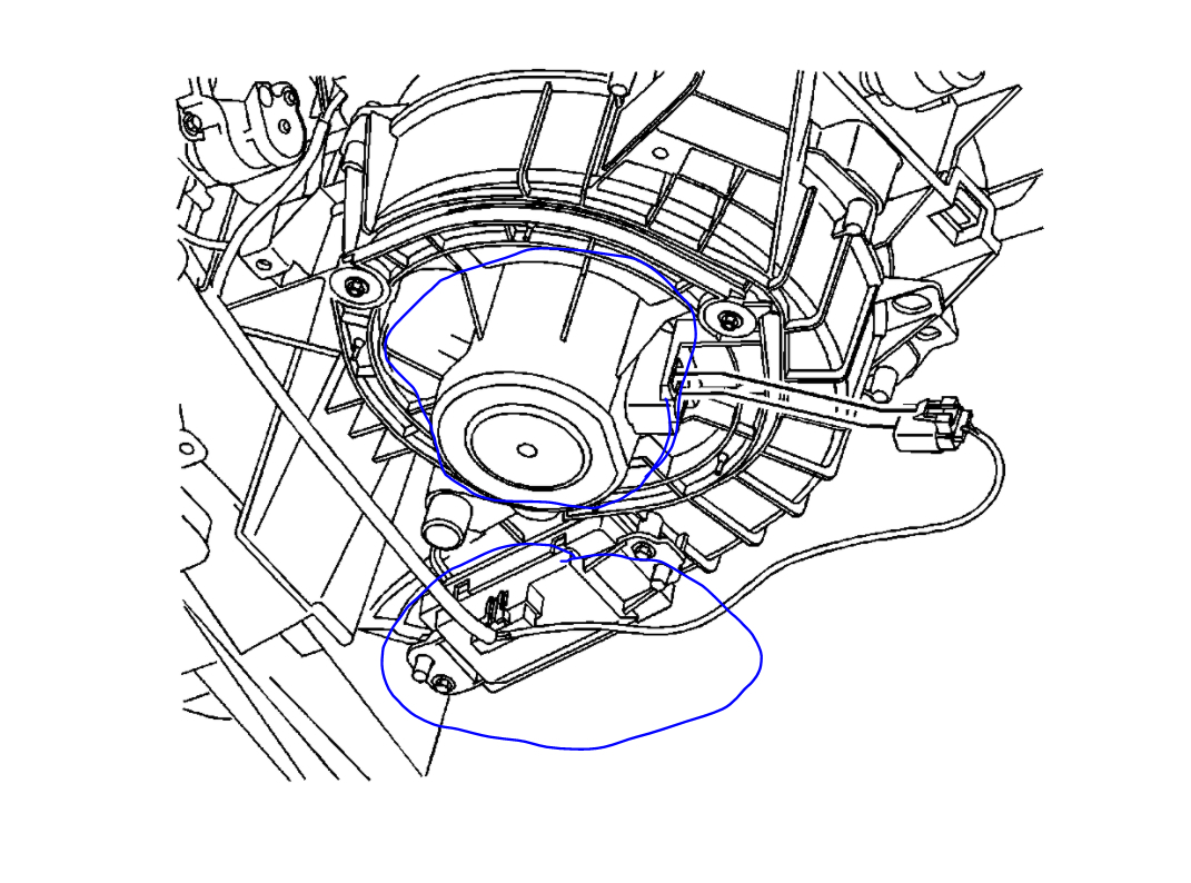

No heat, no air will come out of the A/C or heater.
Feb 10, 2021 at 11:28 AM
Good morning,

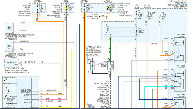

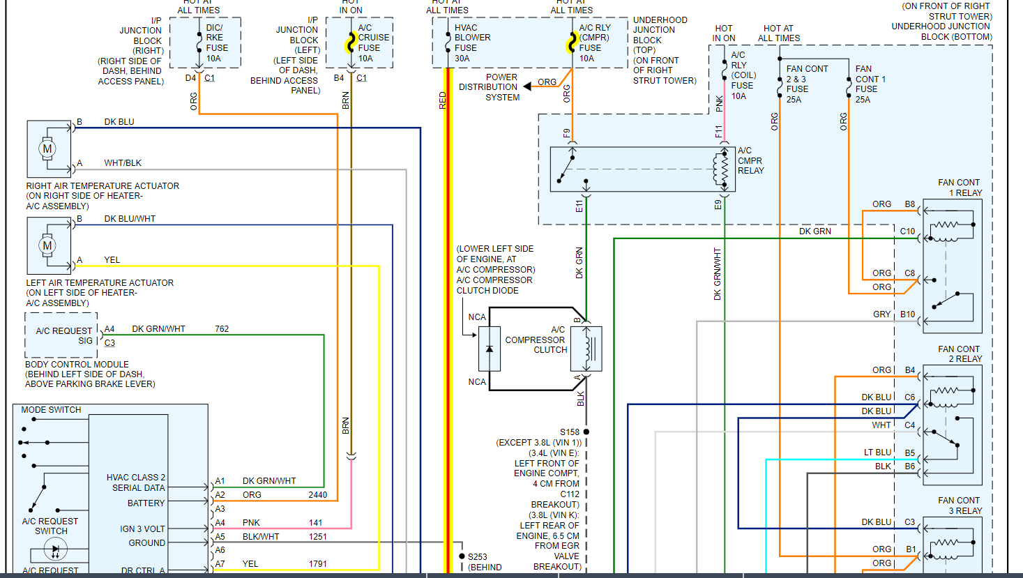

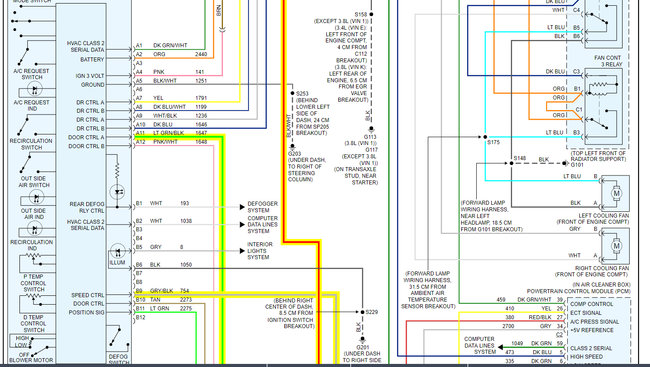

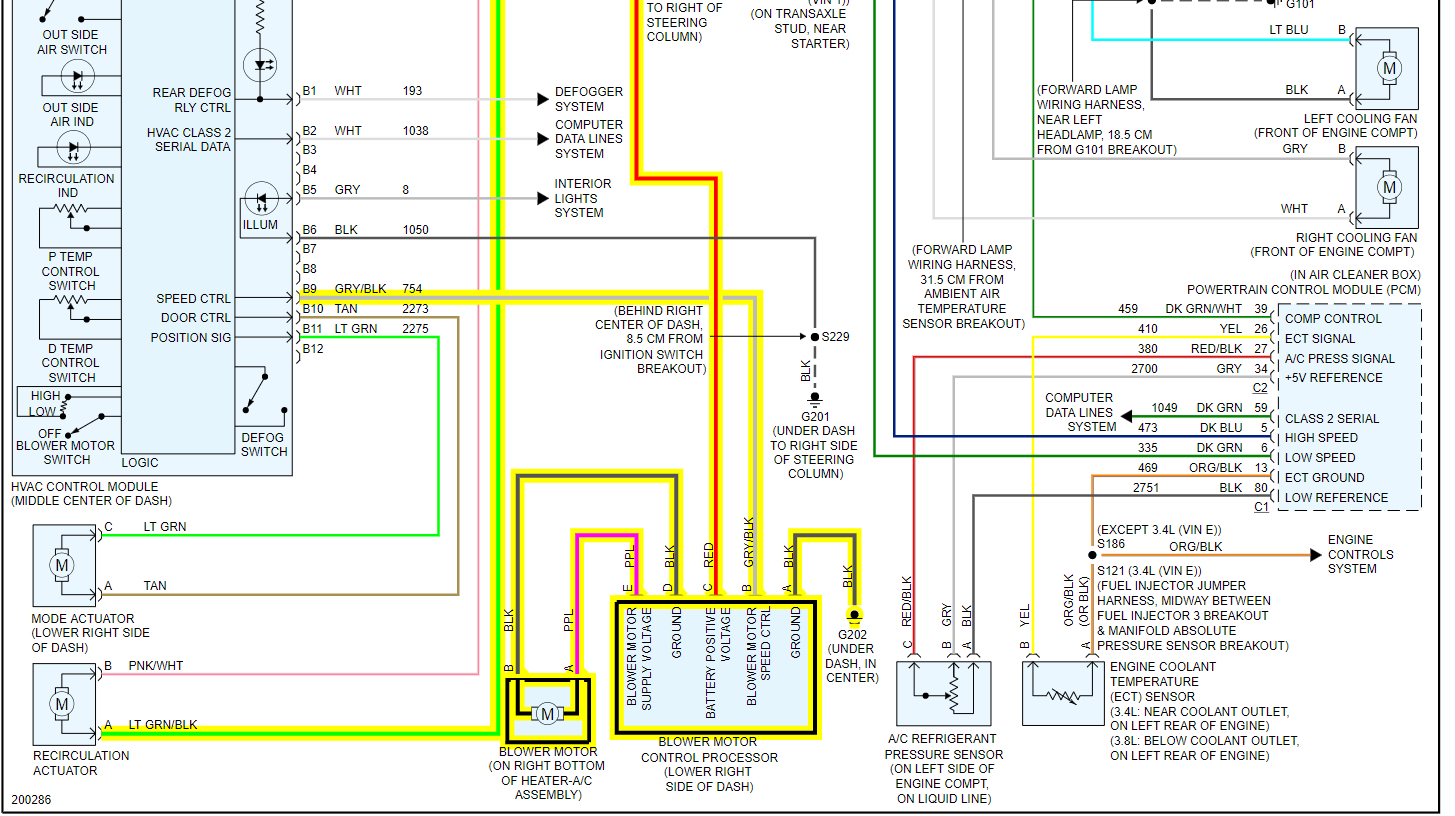

I attached a wiring diagram for you of the blower motor system. You need to check for voltage to the blower motor.
It could be either the blower motor or the resistor.
https://www.2carpros.com/articles/blower-fan-motor-works-on-high-speed-only
https://www.2carpros.com/articles/low-or-no-air-flow-from-vents

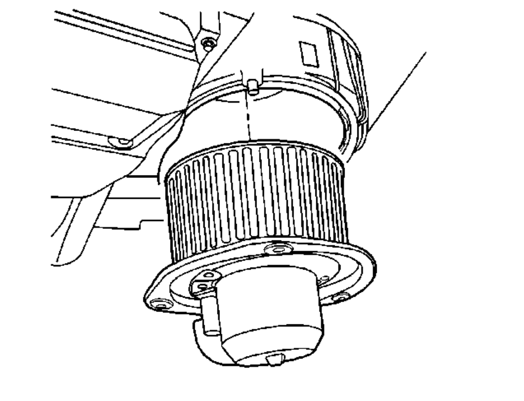

BLOWER MOTOR REPLACEMENT
REMOVAL PROCEDURE
1. Remove the right side instrument panel insulator.
2. Disconnect the blower motor electrical connector.
3. Remove the blower motor mounting screws.
4. Remove the blower motor.
