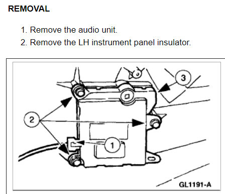

It sounds like you have a temperature blend door actuator that has gone bad. Here is a guide to show you what you are in for when doing the job:
Below is how it will be on your car.

Thanks for getting back to me. With your advice along with the videos I was able to switch out the actuator that is located behind the radio. I could not get the radio out as the left track would not function; I believe it was pushed out where the tool would not work. I was able to view the actuator from below the dash and was able to reach up and remove and replace the actuator. I now have heat...Thank You.

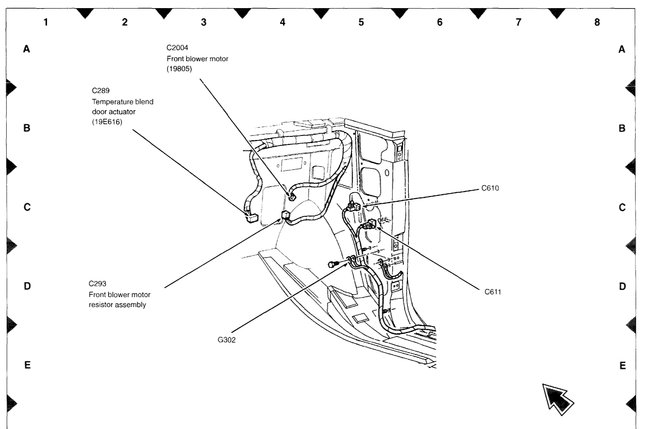

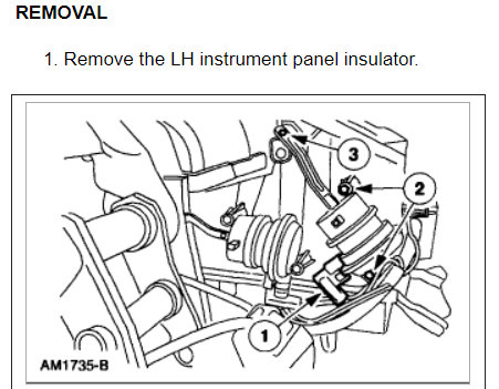

Now my second problem is with the vents. The dash vents are the only vents working; the defroster and the floor vents do not work.I know there is another actuator, I think, that controls the vents. I saw in your videos that vent actuator was located below the glove box. I looked behind the glove box and did not see another actuator in that area. Can you give advice as to where the vent actuator is located on my 2003 Windstar.
I saw what looks like a wiring diagram of what I think might be the diagram for where the 4 or 5 actuators are located but I could not follow the diagram as compared to my Windstar.

It sounds like the mode actuator is not working this actuator is vacuum operated so I would check the vacuum lines going from the HVAC system to the engine to make sure they are not leaking.
Here is a guide to help you see what I am talking about.
