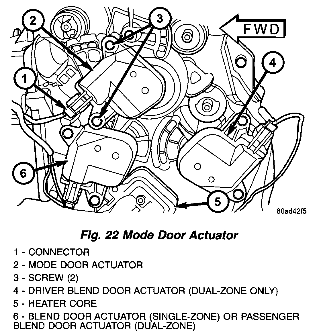

Recently came into ownership of the vehicle, been having issues with the heater. Thought the defrost/heat was just weak, but no matter what I set console it doesn't seem to change. Temperature can be adjusted, but the vents do not kick on. I replaced the fuse, resistor, and cabin air filter but have had 0 luck. Suggestions? An actuator possibly?

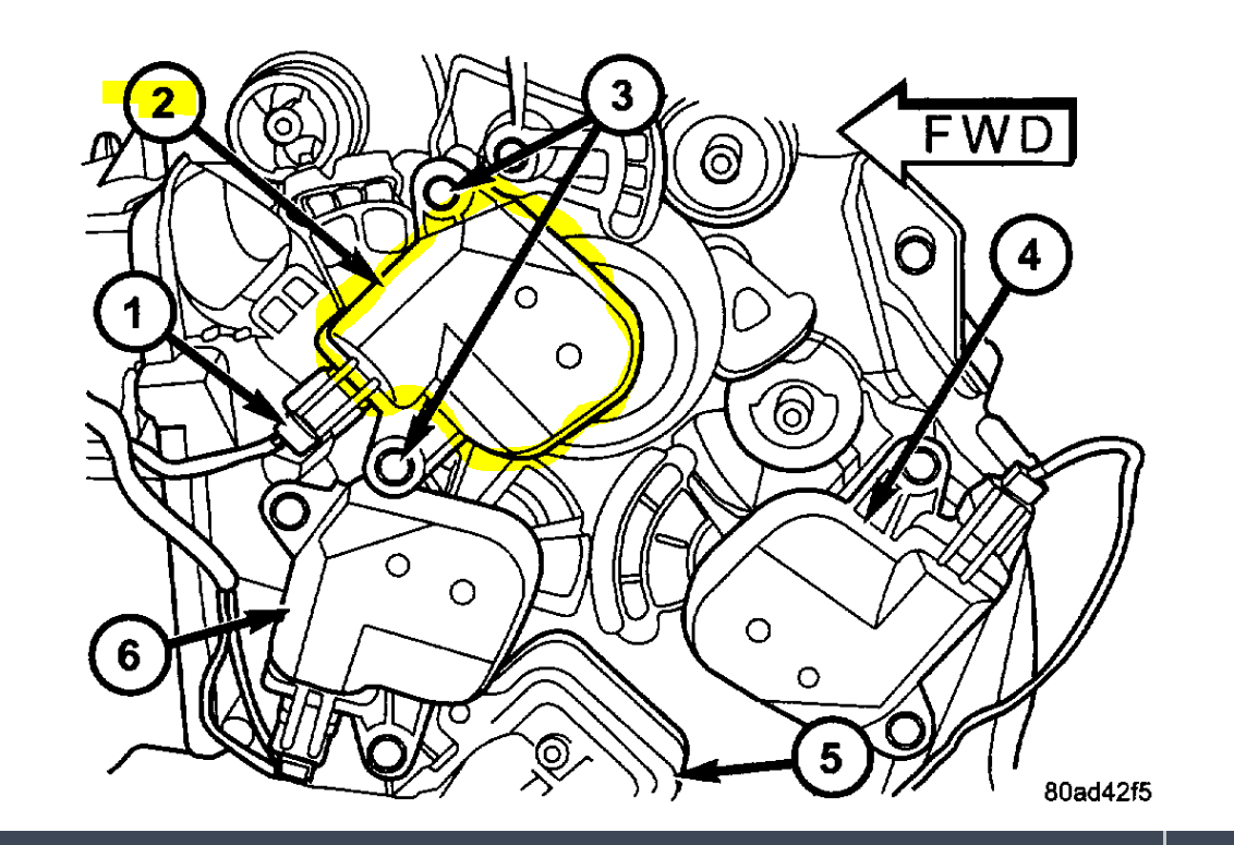

When the air flow directions doesn't change, it is usually related to what is called a mode door actuator. This actuator is what is responsible for changing the air flow direction.
Here are the directions for replacing it. Note: Before replacing, confirm it doesn't react when you change air flow direction. The two pics below correlate with the directions. In the first picture, I highlighted the mode door actuator, and yes, it's under the dash.

Fig.22 Mode Door Actuator
Pic 2
3. Disconnect the HVAC wire harness connector for the mode door actuator from the actuator connector receptacle.
4. Remove the two screws that secure the mode door actuator to the distribution housing.
5. Remove the mode door actuator from the distribution housing.
