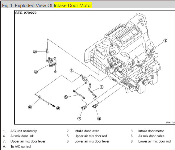

The heat in the vehicle works, except I cannot get heat to blow out of the defrost vents. Everywhere else works.
Dec 8, 2018 at 12:07 PM
DANNY L
  • 5,648 POSTS
Hello, I am Danny,
It sounds the the mode/blend door actuator is giving you problems. It is located on the HVAC box under the dash. I have attached a tutorial for you to view on what is involved to replace as well I have attached a picture of what it looks like/location. Feel free to ask any questions if needed. Hope this helps and thanks for using 2CarPros.
