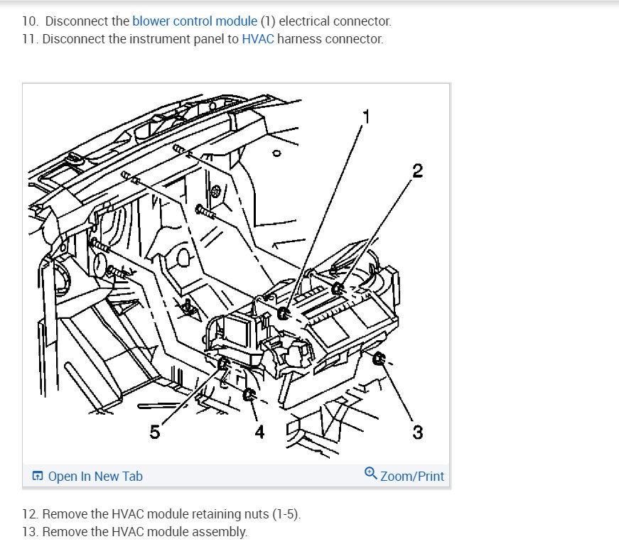

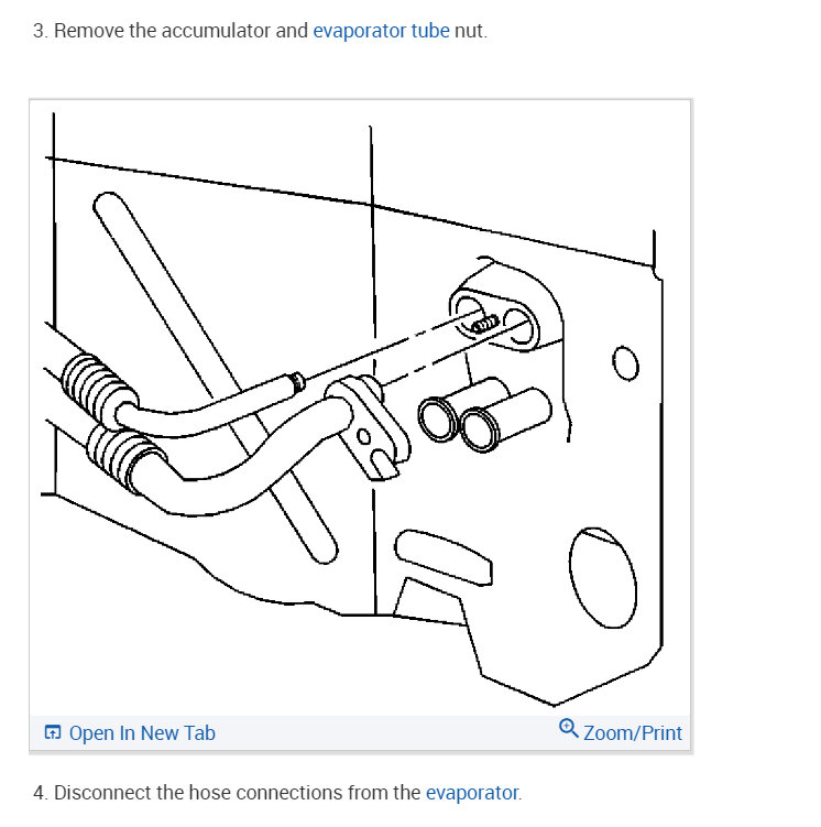

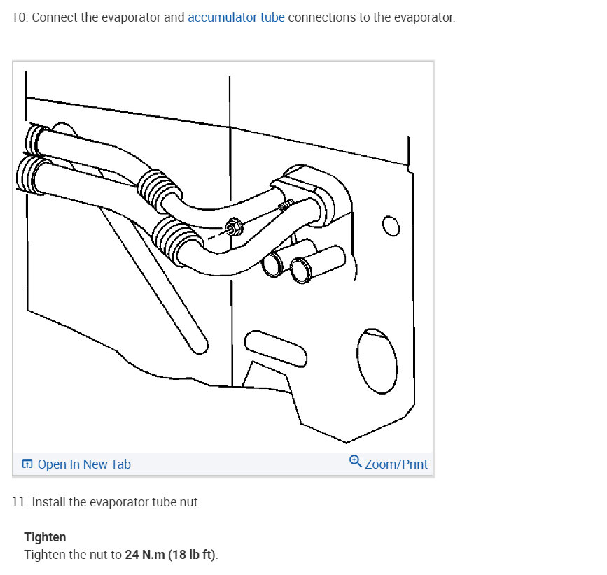

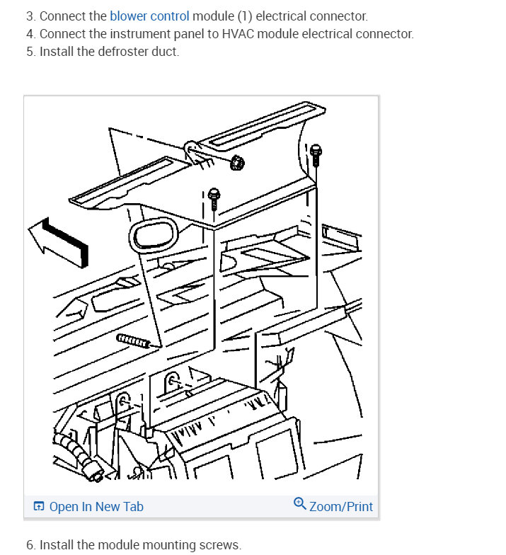

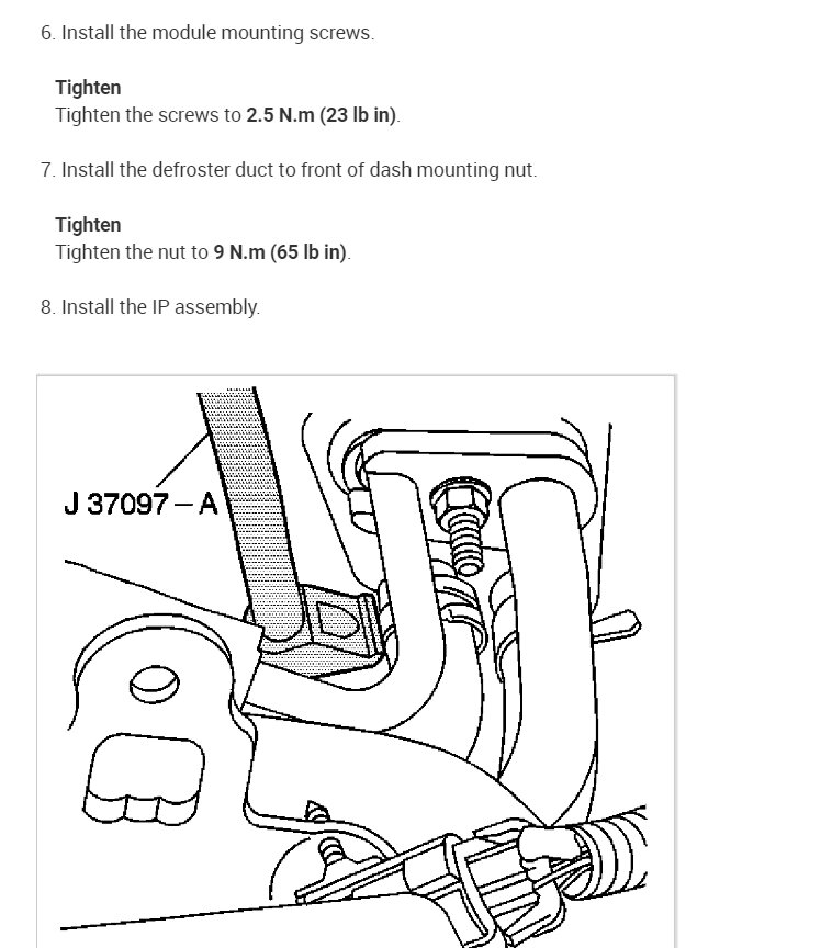

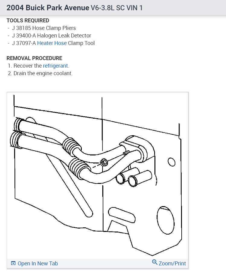

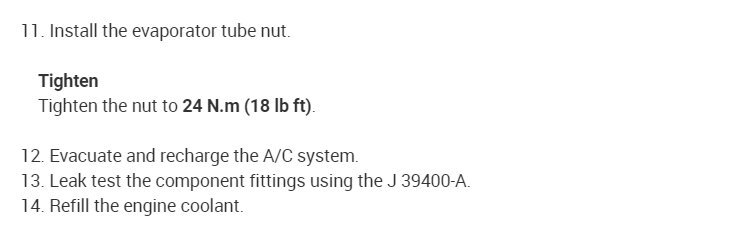

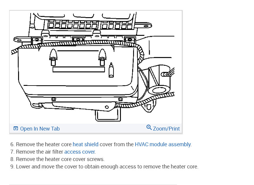

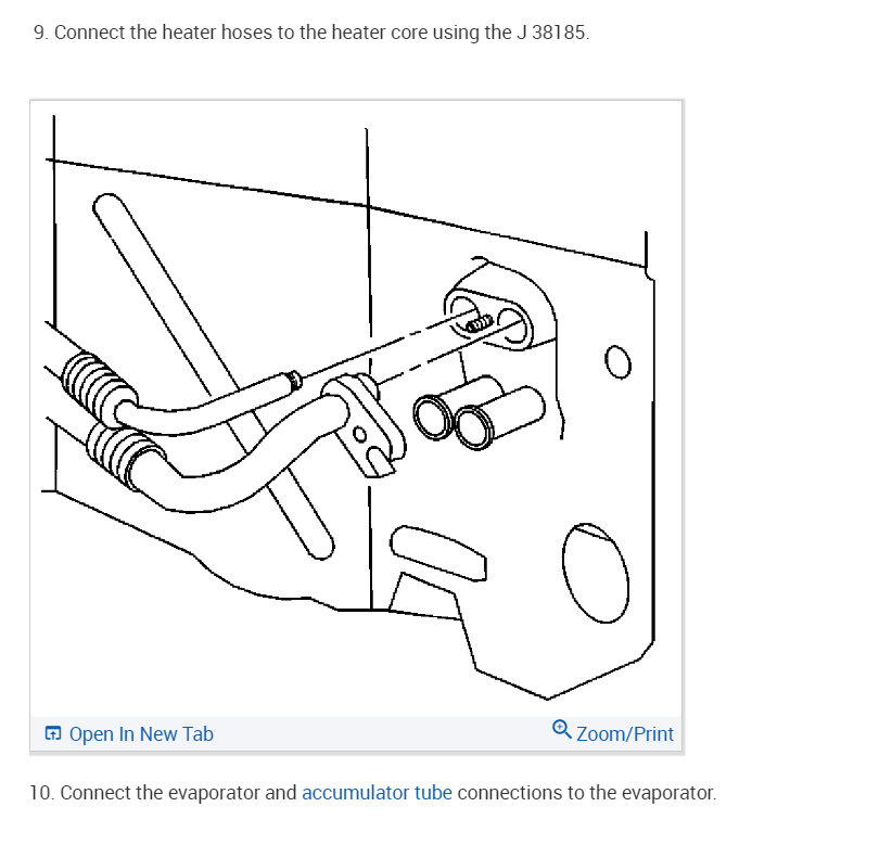

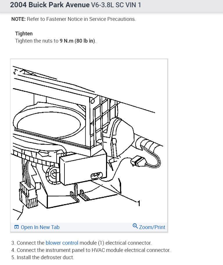

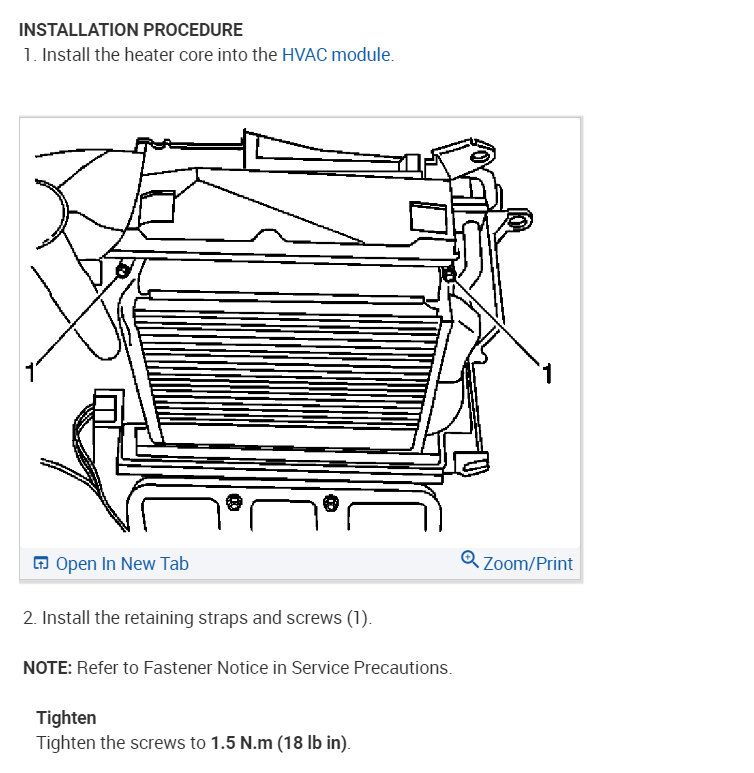

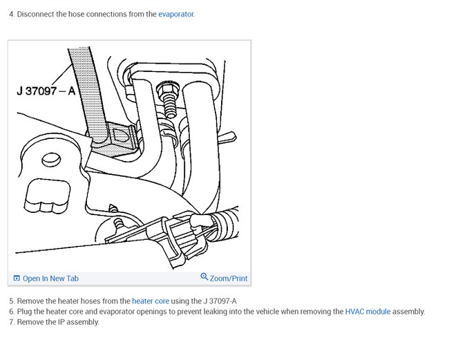

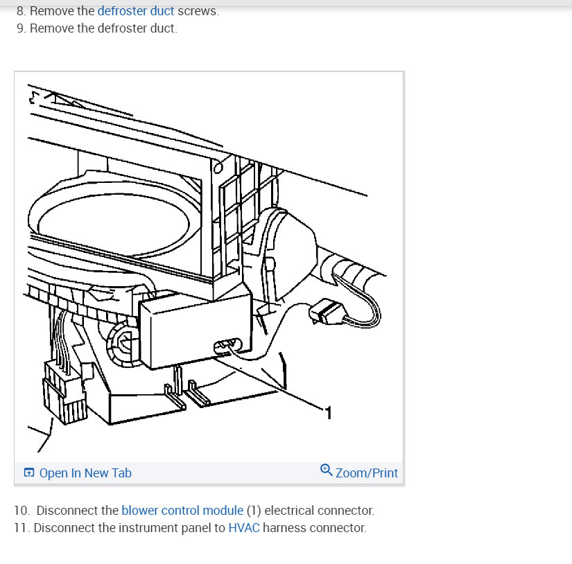

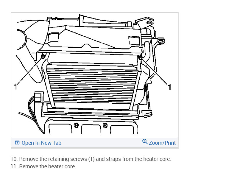

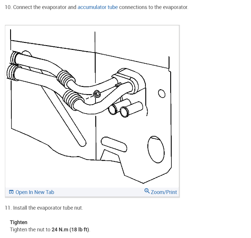

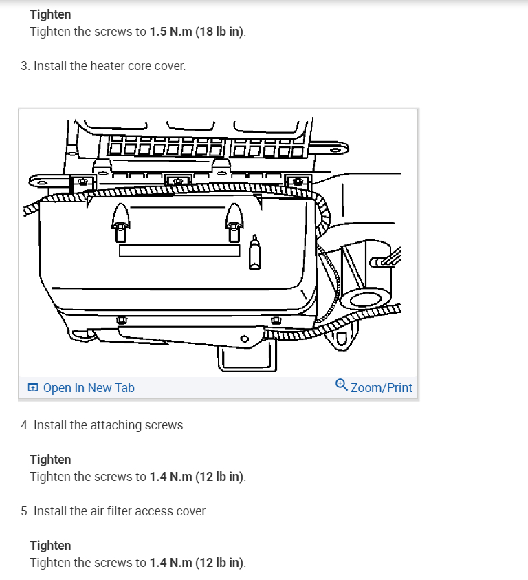

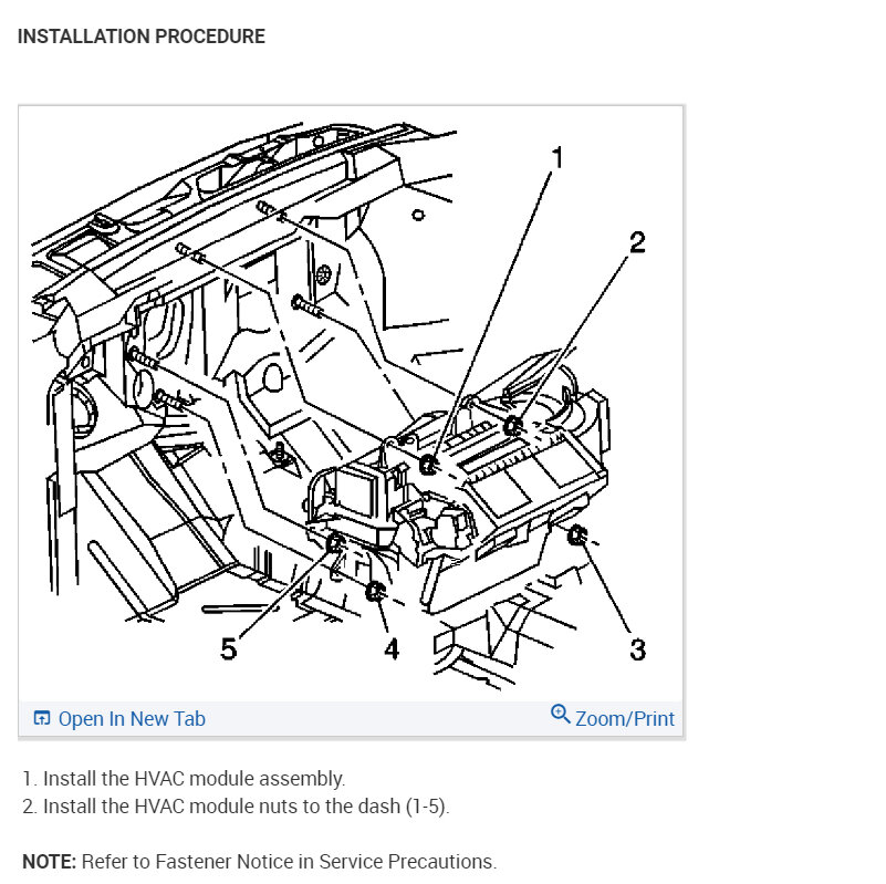

Installed new core but having trouble putting dash components back together. I think I need a diagram.
May 15, 2023 at 4:21 PM
  • 55,721 POSTS
Sure, here are the diagrams to help you reinstall the heater core. Check out the images (below). Let us know what happens and please upload pictures or videos of the problem so we can see what's going on.
