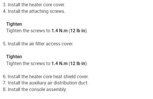

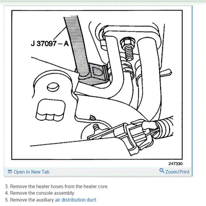

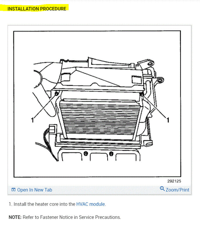

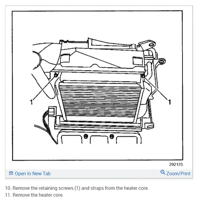

I need the steps and level of difficulty of replacing a heater core. Is this something that can be done without having to disassemble a lot of parts in this car?
Mar 9, 2022 at 7:06 AM
  • 110,248 POSTS

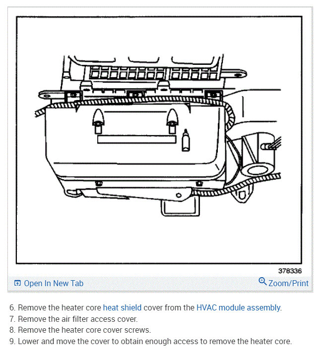

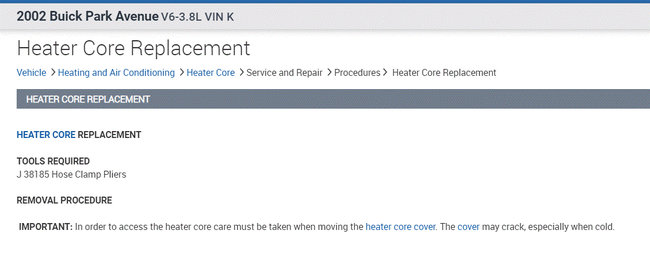

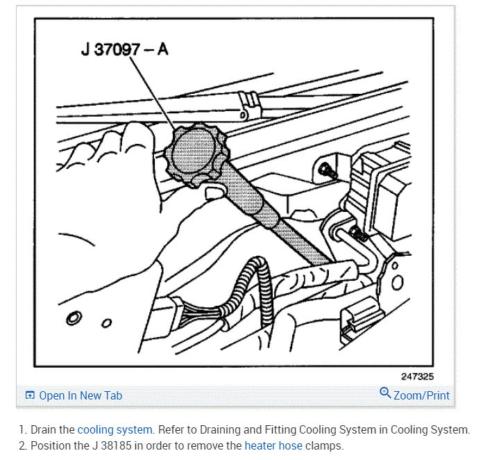

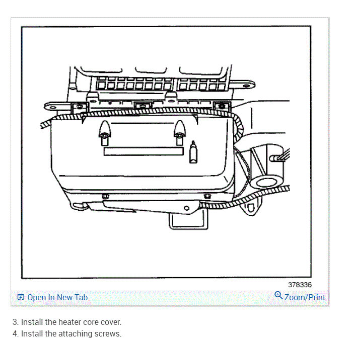

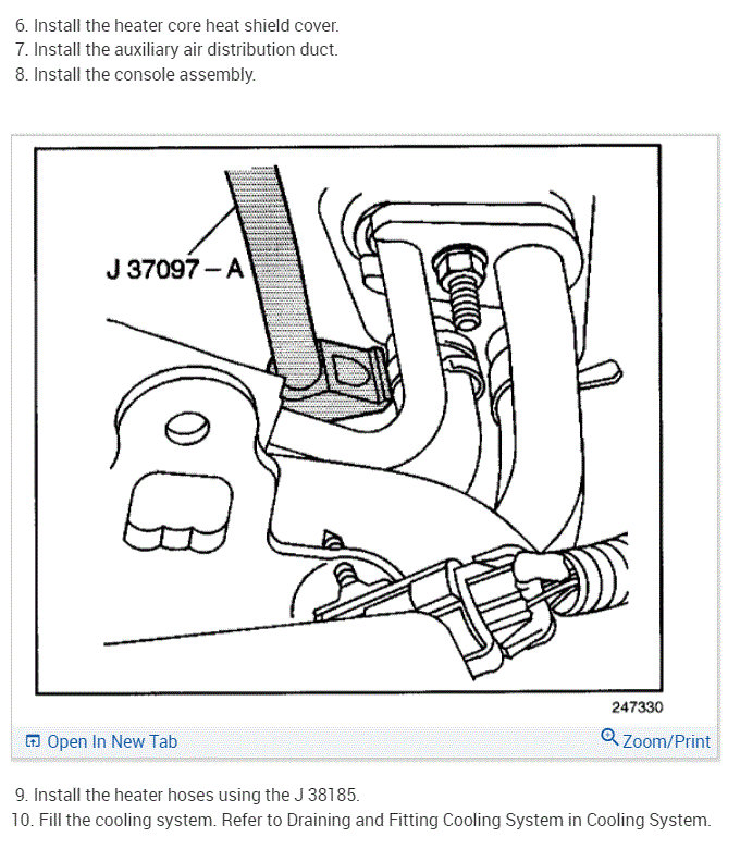

Replacement isn't as bad as some, but it does take a little time. To get you started, here is a link that explains in general how it's done.
https://www.2carpros.com/articles/replace-heater-core
If you look below, I attached the directions specific to this vehicle.
Mar 9, 2022 at 8:05 AM
