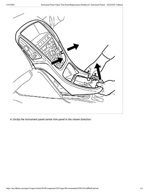

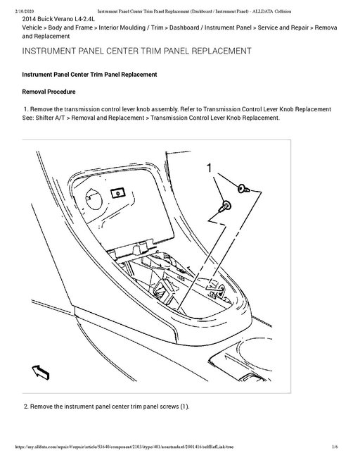

I want to know the location of my heater core and what all i need to take out in order to access it. My coolant is leaking too bad so I can no longer ignore this problem. Ive seen different cars require different steps and I do not want to take apart something if I do not need to. Thank you, Genesis
Feb 9, 2020 at 2:27 PM
JOETECHPRO
  • 705 POSTS
Hey THAT_OCHO,

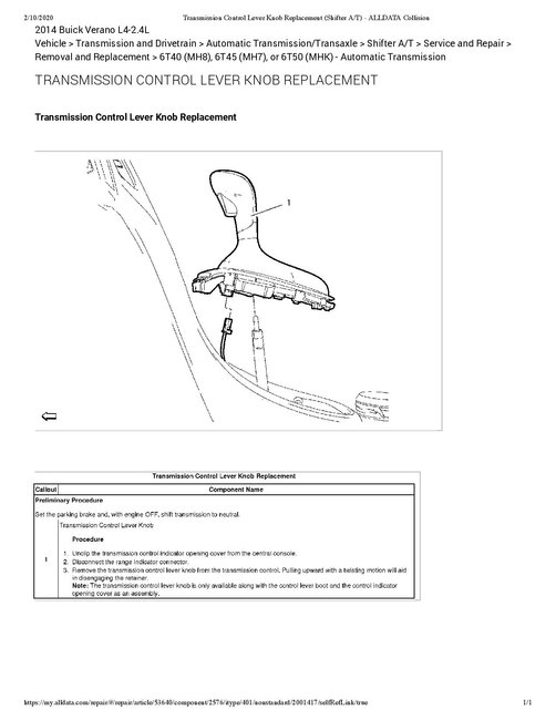

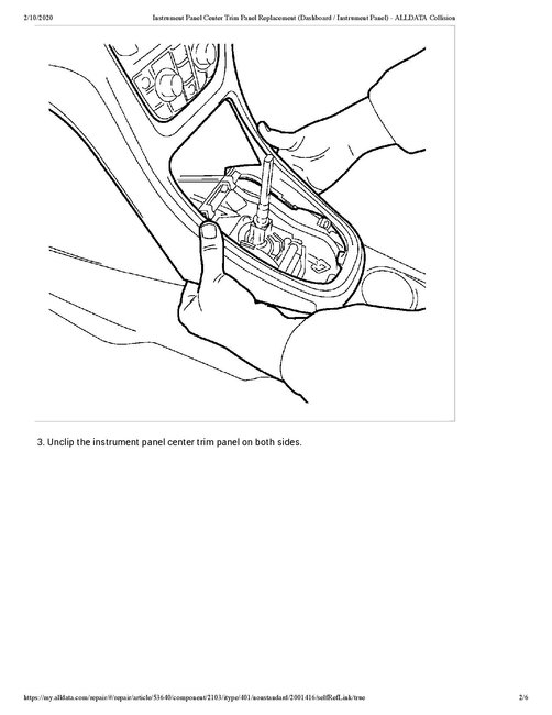

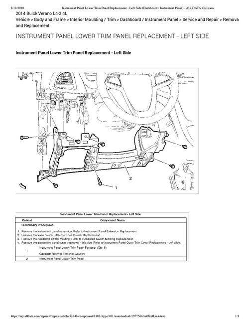

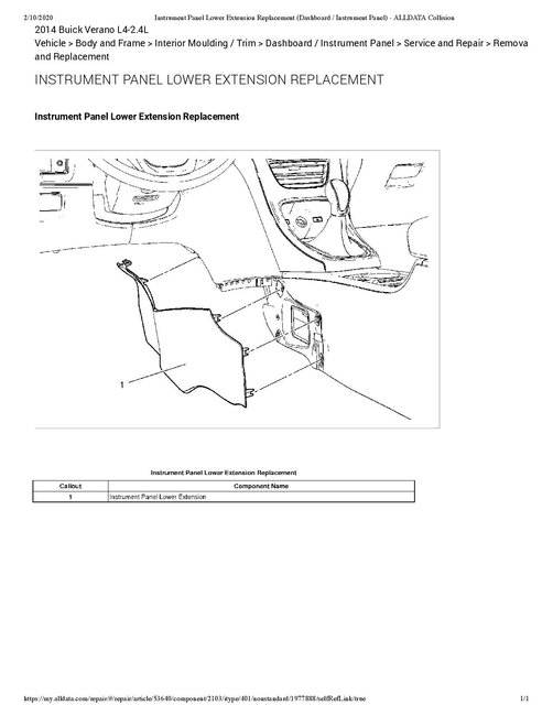

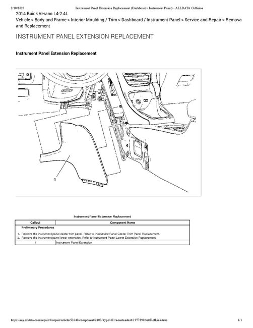

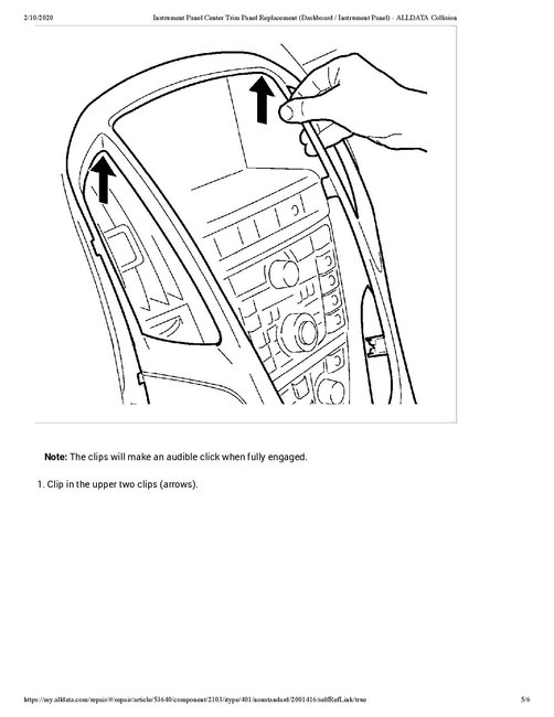

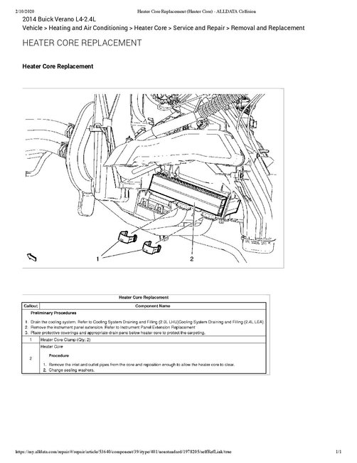

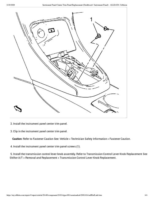

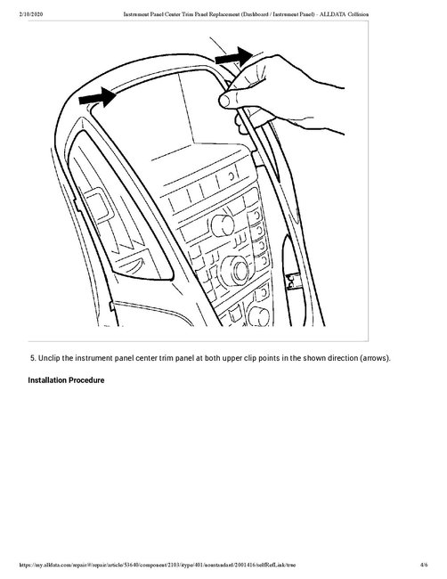

I have attached below the necessary instructions to replace the heater core.
You have to first remove the transmission control lever and same trims on the left side of the center console.
All of the instructions for the preliminary tasks are attached also.
Let me know if you have any further questions.
Regards, Joe
