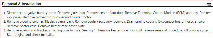

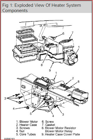

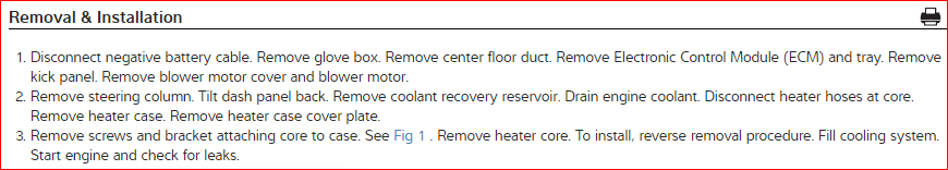

Heater does not work and water drips in floorboard.
Sep 10, 2018 at 4:51 AM
DANNY L
  • 5,648 POSTS
Hello, I am Danny.
Sounds like your heater core is leaking. I have attached a picture and how to remove steps. I have also attached a tutorial showing what is involved. Hope this helps and feel free to ask any other questions. Thanks for using 2CarPros.
Danny-
https://www.2carpros.com/articles/replace-heater-core
