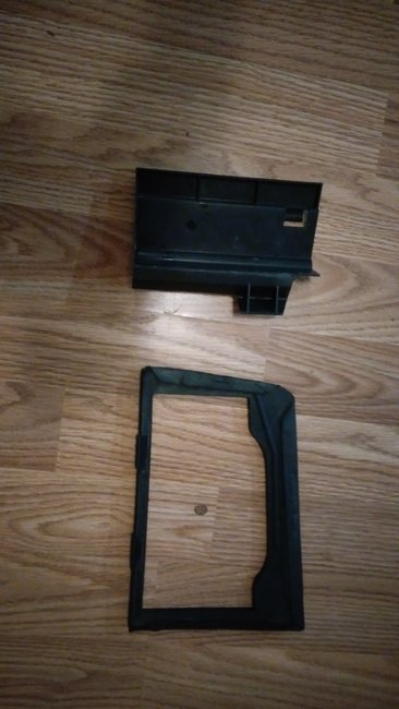

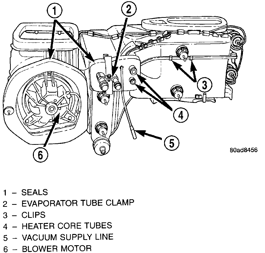

Me and a buddy took the box with the heater core in it out of the Jeep but I didn't watch him split the box. there's two plastic pieces that came out of it and neither of us knows where they go. I have a picture of the parts thanks for any help you can offer.

I need to know if this is a Cherokee or a Grand Cherokee. Also, do you have the pictures of the parts? I didn't receive them with your post. I attached three different pictures of the HVAC heater/AC box. I don't know if it helps, but it's for the Cherokee and not the Grand Cherokee.
Let me know if this helps or if you have other questions. Also, if you have pics of the two parts left over, it will help.

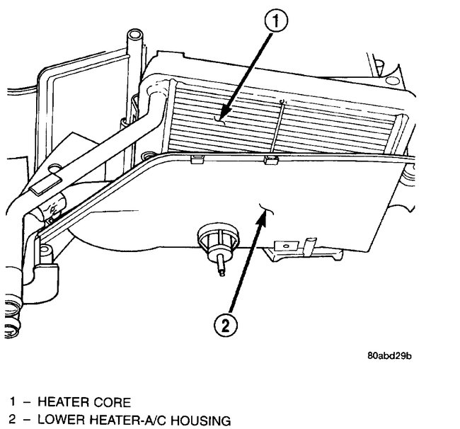

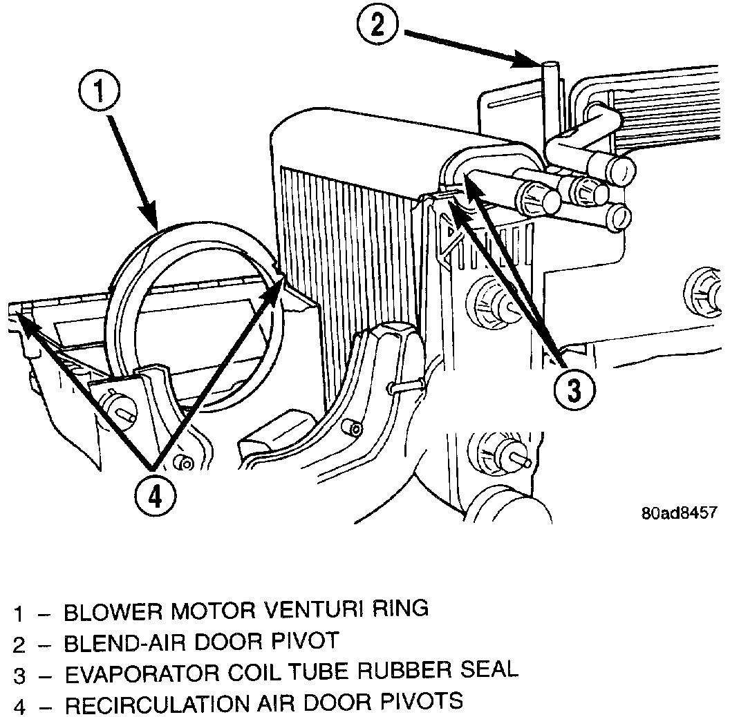

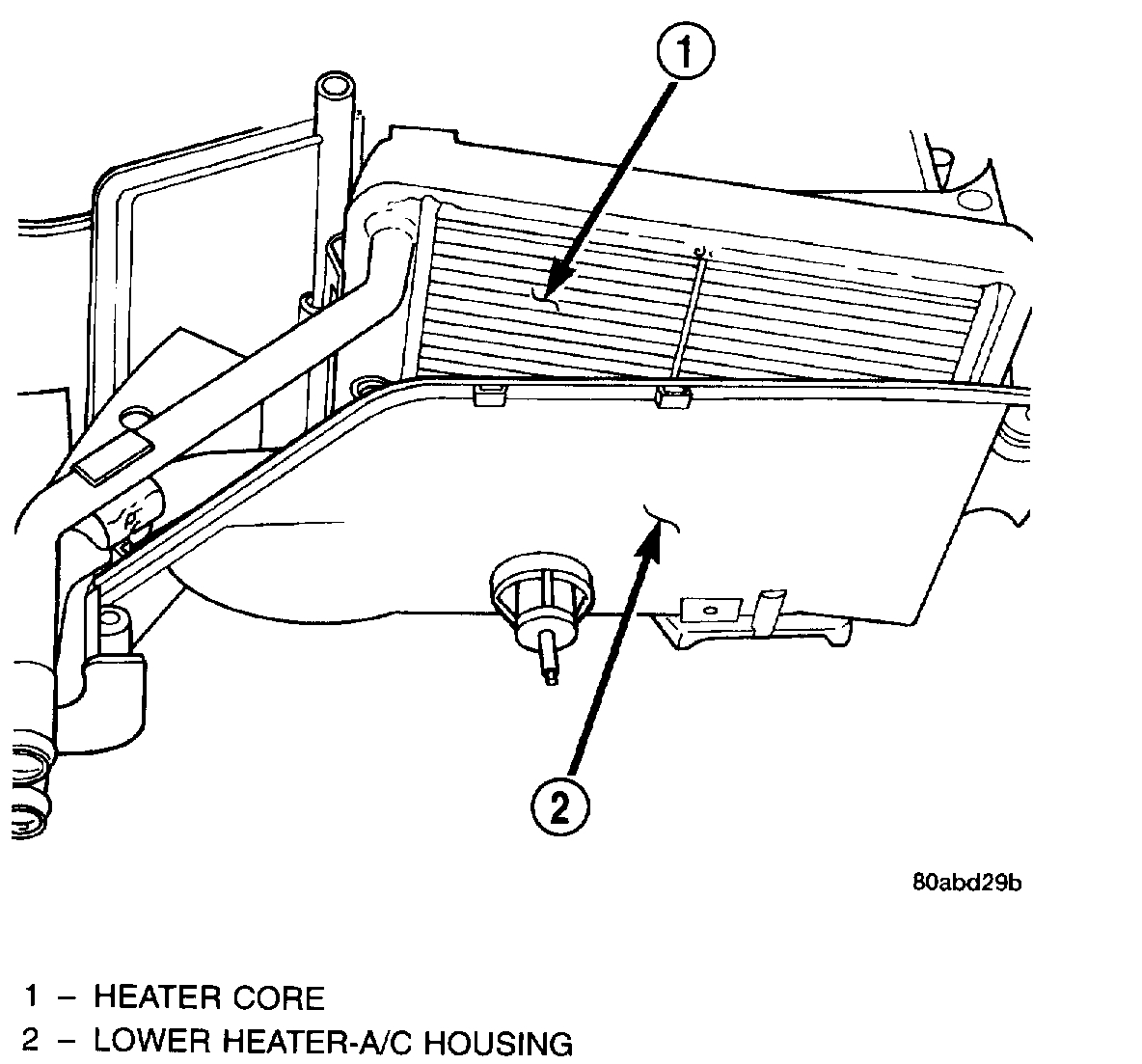

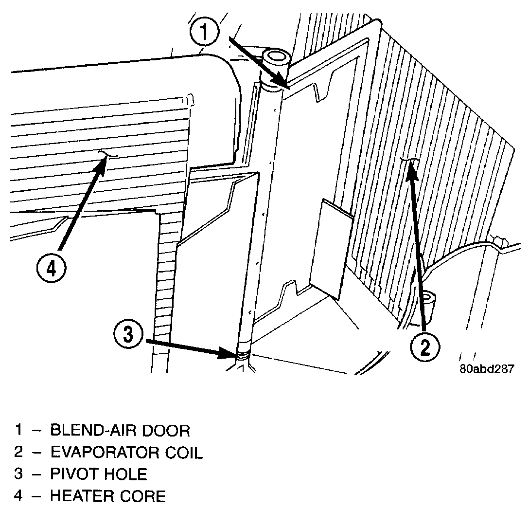

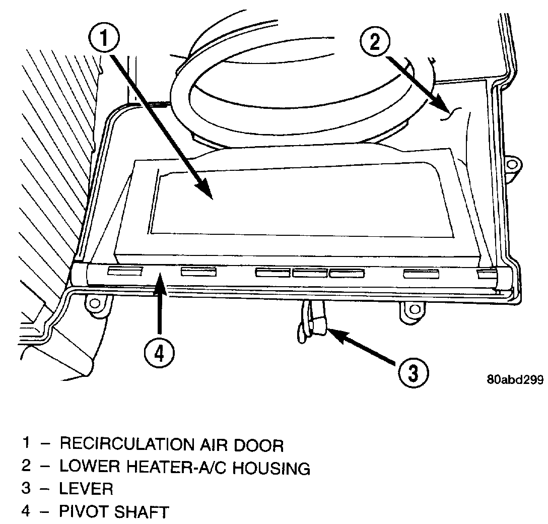

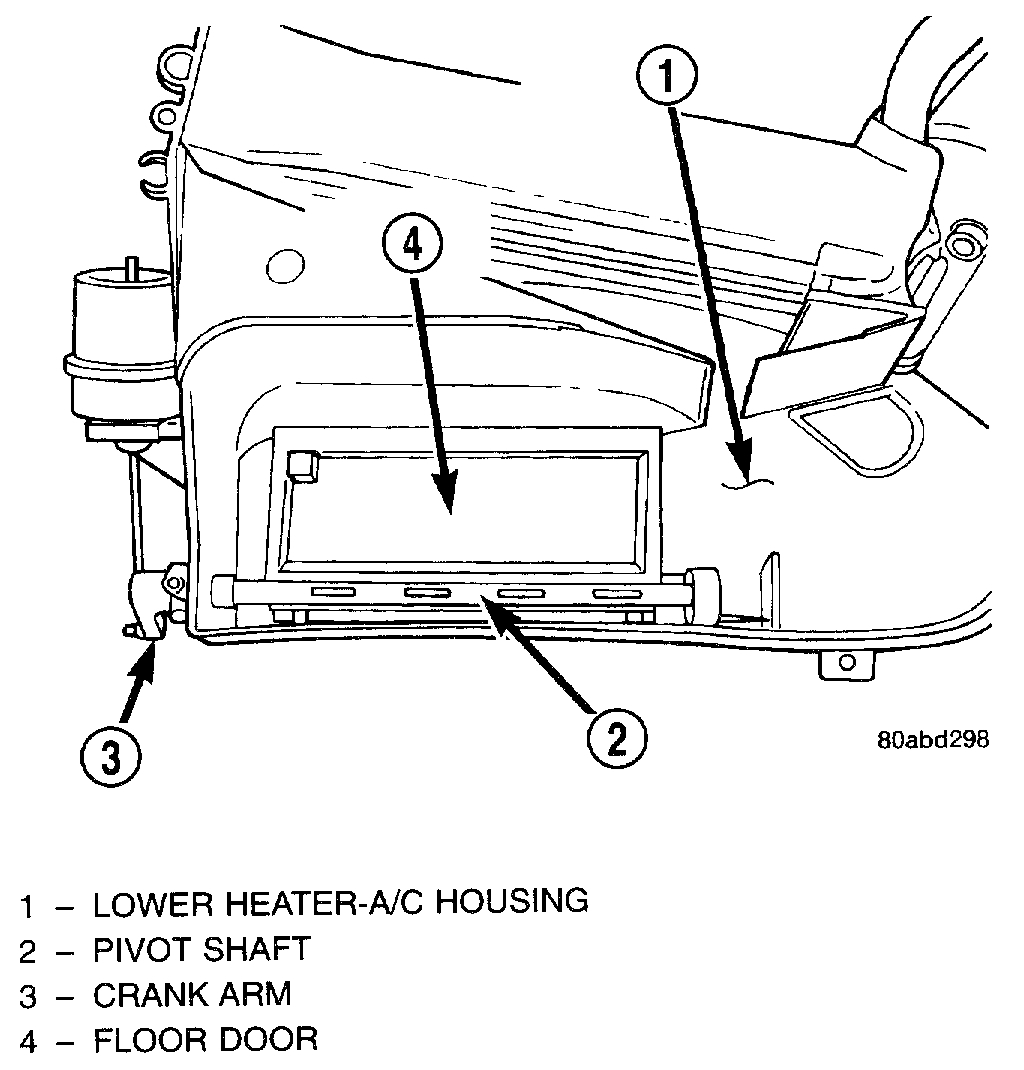

It looks line the AC/Heater blend door and bezel. Take a look through these directions and see if they seem to correlate. The attached pictures are related to the directions,
HEATER-A/C HOUSING DOOR REPLACEMENT
WARNING: On vehicles equipped with airbags, refer to Airbag Systems Safety Information and Procedures. Before attempting any steering wheel, steering column, or instrument panel component diagnosis or service. Failure to take the proper precautions could result in accidental airbag deployment and possible personal injury. See: Air Bag Systems > Technician Safety Information
BLEND-AIR DOOR
1. Remove and disassemble the heater-A/C housing. Refer to: Heating and Air Conditioning, Housing Assembly HVAC, Service and Repair,
Blend-Air Door
2. Lift the blend-air door pivot shaft out of the pivot hole in the bottom of the lower half of the heater-A/C housing.
3. Reverse the removal procedures to install

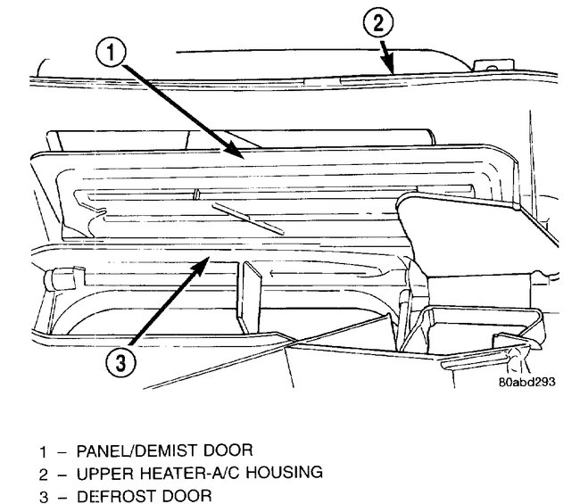

PANEL/DEMIST DOOR AND LEVER
2. Remove the defrost and panel/demist door vacuum actuators from the heater-A/C housing.
Mode Door Lever Remove/Install - Typical

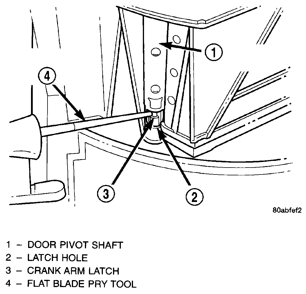

3. Insert a screwdriver into the latch hole of the panel/demist door pivot shaft to release the latch of the panel/demist door lever and pull the lever out of the pivot shaft from the outside of the upper half of the heater-A/C housing.
Panel/Demist And Defrost Doors
4. Reach inside the upper half of the heater-A/C housing and carefully flex the panel/defrost door enough so that the door pivot clears the pivot hole in the housing.
5. Remove the panel/demist door from the heater-A/C housing.
6. Reverse the removal procedures to install.

3. Insert a screwdriver into the latch hole of the defrost door pivot shaft to release the latch of the defrost door lever, and pull the lever out of the pivot shaft from the outside of the upper half of the heater-A/C housing.

FLOOR DOOR AND LEVER
2..Remove the floor door vacuum actuator from the lower heater-A/C housing.
3. Insert a screwdriver into the latch hole of the floor door pivot shaft to release the latch of the floor door lever, and pull the lever out of the pivot shaft from the outside of the lower half of the heater-A/C housing.
Floor Door
4. Reach inside the lower half of the heater-A/C housing and carefully flex the floor door.
5. Remove the floor door from the heater-A/C housing.
RECIRCULATION AIR DOOR
A recirculation air door and vacuum actuator are used only on models with the optional air conditioning system.
2. Remove the recirculation air door vacuum actuator from the lower heater-A/C housing
Recirculation Air Door
3. Reach inside the lower half of the heater-A/C housing and lift the bottom edge of the recirculation air door upwards.
4. Guide the recirculation air door lever through the air intake grille of the heater-A/C housing while removing the door from the housing.
5. Reverse the removal procedures to install.

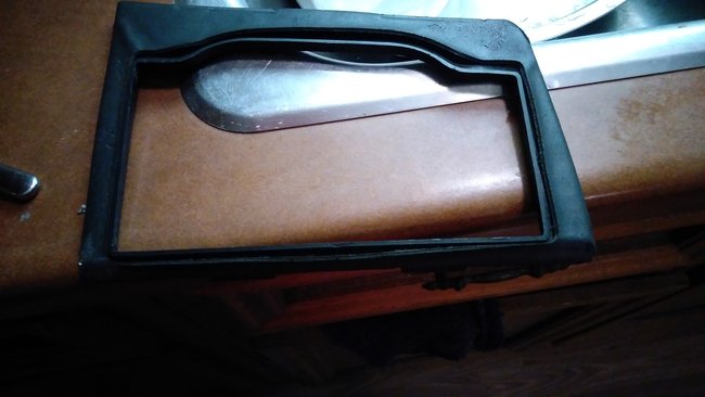

Still can't figure out where this piece goes.

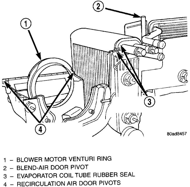

Is that a hard plastic or more like a gasket? Take a look at the attached picture. Could it belong at the top of the blower motor side as a gasket? Also, on the right side, I believe there is a rubber gasket type component that goes between the two cases to prevent air leaks.
Let me know. If what I just said doesn't make sense, attache another picture of the component flipped over.
