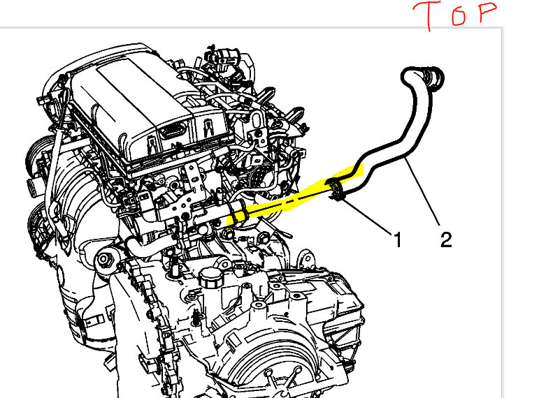

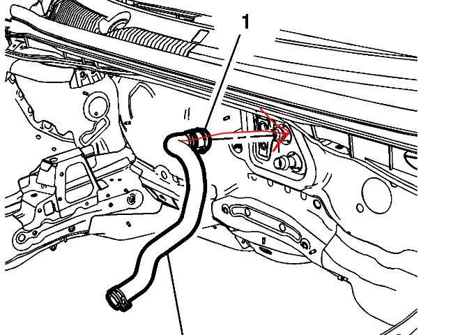

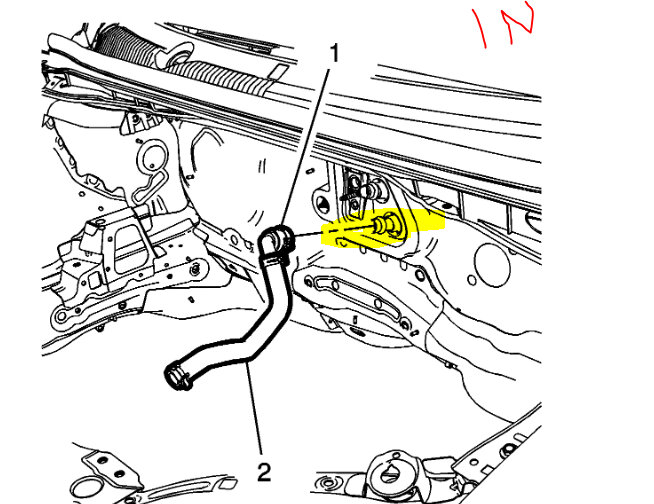

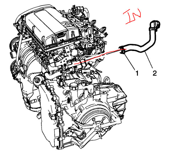

I replaced thermostat housing and can’t remember which hose on heater core goes where on housing.
Aug 18, 2024 at 4:50 AM
  • 110,244 POSTS
They don't make a schematic, so I had to. LOL There are two hoses. One is a supply (inlet) and the other is a return (outlet).
If you look below, the first two pics are for the outlet. Pics 3 and 4 show the inlet.
Let me know if this helps.

So, the bottom port of the heater core goes to the top of thermostat port and the top of heater core port goes to bottom of the thermostat port.
Aug 18, 2024 at 10:36 PM
  • 110,244 POSTS
Based on what I'm seeing in the manual, you are correct.
Let me know how things work out for you or if you have other questions.
