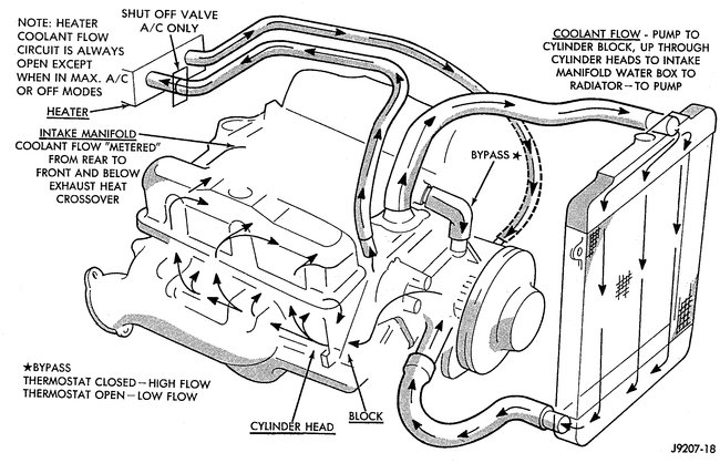

Trying to find out which hose goes on which pipe. Everything I find has heater core nipples top and bottom on my van its left and right so not sure which is inlet and outlet.

Not a problem. If you look at the attached picture, it shows coolant flow through the heater core. The left side is supply and right is the return.
Let me know if this helps.

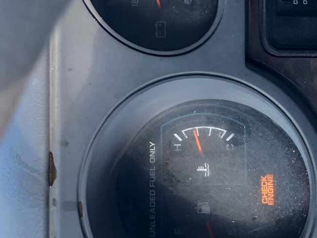

I have a 97 dodge van 2500 and it keeps getting hot. I have put a new fan clutch a new heater core a new thermostat. It’s not losing water I can see water circulating in radiator and there is no water in oil or oil in water. I’m at a lose as to what is causing it and what else to someone please help. This is a photo of temp gauge at about 70 mph on interstate

Since you replaced all of that, I have to ask if you flushed the cooling system, both the radiator and engine block? Is the belt turning the water pump tights? How hot does it get when driving in town or stop and go traffic? Also, check to make sure there is nothing preventing full air flow through the radiator such as dirt. If the cooling fins on the radiator seem plugged, spray them clean with water.
If you haven't flushed the cooling system, there could be a partial blockage in the radiator or block. I would suggest doing it. Here is a link that shows how it is done.

No I haven’t flushed it since I replaced almost everything and it gets hotter when driving at higher speeds when driving around town it doesn’t get to hot

Try flushing the system. Follow the link I added. Honestly, since it is worse at highway speeds, something is most likely restricting flow. Also, make sure nothing is blocking air from going through the radiator.

Nothing blocking airflow at all checked and blew out radiator and ac coils just to make sure. Gonna tru to find a different link that I don’t have to pay for
