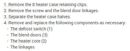

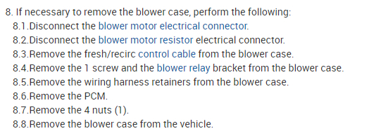

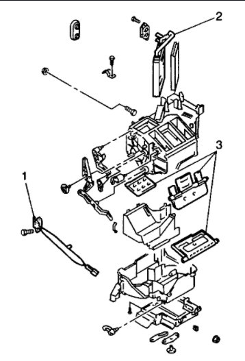

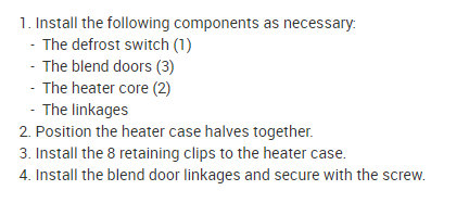

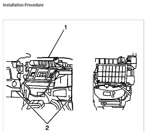

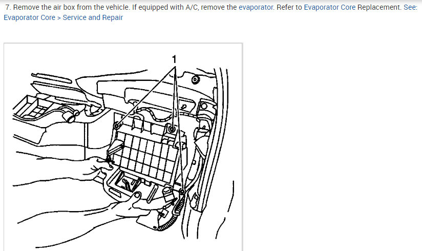

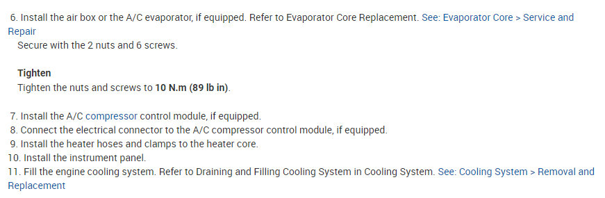

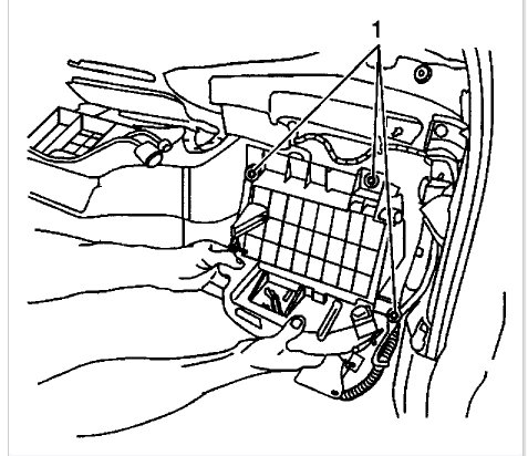

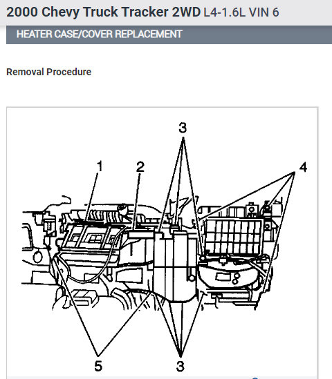

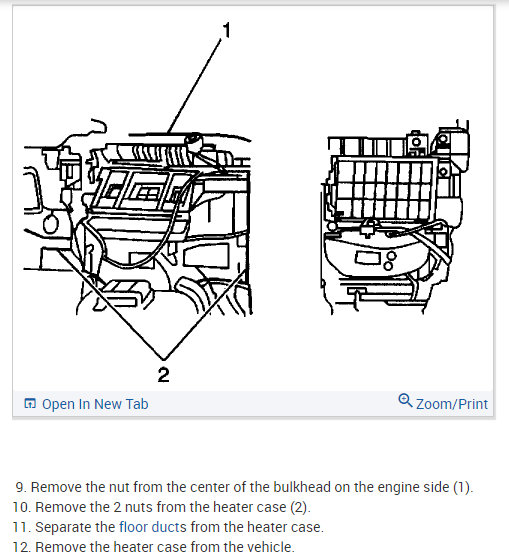

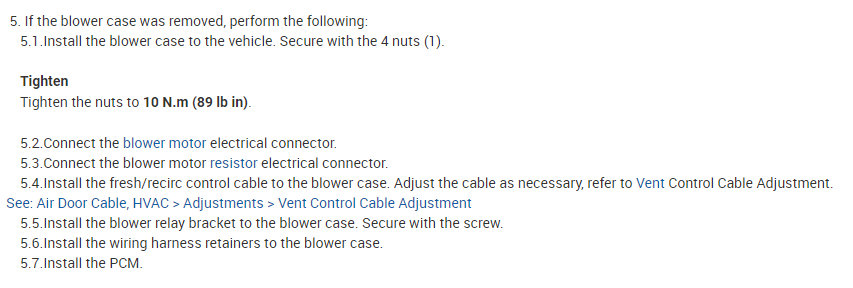

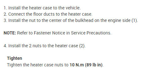

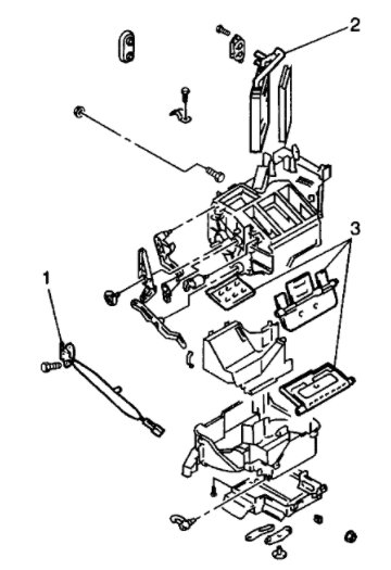

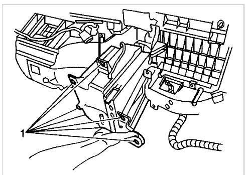

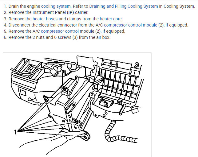

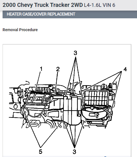

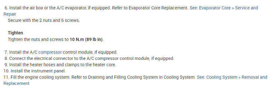

steps needed to remove heater core.
Aug 21, 2021 at 11:52 AM
DANNY L
  • 5,648 POSTS
Hello, I'm Danny.
You will first need to remove coolant from the system before removal of the heater core. Here is a tutorial showing how to drain, flush, and refill the engines coolant:
https://www.2carpros.com/articles/coolant-flush-and-refill-all-cars
Here is a tutorial showing how to remove and replace a heater core:
https://www.2carpros.com/articles/replace-heater-core
I've attached picture steps below on how to replace the heater core on your Tracker. Hope this helps and thanks for using 2CarPros.
