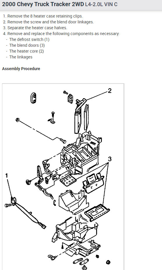

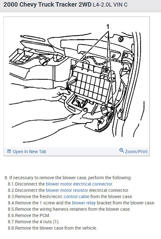

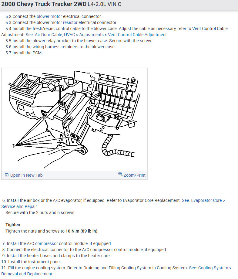

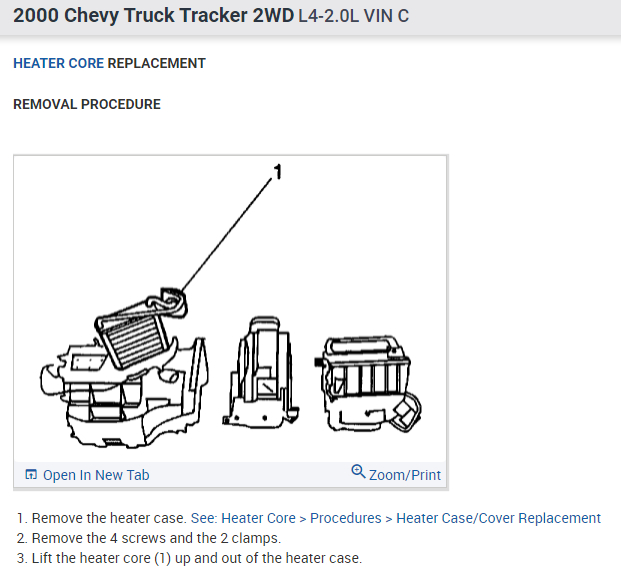

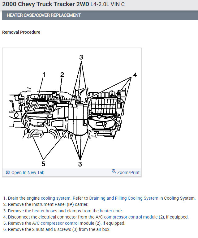

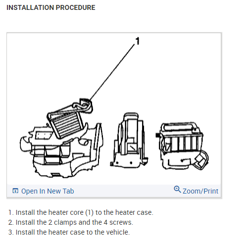

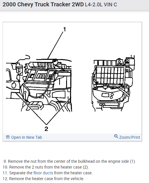

details to remove heater core.
Aug 21, 2021 at 11:44 AM
SQM
  • 6,383 POSTS

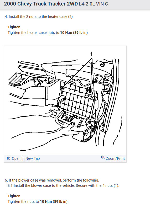

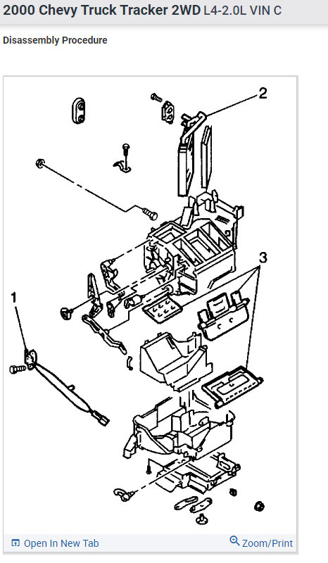

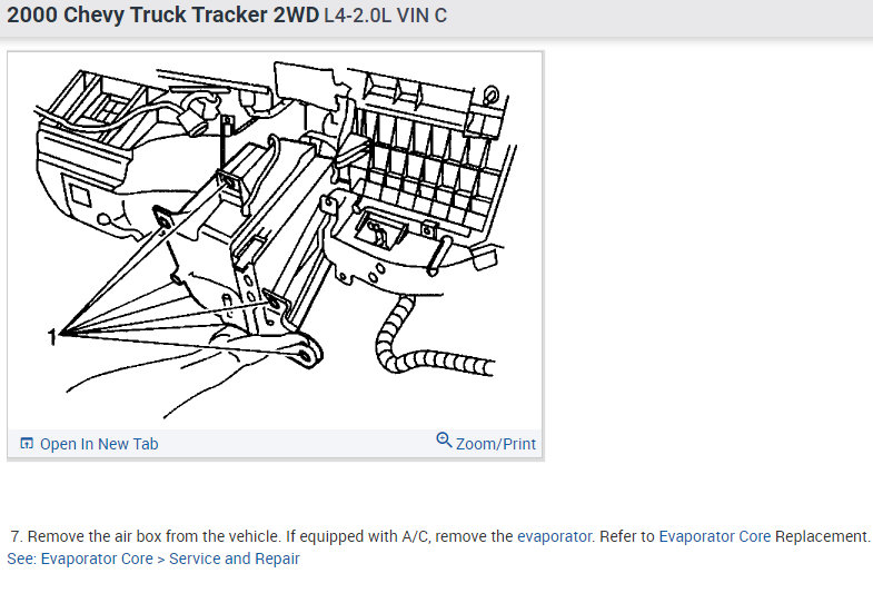

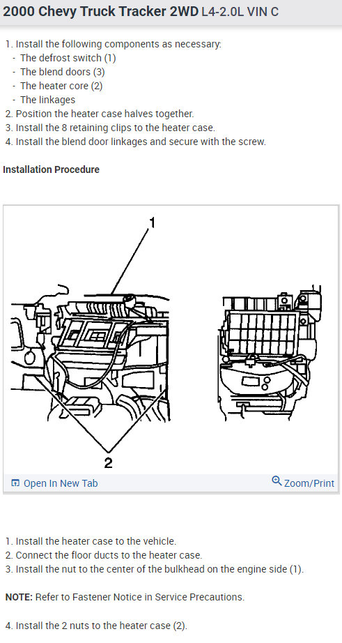

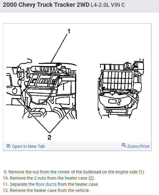

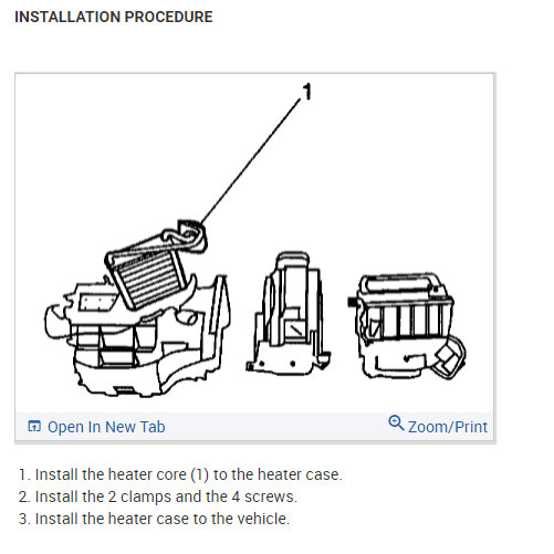

I have attached the heater core replacement procedure for your reference.
Remember to drain the coolant before getting started and always work on the cooling system when the engine is cold.
This guide might be helpful:
https://www.2carpros.com/articles/replace-heater-core
