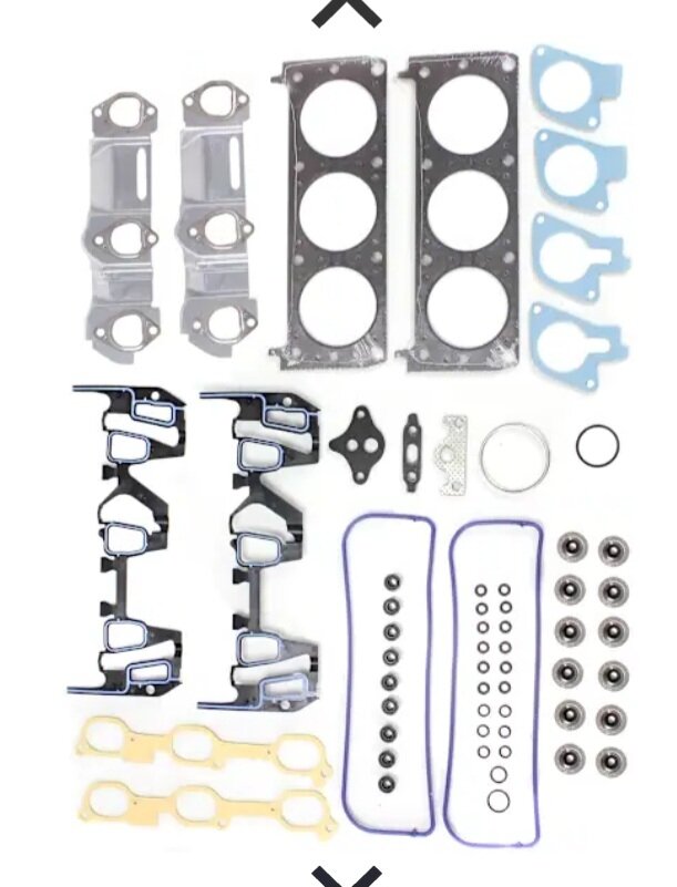

Well you were right, head gasket is blown. Builds pressure was too quick, bubbles in the coolant, you were right on. It's crazy the side effects I mean it blew out the radiator and cracked the lower intake and etc. But I am doing the head gaskets now luckily, they are not cracked or warped themselves truthfully. But I ordered this head gasket set from carparts.com it was only $49.99 so score! But anyway, it came with a few gaskets and o-rings and these 10 plastic things I'm not sure what exactly they are. Can you possibly help me identify the different parts in the set and what they might go to? I mean I know the ones for the heads, the upper and lower intake manifold and the EGR valve, the throttle body, thermostat, but not sure about the rest of these.
Apr 2, 2025 at 6:03 AM
STEVE W.
  • 15,346 POSTS
Most head gasket sets include the valve stem seals (look like O-rings) they will have things like thermostat housings, water pump, exhaust manifold gaskets, crossover tube gaskets. Some of them you won't use unless you strip the head down and rebuild it.
