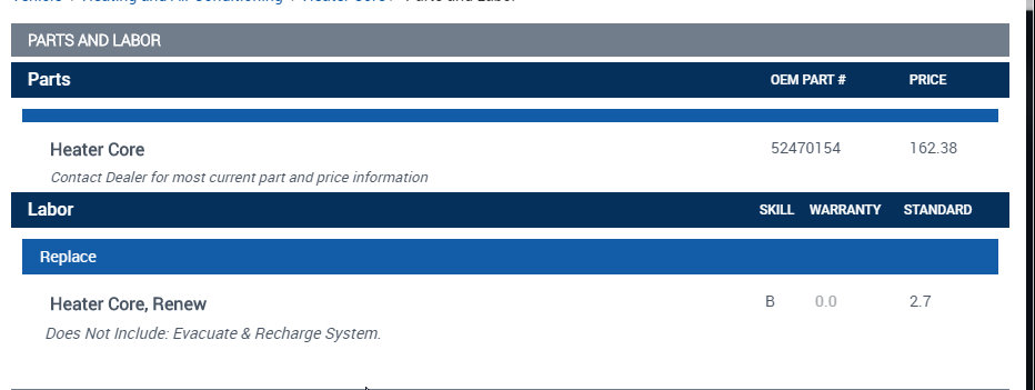

Can you please tell me how long it takes to remove and replace heater core in the car listed above?
Apr 26, 2020 at 5:29 PM

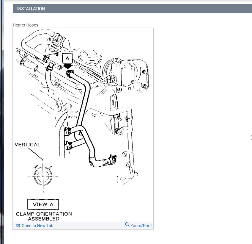

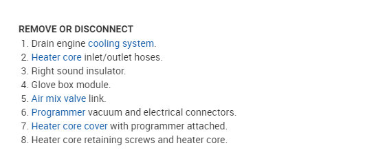

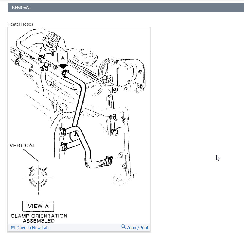

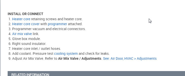

I attached the info you requested. Let me know if you need more and I will get it. I also included the process on how to replace it if you needed that as well. Thanks
