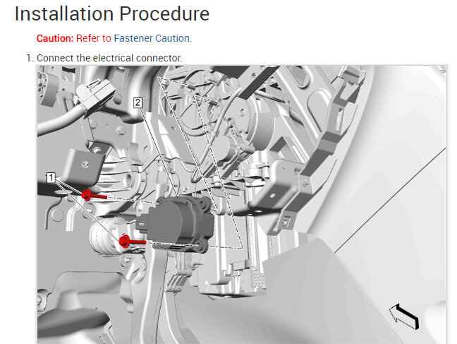

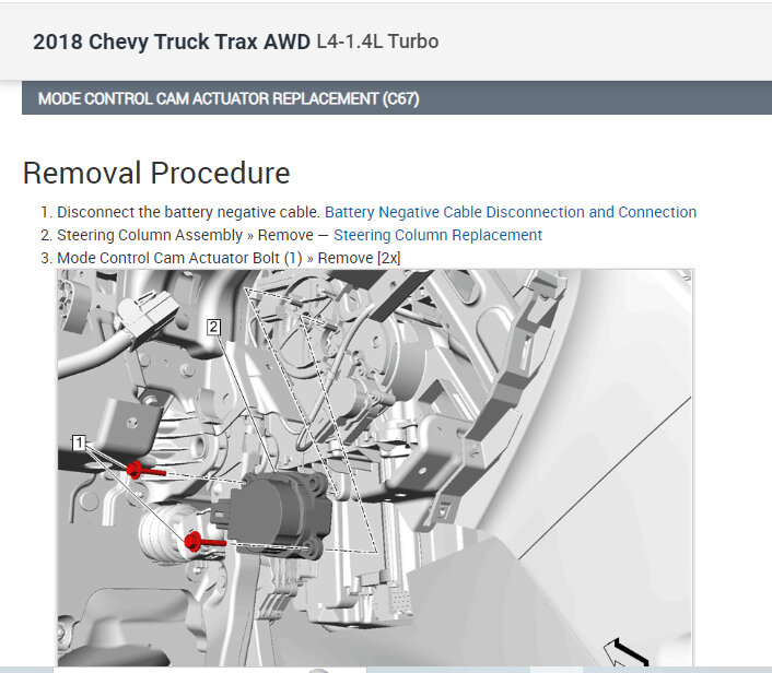

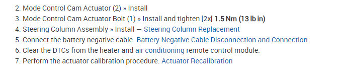

The knob that controls direction/level of where heat is sent out is stuck in the defrost zone. Is this something I can fix myself? I do have basic mechanical skills and do a lot of work on my own cars over the years, so im confident that i can tackle such a project, providing i need no special tools.

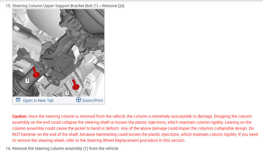

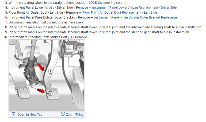

It sounds like the mode door actuator has failed. That is what determines the air flow direction.
I need to know if you have automatic or manual climate control. Also, this procedure will require the removal of the steering column. It isn't a fun job, but I would be happy to provide directions once I know the system type.

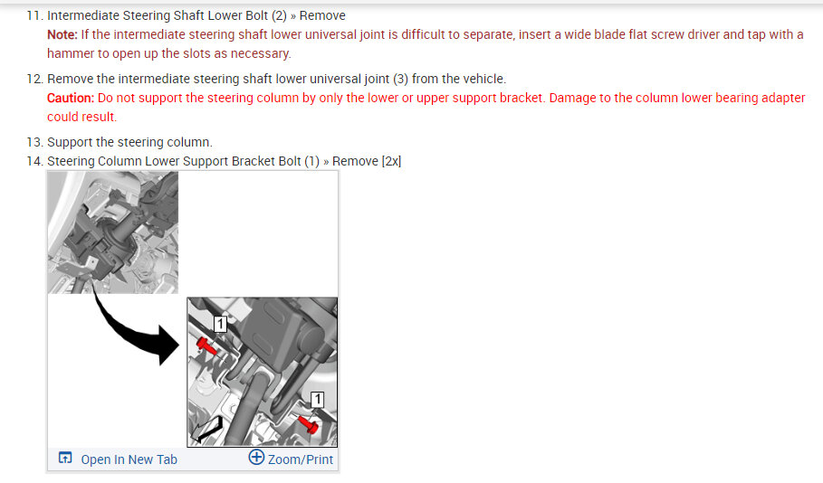

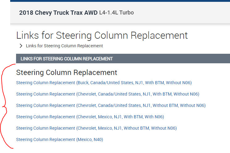

The first few pictures below are the directions for the actuator, once the column is removed. I ran into another roadblock. I need to know which column you have in your vehicle to get the correct directions. See last pic below. If you provide the VIN number, it should narrow that down for me. Otherwise, we will need to determine what the RPO numbers are for your vehicle.

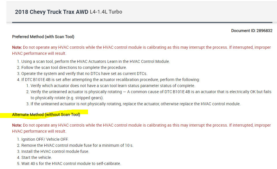

Pic 5 provides the recalibration procedure without a scan tool.

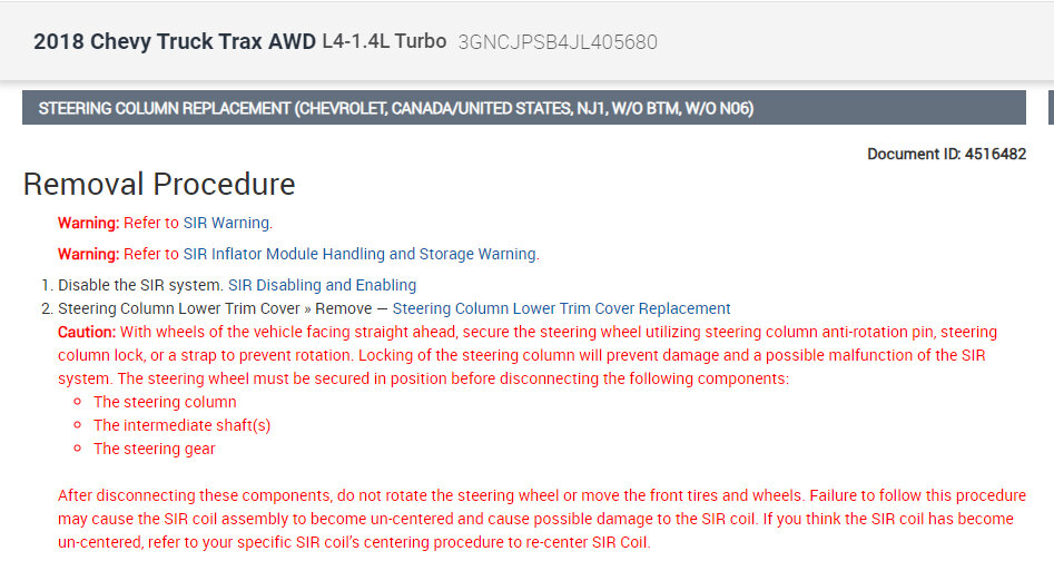

Here's my VIN 3GNCJPSB4JL405680. Yeah, I can see this is not going to be fun.

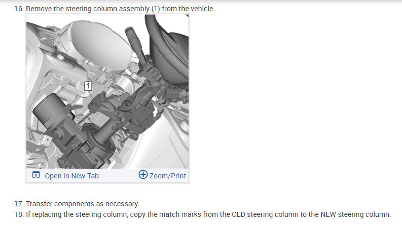

I believe I got the right one. It didn't narrow it down as much as I expected. When you do this, make sure the directions fit what you see. If they don't, let me know what is different. However, these should work.
See pic below.
