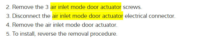

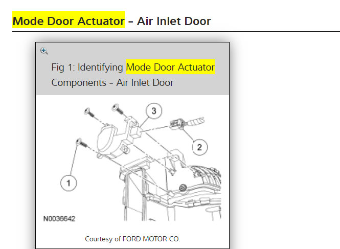

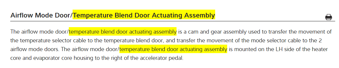

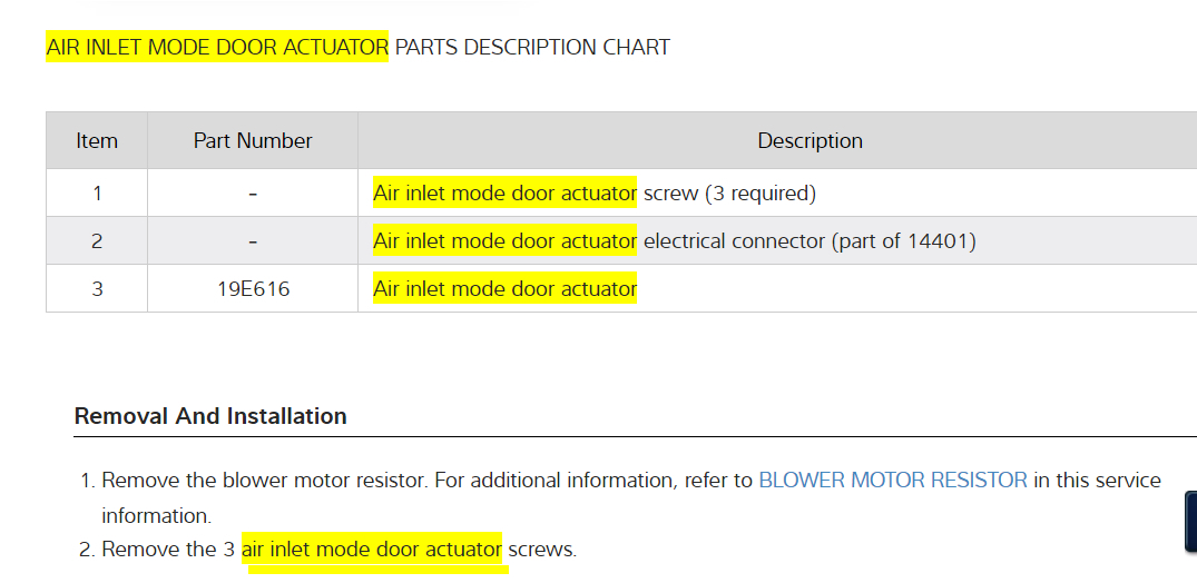

Does the 2011 Ford Transit Connect have a heater control valve? If it has a heater control valve where is it located?
Oct 8, 2019 at 11:26 AM
SCGRANTURISMO
  • 4,897 POSTS
In the diagrams down below I have included a description of and the removal and installation instructions for the blend door actuator. Please go through these guides and get back to us with how everything turns out.
