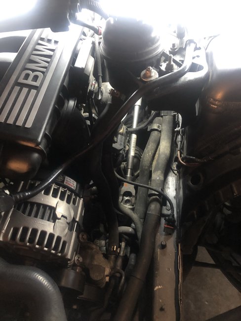

Heater control valve trying to locate it.

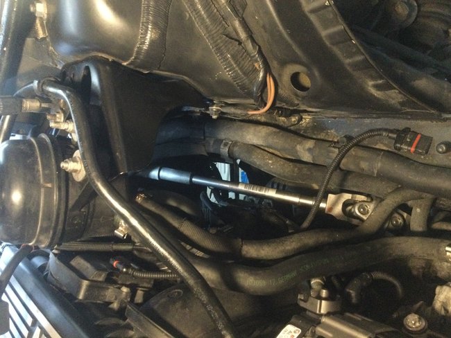

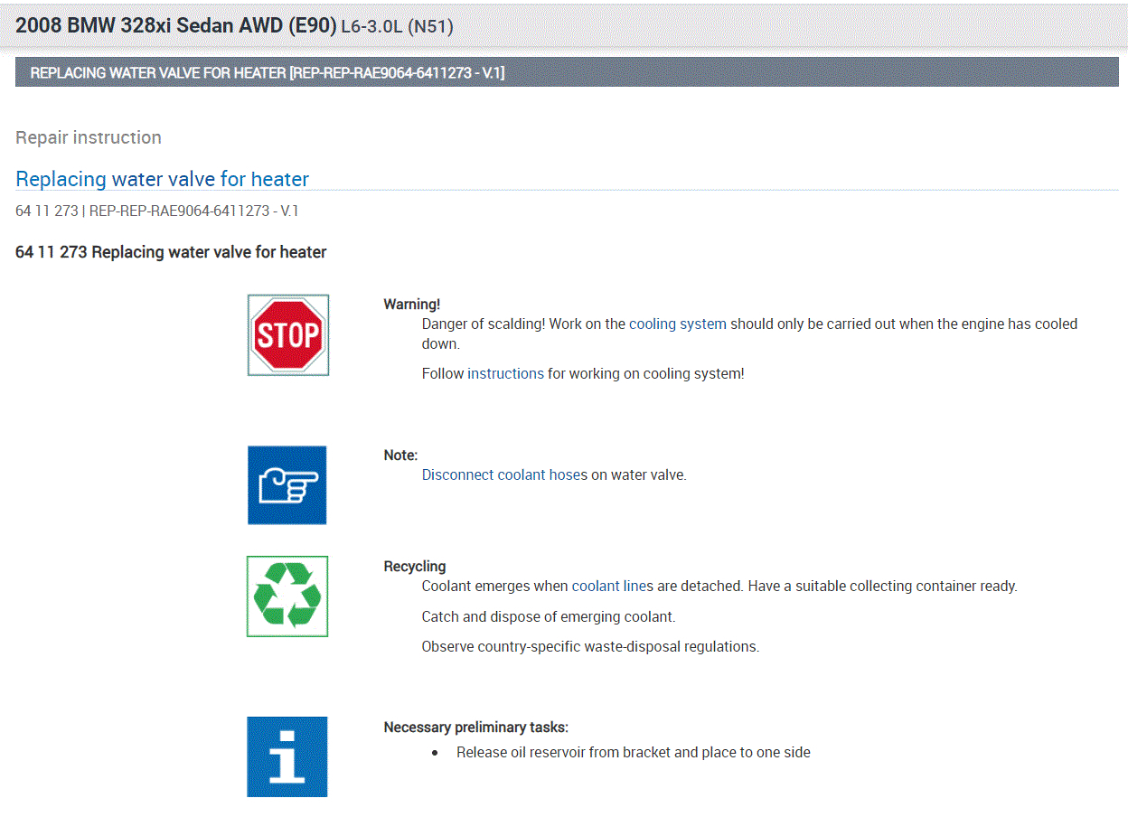

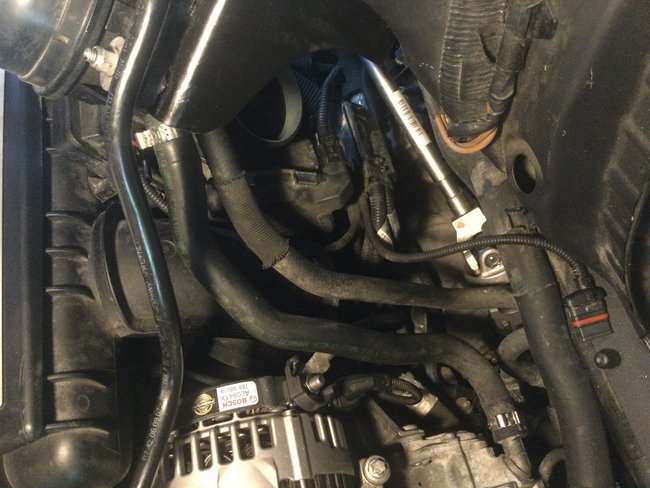

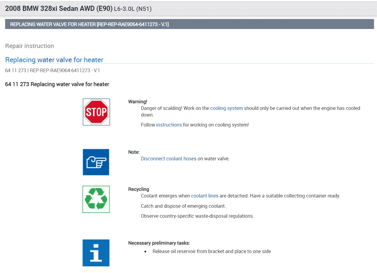

It should be near the throttle body and attached to heater hoses.
If you look at the attachments below, I provided the directions specific to this vehicle for replacement. There are two pics to help you locate the part.

I’m still not seeing it.

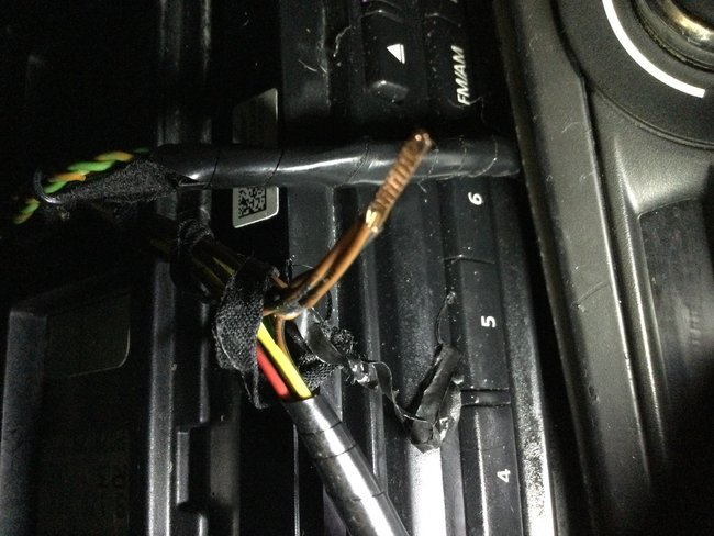

And I appreciate you responding to my post! My radiator fan isn’t blowing coming on unless I unplug the coolant temperature sensor, I’ve change the coolant temperature sensor of change the radiator fan temperature sensor oil temperature sensor. New battery, new alternator, new serpentine belt pulley, two expansion tanks, thermostat, water pump and a hose. I put a whole oil housing gasket on. I have put a new transfer actuator motor in and change the transmission fluid. I know there’s a few more things that I mentioned but this is getting really ridiculous because they are still not coming on and I also wondering what this little black boxes. so I’m going to send another picture.
May 28, 2021 at 3:19 AM
MICHELLERENEEMYRES
  • 9 POSTS

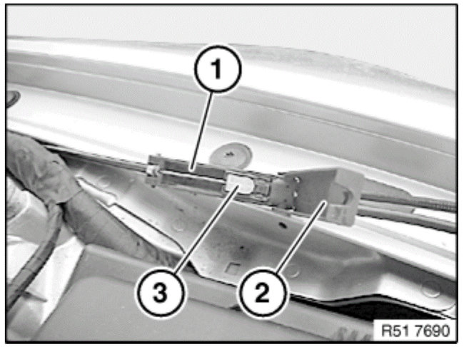

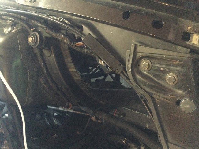

The little black box.
May 28, 2021 at 3:20 AM
MICHELLERENEEMYRES
  • 9 POSTS
Also my climate control isn’t working. I think I have found the culprit but I don’t know how to fix it or where to buy the gold plated bar or if I could solder copper on there I’m not sure. I’m lost I haven’t been able to drive my BMW in like six months. I’m a female and I had no clue about anything about cars before there’s been a learning experience but I’m ready to drive.
May 28, 2021 at 3:23 AM
  • 110,241 POSTS
The black box is a junction for the hood release cable. If you look at the pic below, it shows what it is.

I am still not able to locate my heater control valve does my BMW come with the heater control valve or not? My radiator fan isn’t kicking on I have replace both sensors. I have checked the fuses. I change my transmission fluid in on my OBD two it still says gearbox fluid at this point I don’t know what to do
