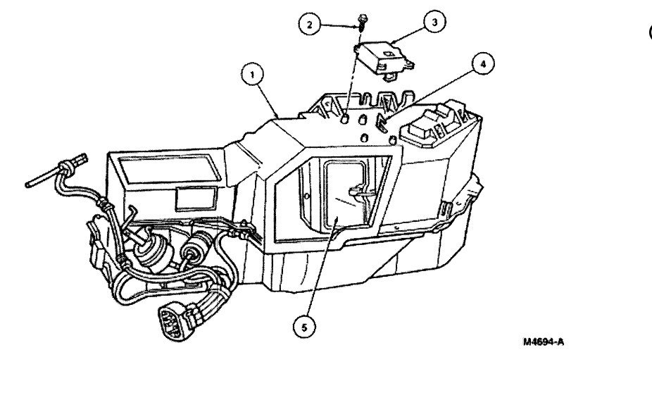

Cannot locate valve. has or is supposed to have the T shaped plastic valve with a three wire plug.valve stays open. A/C works good but not against heater still get heat when in A/C. i by passed the heater core and splice hoses together and get great cooling i live where 95 to105 degree temperature in summer is normal.
Inside controls or A/C have heat A/C and auto. no matter where set also on vent floor or defrost get hot air.

You car does not have a heater control valve. It sounds like there is a blend door actuator that is out, here is a guide and a diagram that will help you get the problem fixed.
Please let me know if you need anything else to get the problem fixed.

Thanks your the first mech.that had this info and especially appreciate the instructions you sent. The car does make the noise out of ac box.I would like tp make a donation.how do l go about it
