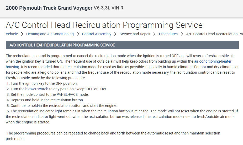

After resetting heater controls, four flashing lights in controls.

There is only one blend door actuator on this vehicle, so if you are getting heat on one side and not the other, something could be disconnected.
Have you had any of the ductwork removed for anything? Also, do you have normal pressure from the right side, just the wrong temperature?
Do me a favor. Take a look at the pic below. It is directions for resetting the controller. Let me know if this is what you have done.
See pic below.
