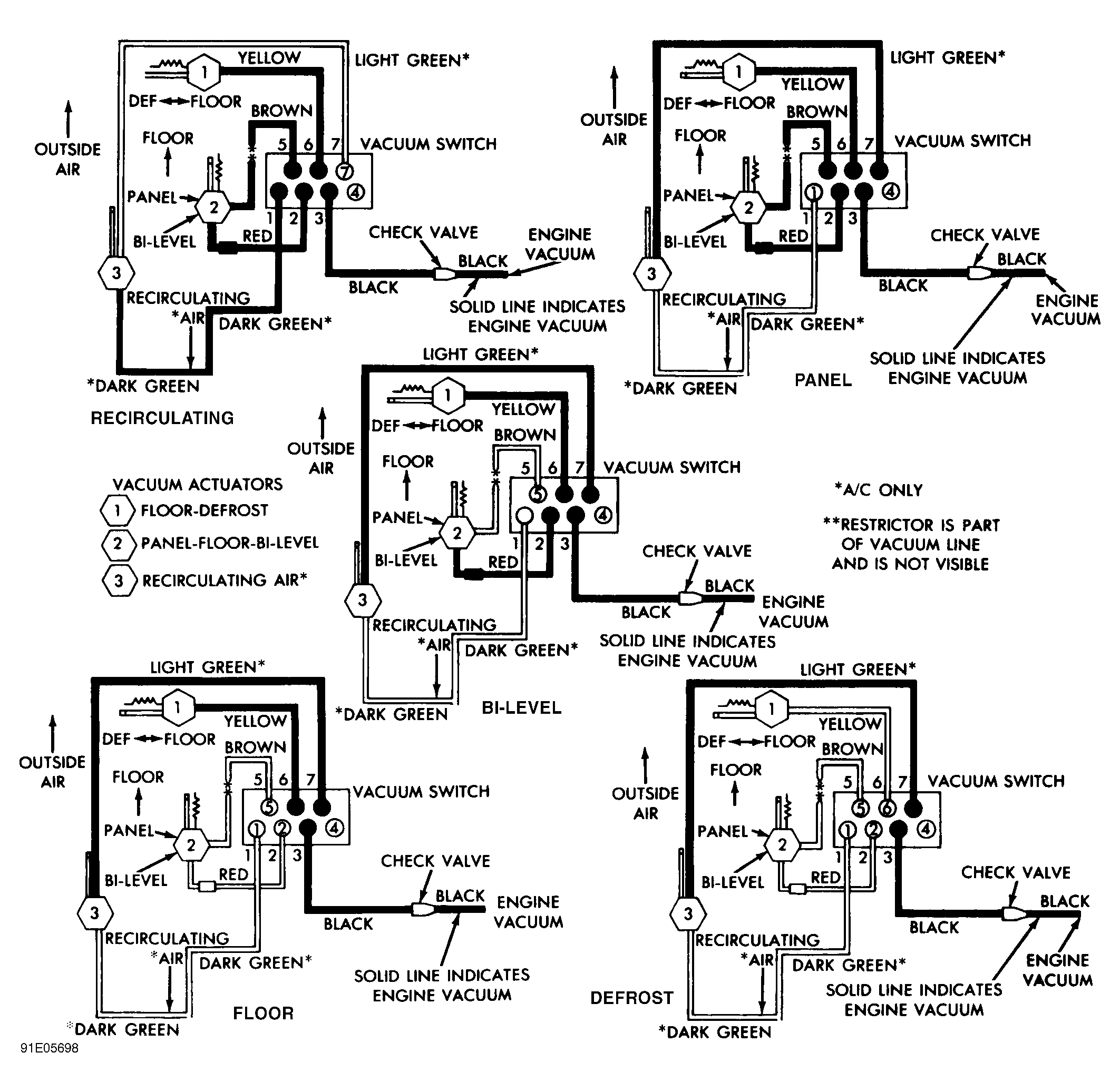

I just do not know where to disconnect the vacuum lines.
Feb 5, 2017 at 5:18 AM
STEVE W.
  • 15,418 POSTS
Should be a large connector block with the lines molded into it that plugs onto the back of the control panel. Here is a diagram showing the line colors and locations.
Feb 5, 2017 at 5:58 AM
EVAN WARD
So I just pull them from the back of the unit? I can not slide it out far enough to see and I do not want to damage anything.
Feb 5, 2017 at 7:33 AM
STEVE W.
  • 15,418 POSTS
Work them a bit and the unit should slip out enough to get the lines off. It will be tight.
