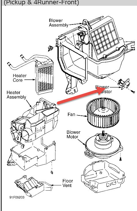

When I move control lever for low, medium, high air flow the high air flow is the only one that works, I have changed the blower control unit and air control switch but the low and medium control does not work.

check to see if blower resistor is getting and sending power the resistor may be bad.
