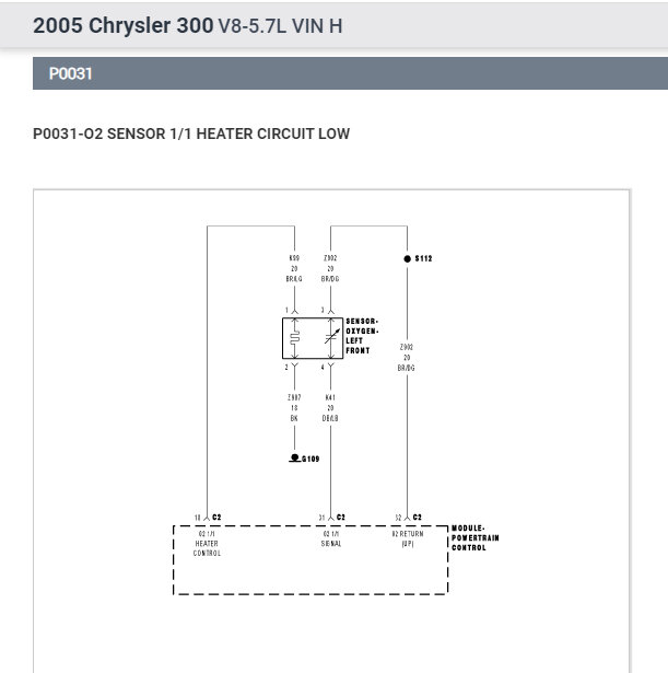

Recently purchased this car broke down as a project to fix up myself, the only codes it’s showing is the heater circuit low for all 4 O2 sensors. I replaced the sensors, and the same codes are still present after clearing. I have tested for voltage, done pin to pin test for continuity, everything seems to check out. I read the wiring diagrams and the upstream and downstream sensors look to be completely separate including the ground location. There also doesn’t seem to be any fuses associated with the sensors.

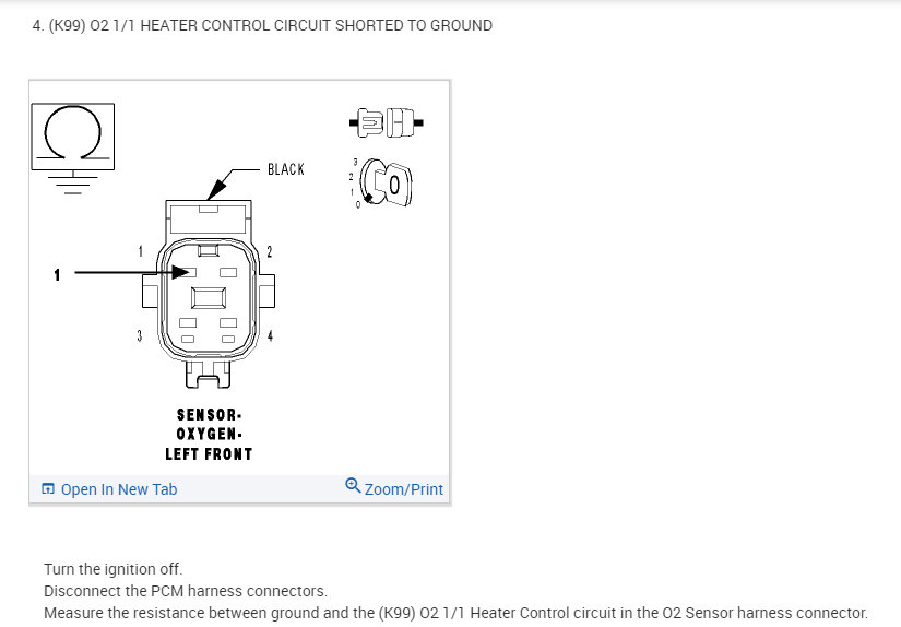

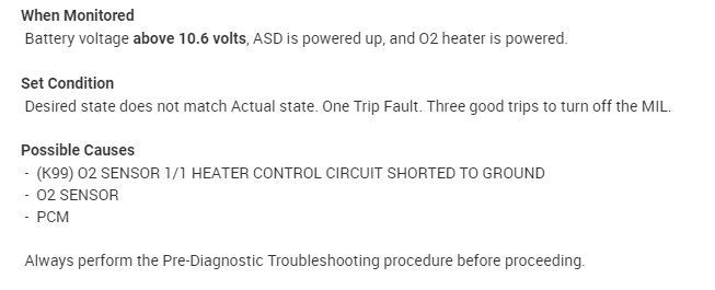

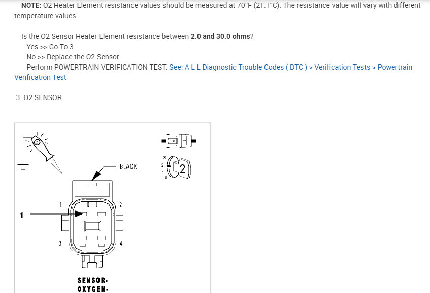

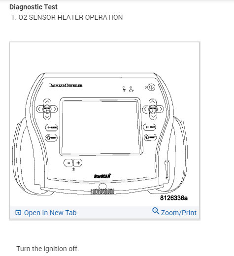

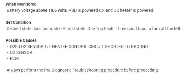

When you have a low voltage issue like this, either the sensor is bad, you have a short to ground, or the PCM is failing.

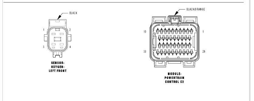

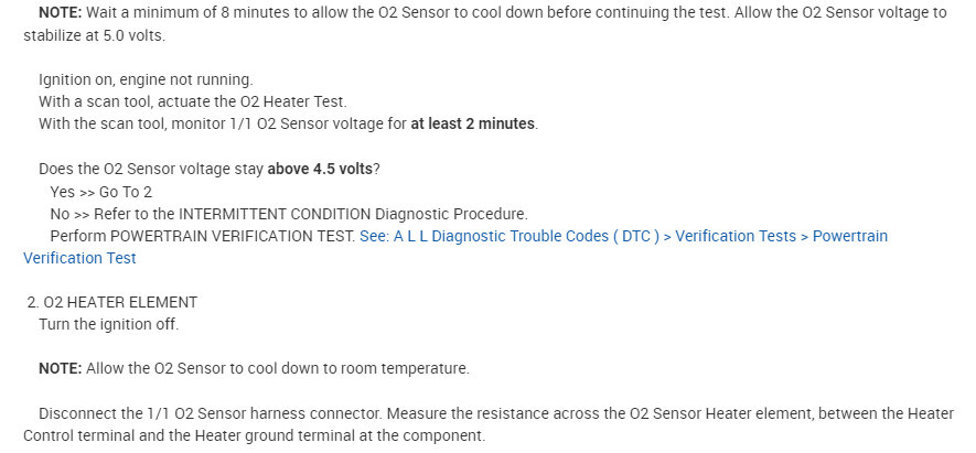

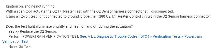

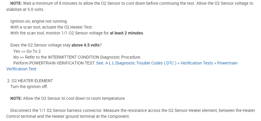

Did all of these codes show up at the same time? Are you comfortable performing diagnostics specific to the codes? If you are, I attached the diagnostics for the P0031. The diagnostics for the other codes are the same but different pin connectors are checked.
Jul 7, 2023 at 12:26 PM
NOAH.B.111
  • 12 POSTS

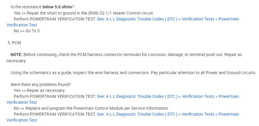

Thank you for the diagnostics, the only thing I’m stuck on is the testing for the short to ground. It says to disconnect the PCM harness connectors and to test at the o2 sensor harness which I did, but the multimeter isn’t registering any resistance at the harness connector. If I probe the heater wire at the PCM harness (with the sensor plugged in) it reads 4.5 ohms. That’s less than 5 would that indicate a short to ground. Also, how would that work considering the upstream and downstream sensors have different grounds? If it helps, I probed other non-related wires as well and they were all over 10 ohms.

When you checked for resistance with the sensor unplugged, did you go between the PCM, and the sensor plug to check for resistance? With that test, you are testing the wire only. Also, when you tested and found no resistance, what was listed on the DMM?

I tested the resistance between the heater circuit wire in the sensor harness and ground (with PCM harnesses disconnected) the multimeter read O.L.

OL indicates an open loop, meaning there is no connection. That is odd. If you are going from one end to the other, there should be a connection or continuity.
You know the DMM better than me. On yours, is that what the OL stands for? I ask because there are different manufacturers, and they all have different ideas. LOL

Yes, I believe that is what it stands for on mine. If I test the heater wire from PCM harness to the sensor harness it does read 0.00 ohms.
It seems odd to me they say to disconnect the PCM then test the resistance from the sensor side to a ground?

They want to make sure the wire itself isn't faulty. It sounds like you may have found the issue. Let me know if you get it resolved.

So, If 0 means good continuity then the wire is fine, and it would be a faulty PCM?
Also, just found out the O.L when measuring resistance actually stands for over limit, of what the multimeter can read.
Jul 8, 2023 at 5:15 PM
  • 110,244 POSTS
I never heard that one before. As far as the issue, if the wiring and everything other checks good, then unfortunately, it sounds like the PCM has failed.
