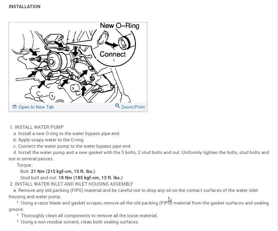

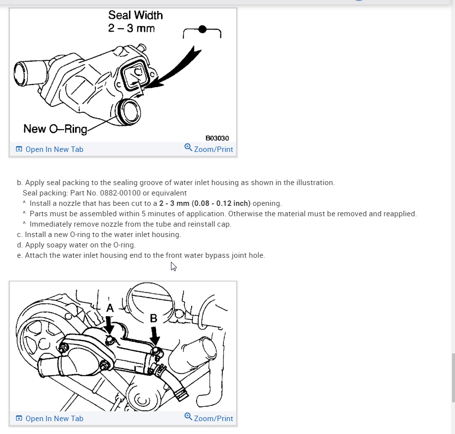

When installing heater bypass tube into back of water pump is silicone needed as well as new o-ring?
Jul 3, 2019 at 4:14 AM
Experienced Mechanic
18,907 POSTS
Hi Dave,
According to the manual you do not. Here is the installation procedure in case you need the rest of the process.
Let me know if you need anything else. Thanks
