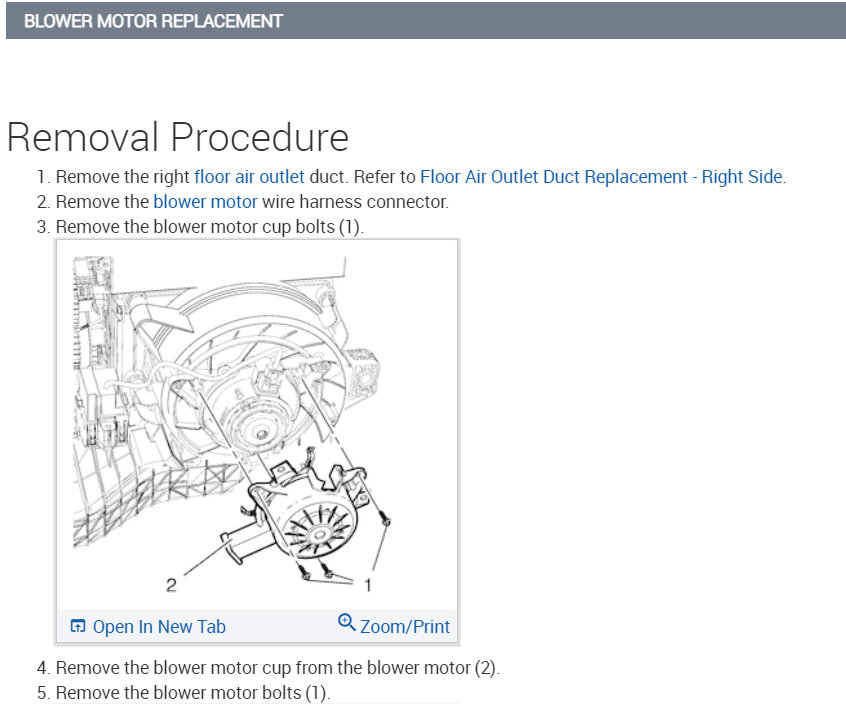

heater bower motor not working properly?
2015 VAUXHALL ASTRA
62,396 MILES • 2.0L • 2WD • AUTOMATIC
BENBILLY12
i have just had my car serviced, i asked them to look at the heating system, the dials work and lights come on, but nothing comes out. they called Vauxhall for a part and Vauxhall want over £400 for this part, they told me to look on Ebay for this part but I'm not sure what I'm looking for.
Sep 19, 2023 at 9:41 PM
  • 55,421 POSTS

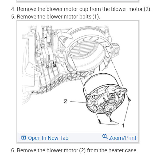

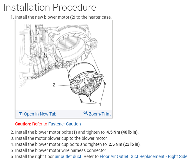

It sounds like the blower motor is not working. Here is a guide to help confirm the issue with images below to show you how to change the part out:
https://www.2carpros.com/articles/blower-fan-motor-works-on-high-speed-only
Check out the images (below). Please let us know how it goes.
Sep 21, 2023 at 3:54 AM
