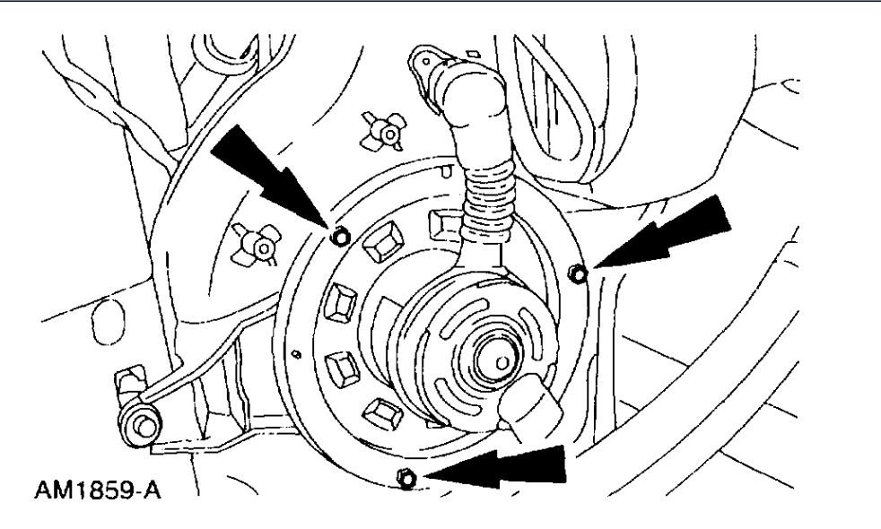

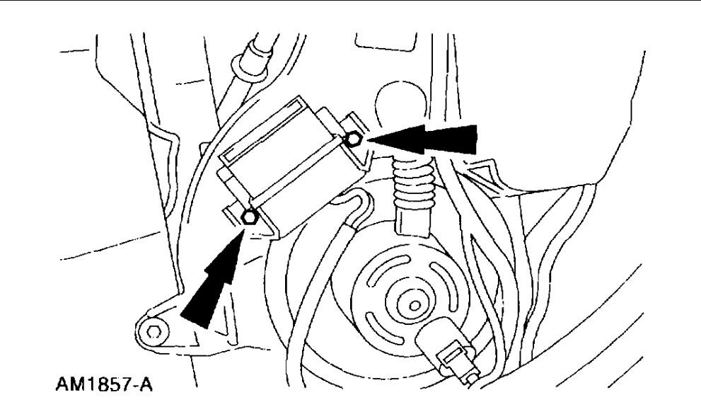

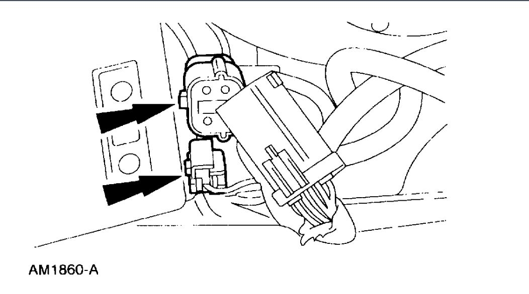

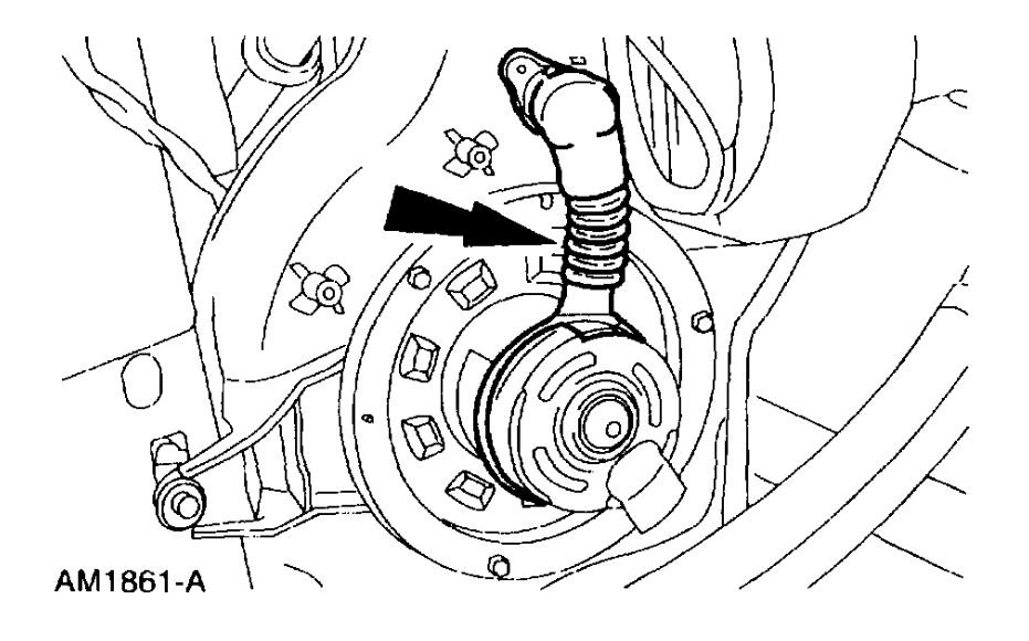

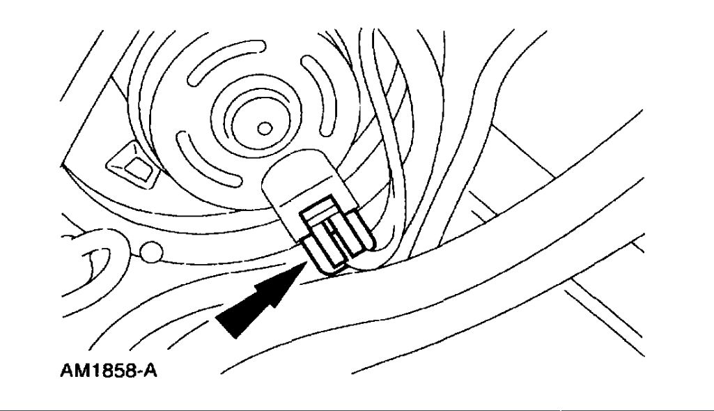

Where is the blower for the back?
Dec 25, 2019 at 11:30 PM
It is behind the trim panels inside the rear hatch.
I provided pictures and a procedure for you.
REMOVAL
1. Remove the trim panels.
2. Disconnect the connectors.
3. Disconnect the rear blower motor.
4. Remove the screws.
5. Remove the vent tube.
6. Remove the rear blower motor.
Remove the screws.
INSTALLATION
1. To install, reverse the removal procedure.
