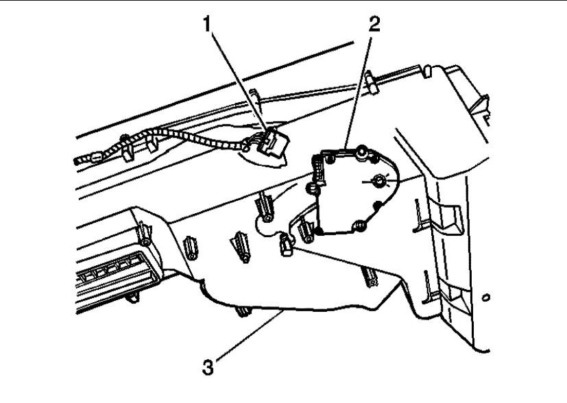

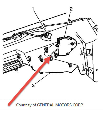

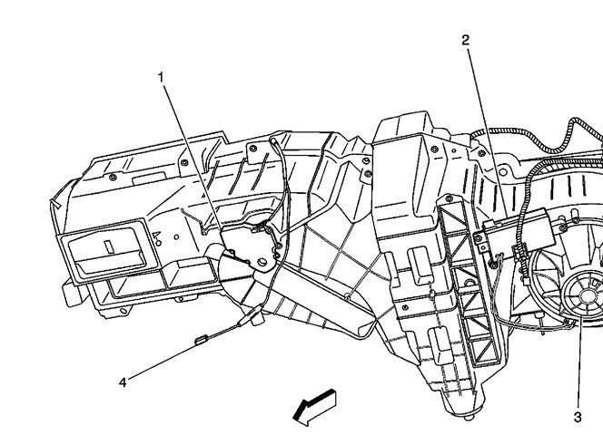

When I turn the heat on, the driver side blows heat but the passenger side blows cold air. I don't hear any unusual noises.
Oct 23, 2019 at 3:11 AM
  • 110,244 POSTS
Welcome to 2CarPros.

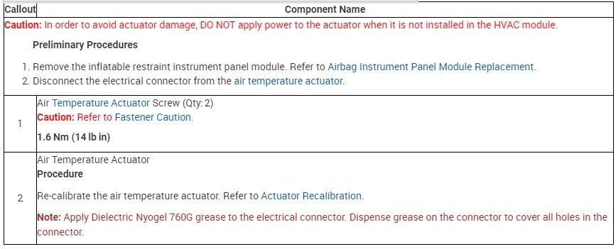

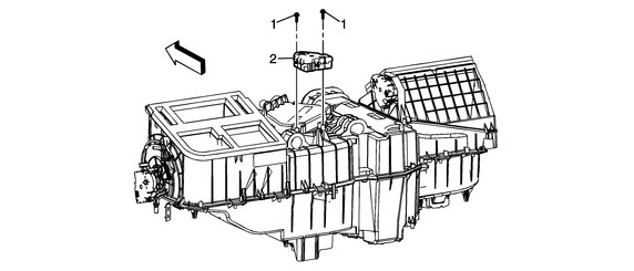

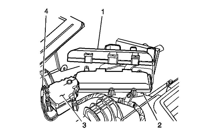

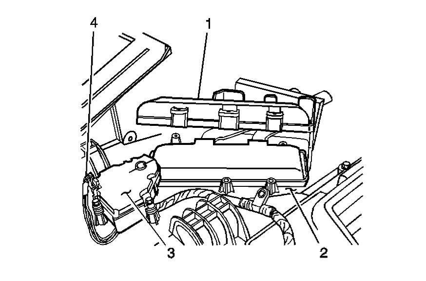

On this vehicle's dual climate control, there are two blend air door actuators. Most likely, the one for the passenger side has failed.
Take a look through this link:
Now, I attached the pics specific to your vehicle for right side actuator replacement. Pic 1 shows location and pic 2 are the directions.
What I would suggest is to locate and test the switch to see if it is getting power. If there is power and the actuator isn't responding, replace it.

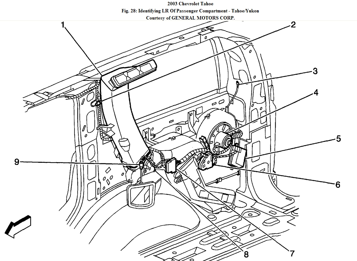

Ok sounds like auto system, here's a diagram of the parts and location, I do recommend a scan!

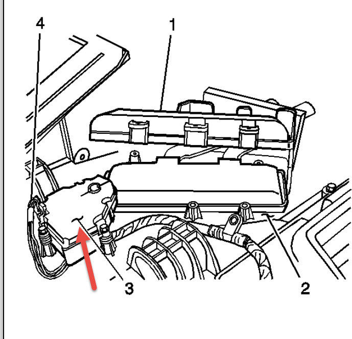

HMAC300
  • 48,601 POSTS
there is a temp actuator that controls heat/cool. First try pulling hvac fuse inside car for 60 seconds with key on then reinstall and see if it gets warm after a minute if not it may be the actuator is not working or the door may be broken. Pic shows temp actuator on rh side it's pretty easy to change you may have to remove a panel. Also make sure connector is getting power if not it will need scanning to see if control head is bad.

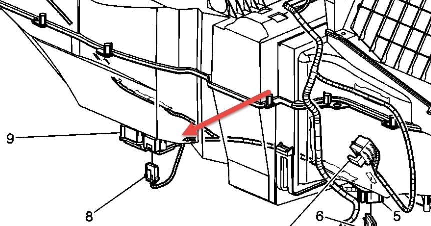

HMAC300
  • 48,601 POSTS
see if both heater hoses are hot when engine warm, then it couldbe an actuator on the heater stuck or not getting power and not opening. beneric pic enclosed.
