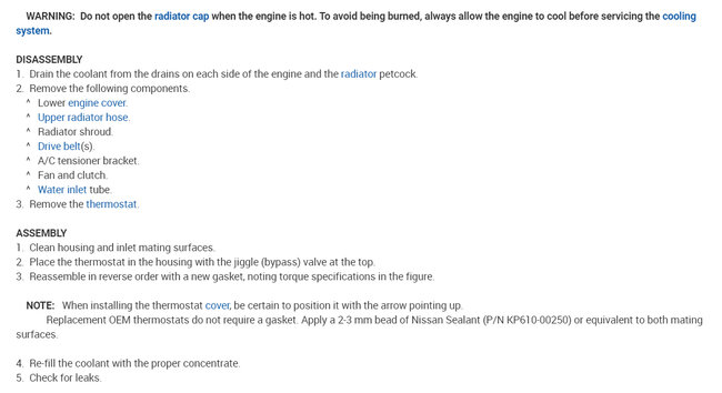

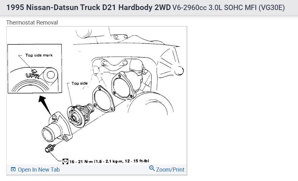

It sounds like you have found the problem is that the thermostat is stuck open which will not allow the coolant to get hot enough for the heater to work and it will cause the lower radiator hose to be cool as well. Here is a generic guide to help you step by step with instructions in the diagrams below to show you how on your car:
And this guide may help as well:

Hi again. The thermostat replacement was the problem. I now have great heater function! It was a pain. The lower rad hose travels back and up behind the belts and up to therm. housing. It starts out as rubber hose then it's only metal pipe before it's rubber again. Pipe is crimped and bracketed to power steering tensioner to clear belts. Barely and such a pain. Also 3 days later my idler pulley nut vibrated off. When I tightened it, pulley wouldn't spin. Guess I them loosened it to much. I replaced belt, pulley, and nut. This time I put blue thread lock on bolt. There is no spacer. Is this a proper fix to keep nut from coming off and allowing for pulley to still spin?
