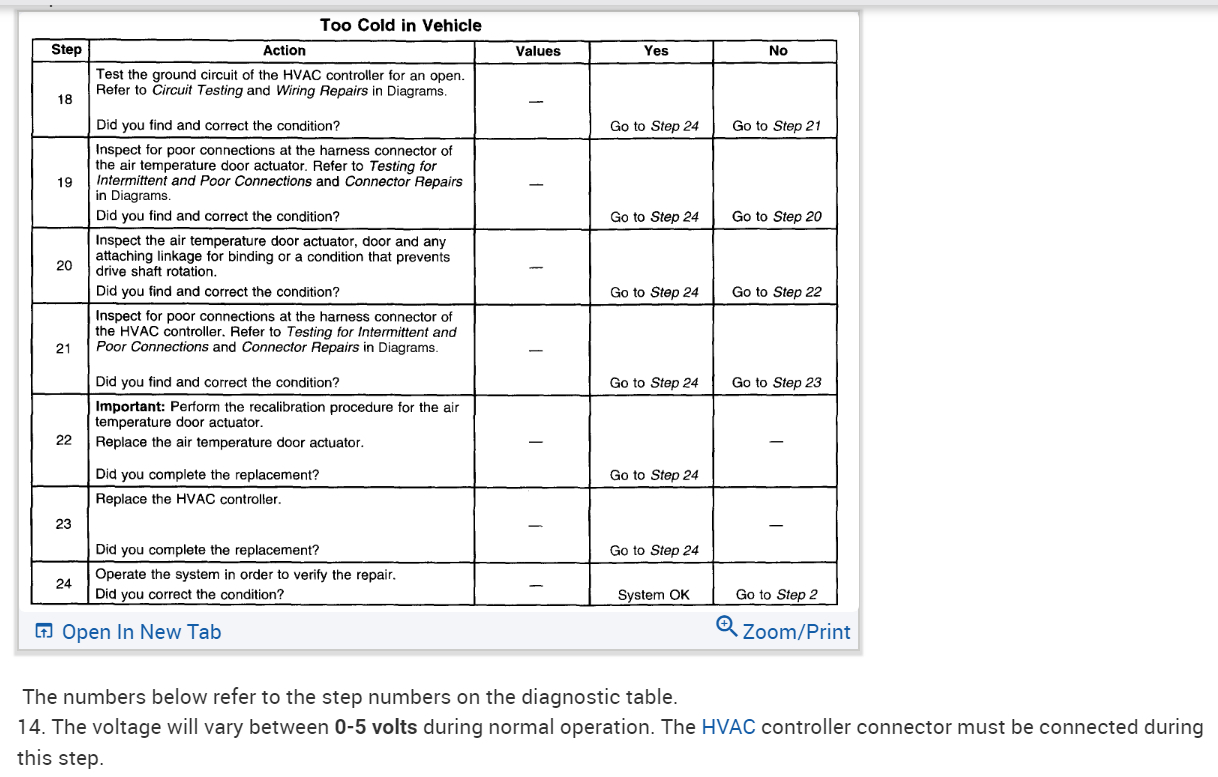

Hello all,
Our heater blows hot for about fifteen to thirty seconds when first turned on and then goes lukewarm to cold. The heater works almost always when all controls are off with the temperature set to max hot with the outside air coming in (this is not a dual temperature control).
Recently, the heater worked great for a few minutes and then went cold again once I cycled it to cold and back to hot.
I topped off the coolant and checked for leaks. No issues.
I checked the heater core lines (the line on the left side (driver's) is hot to where you can't keep your hand on it due to the heat. The right side line is hot/warm (you can keep your hand on it without it burning).
I examined the blend door actuator right under the dash (easiest one to get to) and it is turning the plastic door shaft from hot to cold. It makes a very slight clicking noise or you can just hear it working? Is it possible for the door position sensor to be faulty even with the actuator turning the shaft?
Could my issue be from any other blend motors?
I am going to try replacing the cabin air filter, flushing the heater core, and burping the heater core as well.
I am not the best in automotive repair so please bare with me if I was confusing at all. Any help will be appreciated.
Thanks to all for the help and this awesome website!

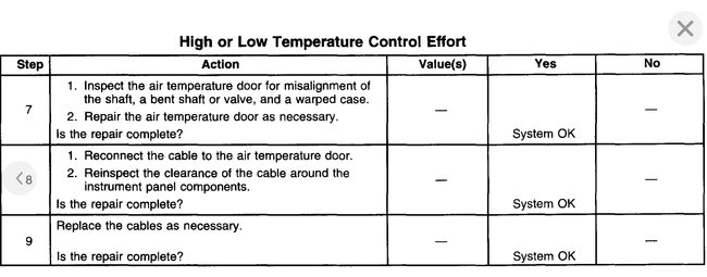

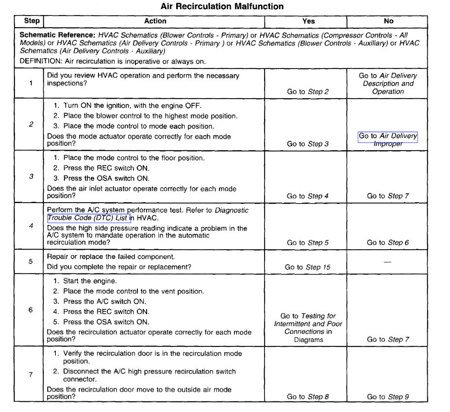

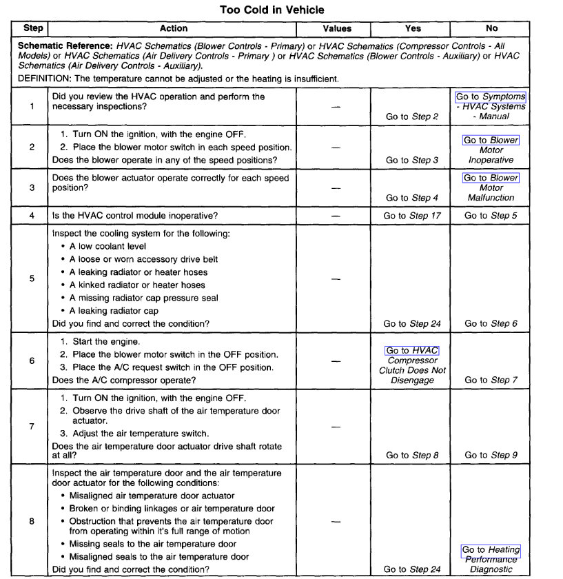

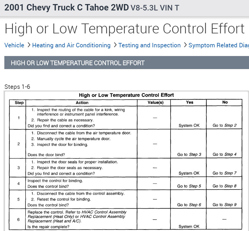

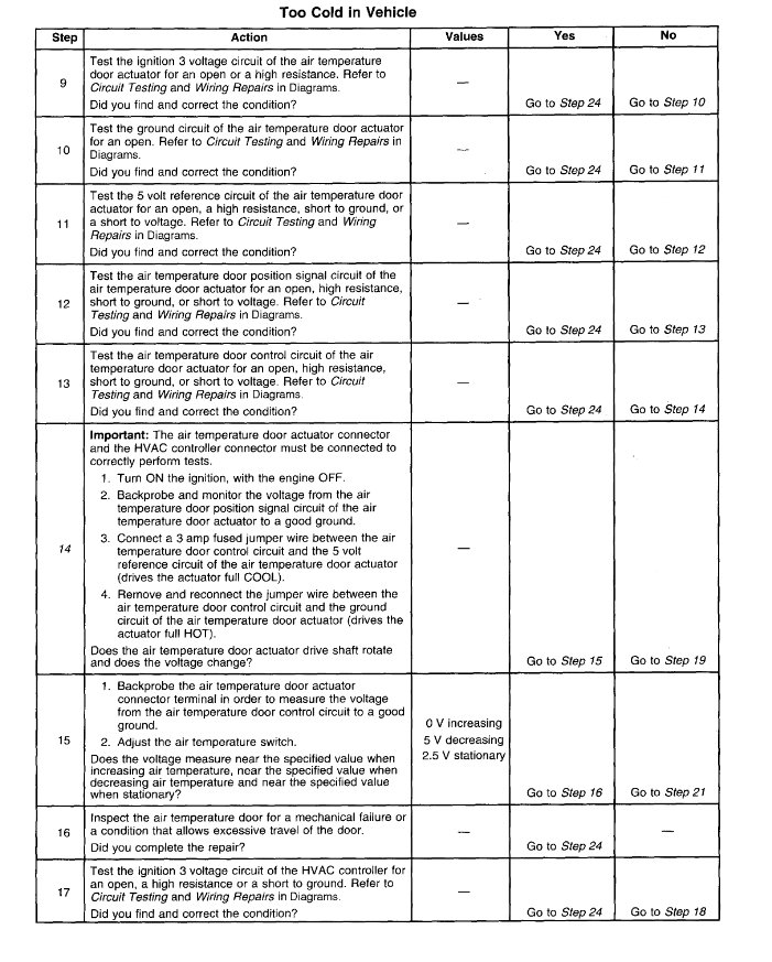

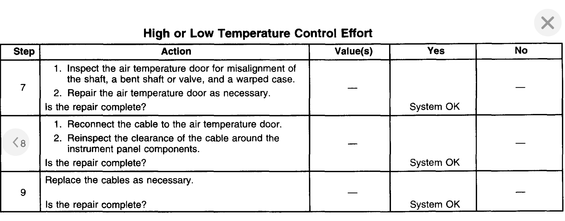

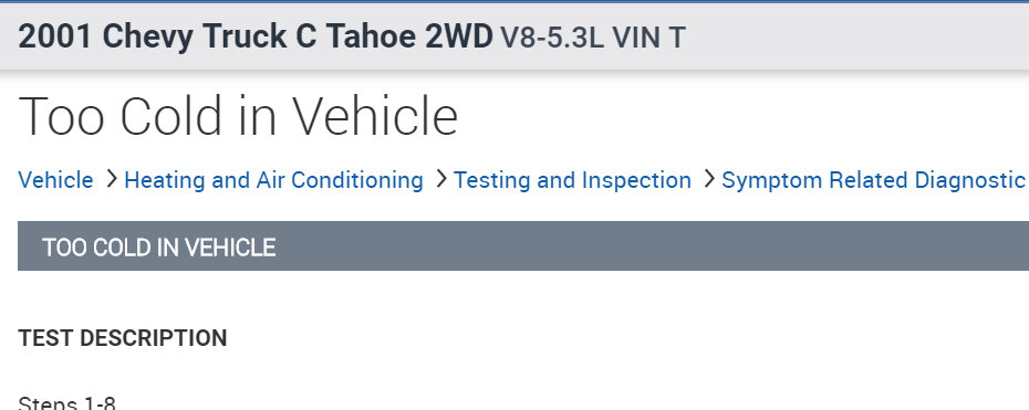

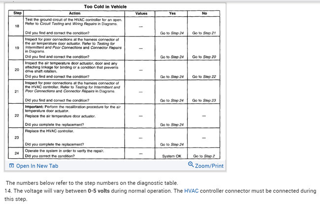

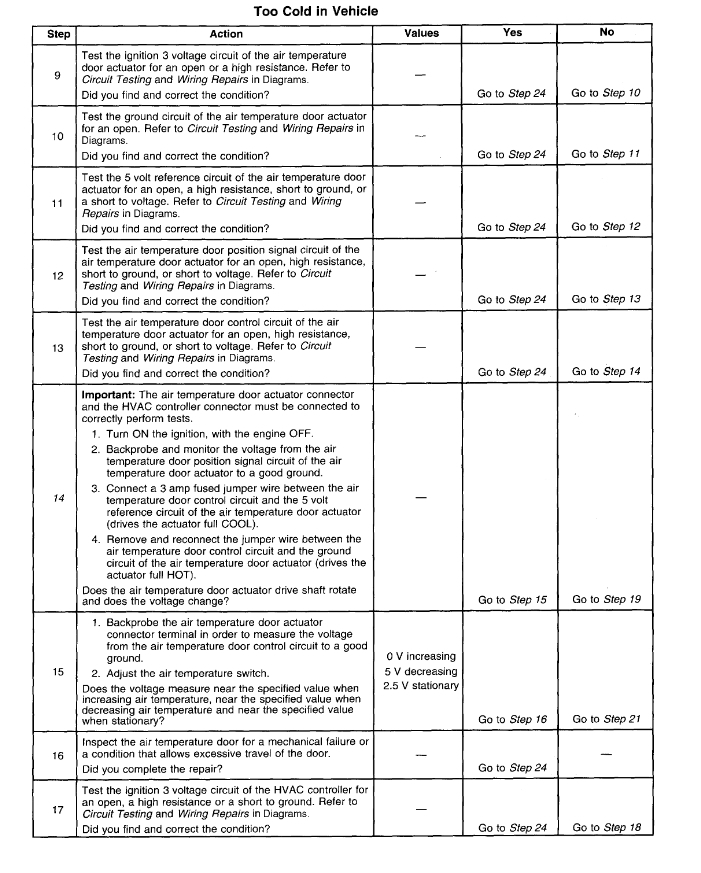

This could be a problem with your blend door. In the diagrams below I have included a few step by step factory troubleshooting flowcharts. Please go through them and let us know what you find out. We are glad to hear that you like the site. These guides can help fix it
and
Check out the diagrams (Below). Please let us know what you find. We are interested to see what it is.

BROOKSGONZALES
Hello again,
I have looked at the diagrams and so far they seem a little complicated for me to understand. I will work on it though for sure.
Just wanted to know if it is possible for the blend door actuator to be bad even if it's turning the blend door shaft? Would you recommend replacing it or should I skip or start with the diagnosis process?
I removed the actuator once, attempted to line all parts up with the lines, and when I put it back in the shaft would go in one direction then get stuck. I purchased a new actuator, took it apart, and placed all parts in the old actuator in the same position as the new one. After re-installing, the shaft spins in line with the cold and hot cycle as it did before. Still the same problem. Does this vehicle have a re-calibration procedure? I disconnected the negative terminal on the battery for ten minutes and then placed the key on the on position for two minutes as I saw this on a YouTube video. Just wondering if this vehicle requires this?
Thanks in advance!

This sounds like the air temp actuator, but you should get it tested with a scanner, a "U" code should be stored in memory....this test will eliminate the guesswork, and in the long run save you some money!
