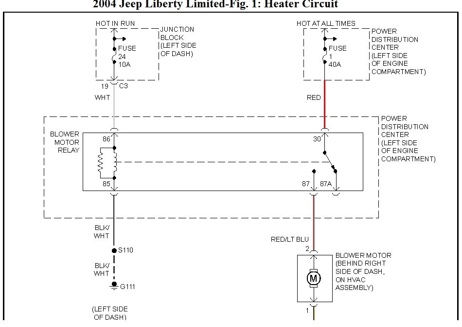

heater blower don't work
2004 JEEP LIBERTY
159,000 MILES
BERTCOTTON

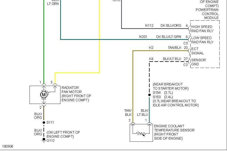

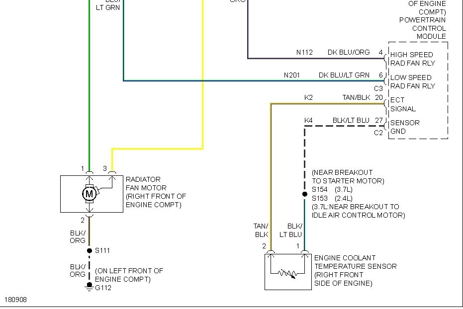

i have the radiator fan wont work but can straight wire it and it will run.
also the same with the heater blower motor
Apr 25, 2013 at 9:37 PM
JDL
  • 16,098 POSTS
As far as the radiator fan, check fuse2--40 amp in the underhood fuse block. Check the coolant temp sensor.

Maybe this diagram will read better?
Apr 26, 2013 at 12:00 AM
JDL
  • 16,098 POSTS
for the heater blower, did you check applicable fuses and voltage? The resistor block and hvac control are on the ground circuit. Did you check voltage and ground at the blower motor connector?
