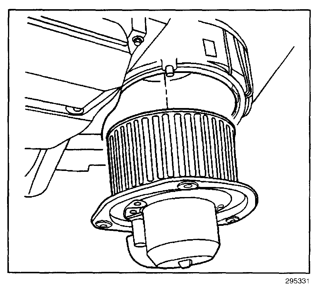

Checked fuses, all good. not sure where heater motor is located. can someone tell me where it's located so that I can change it? we get heat and the motor in the back works just not the one in the front so it's a pain in the butt to defrost. Any help is appreciated..

Here are the directions for replacing the blower motor. However, before replacing it, I would check for power to it. The problem could be something other is bad. Also, you can provide power to it directly to see if it runs.
____________________________
Here are the directions. The attached pictures correlate with the directions.
2001 Pontiac Truck Montana V6-3.4L VIN E
Blower Motor Replacement
Vehicle Heating and Air Conditioning Blower Motor Service and Repair Procedures Heating, Ventilation and Air Conditioning Blower Motor Replacement
BLOWER MOTOR REPLACEMENT
REMOVAL PROCEDURE
pic 1
1. Remove the right side IP insulator. Refer to Closeout/Insulator Panel Replacement - Right in Instrument Panel, Gauges and Console.

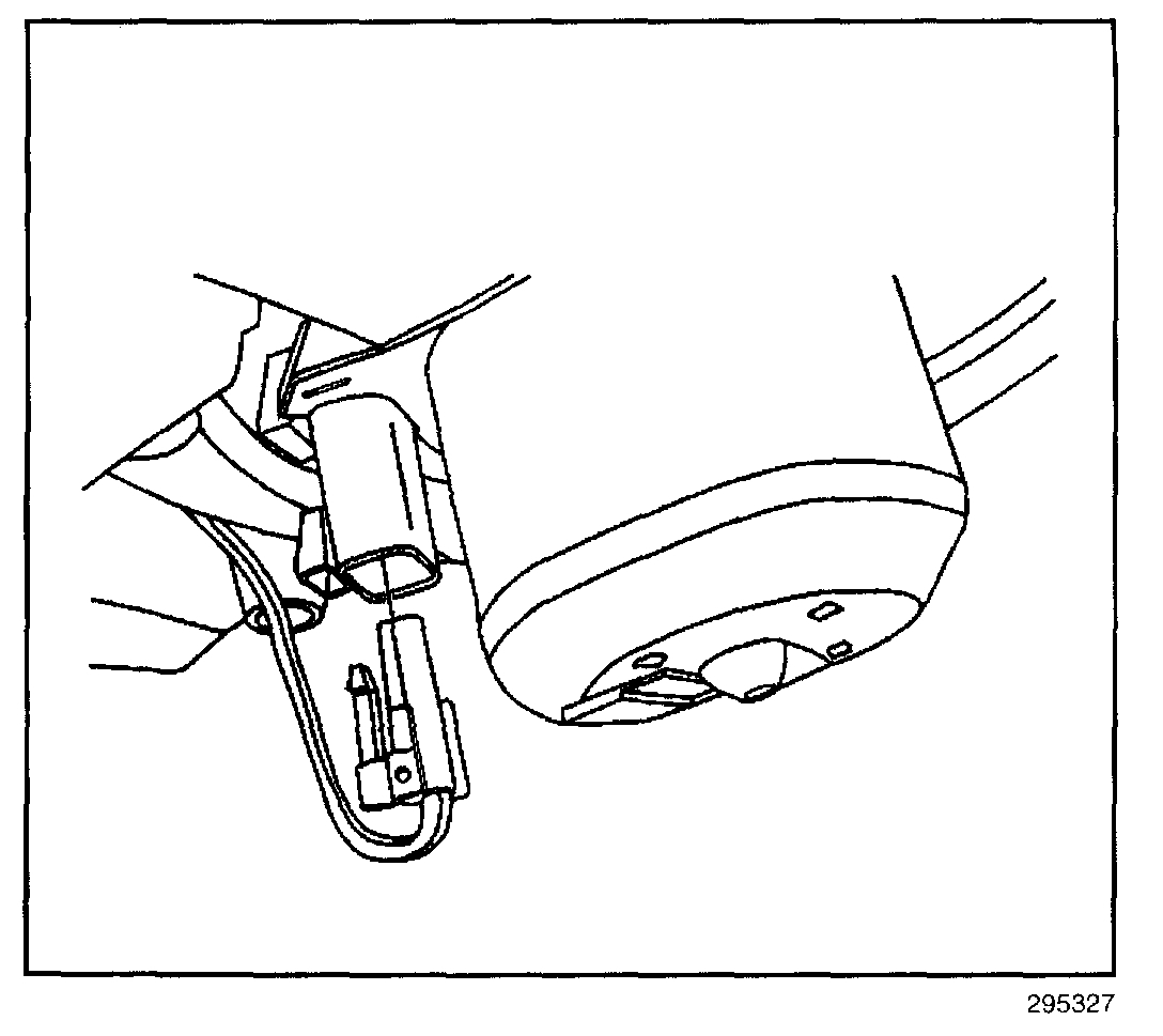

2. Disconnect the blower motor electrical connector.
3. Remove the blower motor mounting screws.
pic 2
4. Remove the blower motor from the HVAC module assembly.

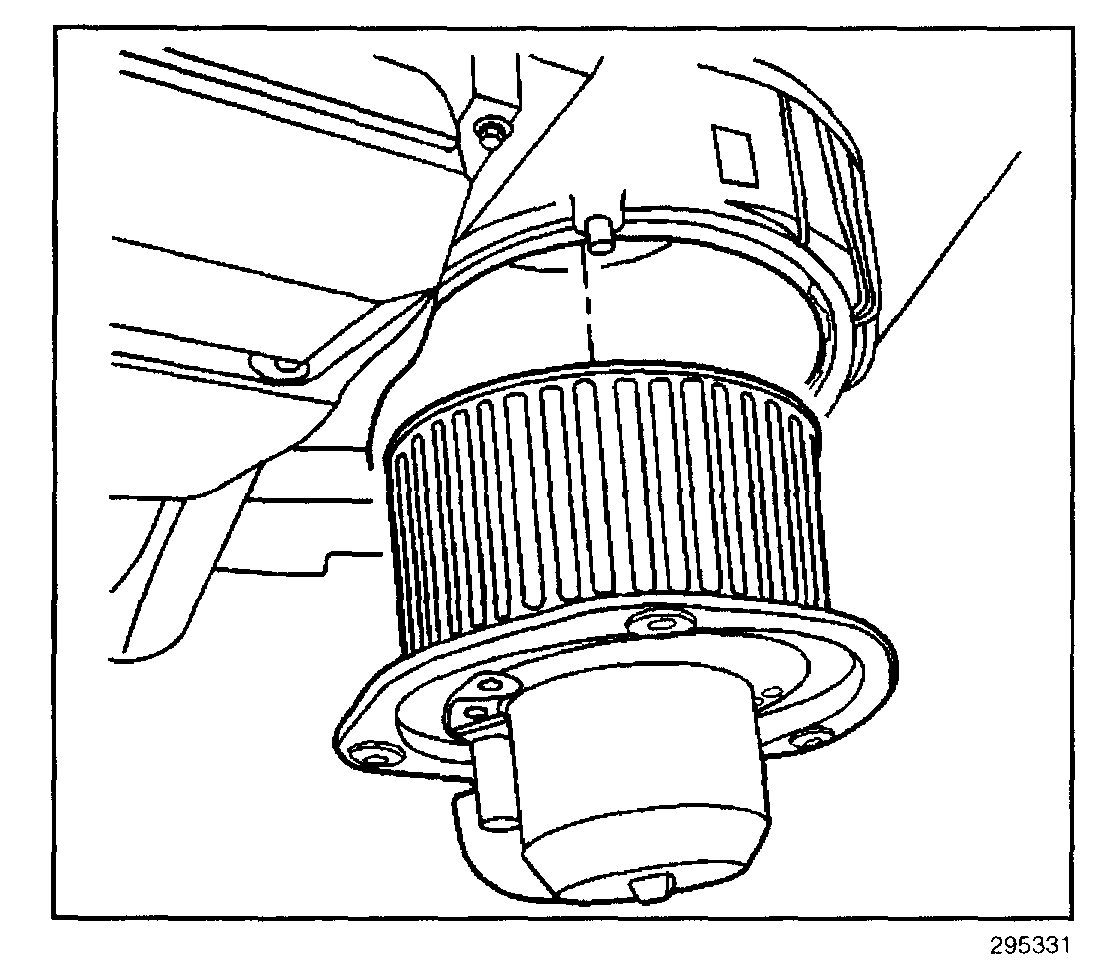

pic 3
1. Install the blower motor to the HVAC module assembly.
NOTE: Refer to Fastener Notice in Service Precautions.
2. Install the blower motor mounting screws.
Tighten
Tighten the screws to 1.8 N.m (16 lb ft).
