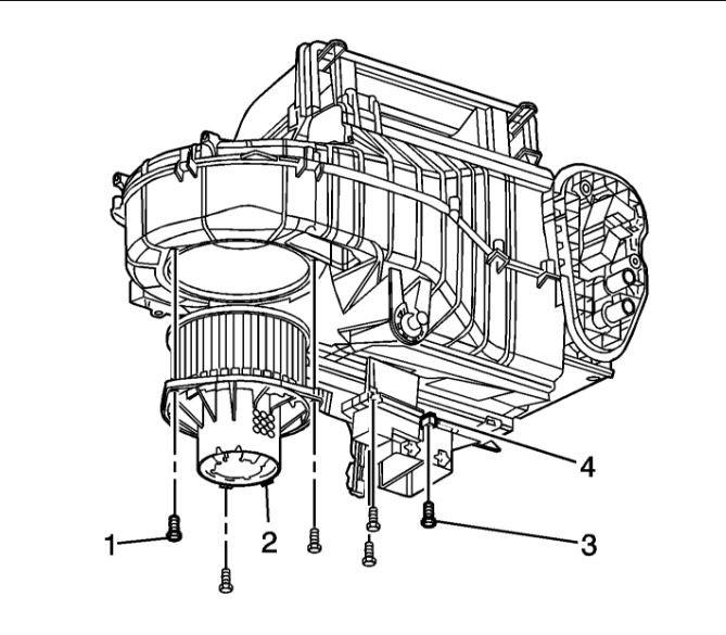

Need to remove and check heater module located behind blower motor, hard to get to. Blower motor already removed.

Yes, it is tight. I peel back the rug and the insulation to give me more room to access the screws. I also only loosen the inside screw and remove the front two. Then it will release forward and down.
