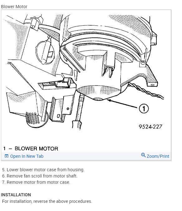

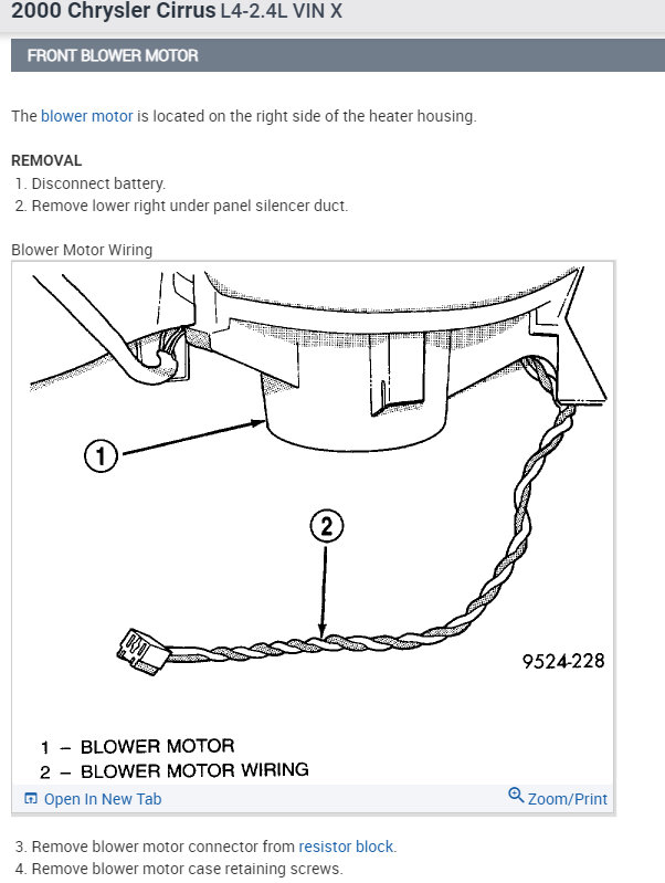

need to know to disasemble dasboard to replace heater blower fan.
Dec 25, 2016 at 9:55 AM
SQM
  • 6,383 POSTS
The blower motor can be accessed from under the passenger side dash. Only item you will have to remove before the motor is the lower right under panel silencer duct.
Then simply unplug the harness and remove the screws.
