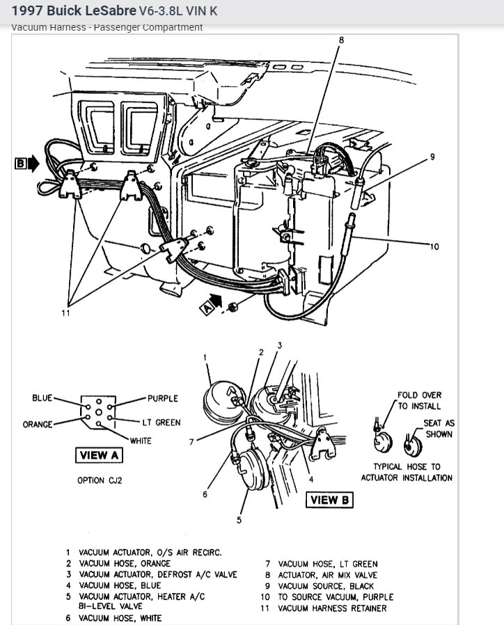

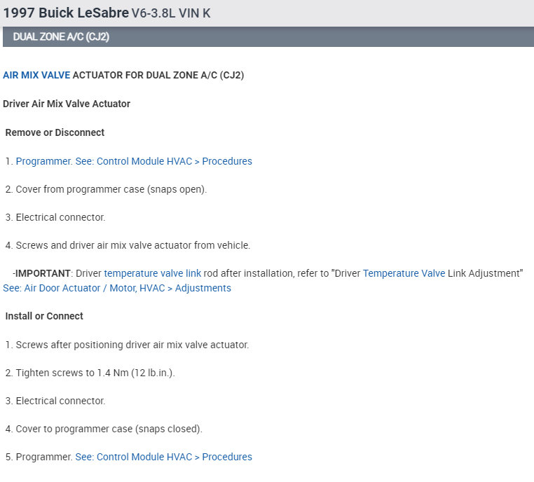

The car has that dual climate control the heat blows only on the driver's side,the passager side is blowing cold air,I've changed the thermostat
Dec 30, 2015 at 7:01 AM
SQM
  • 6,383 POSTS

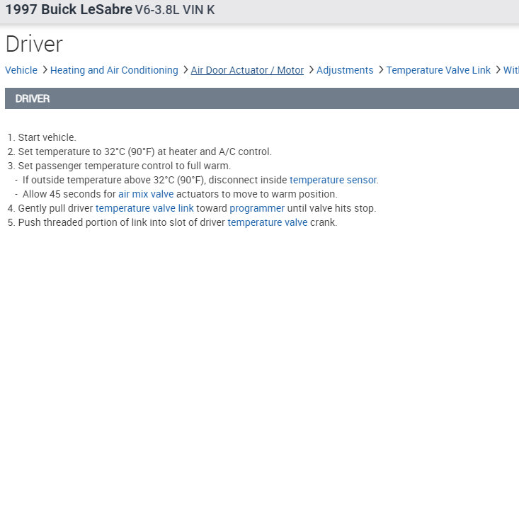

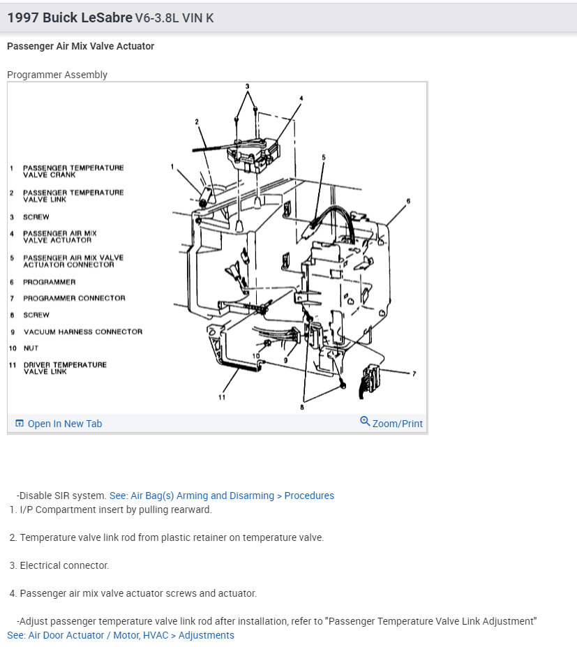

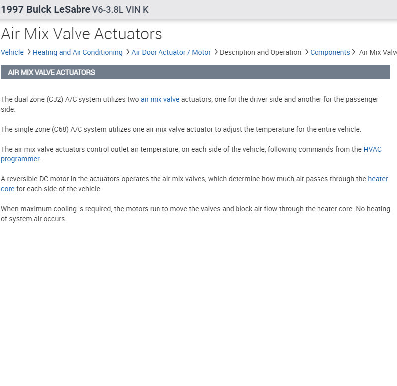

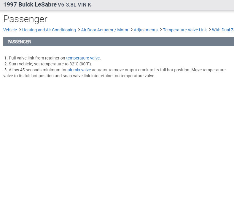

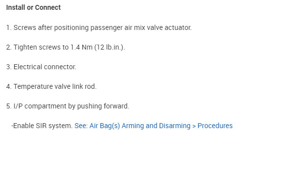

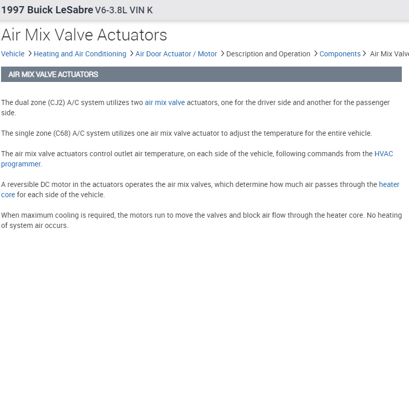

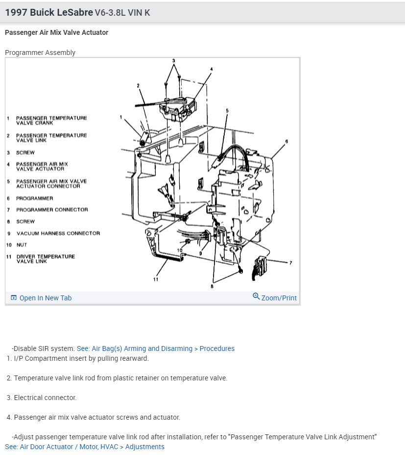

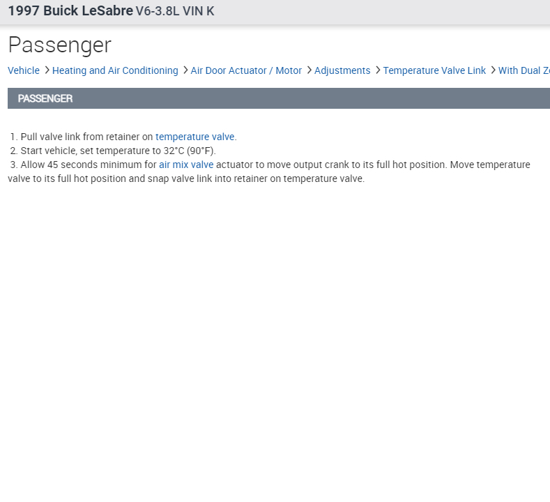

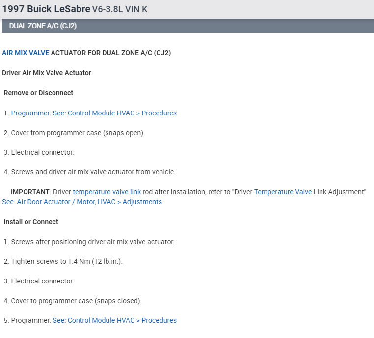

It sounds like the blend door actuator on the passenger side has failed.
The blend door actuator controls the hot and cold air flow.
Over time with normal use the actuator will fail. Many times when the actuator fails it will get stuck on one position (hot or cold).
The blend door actuator is located on the passenger side behind the dash panel in the HVAC box.
Here is a helpful article:
