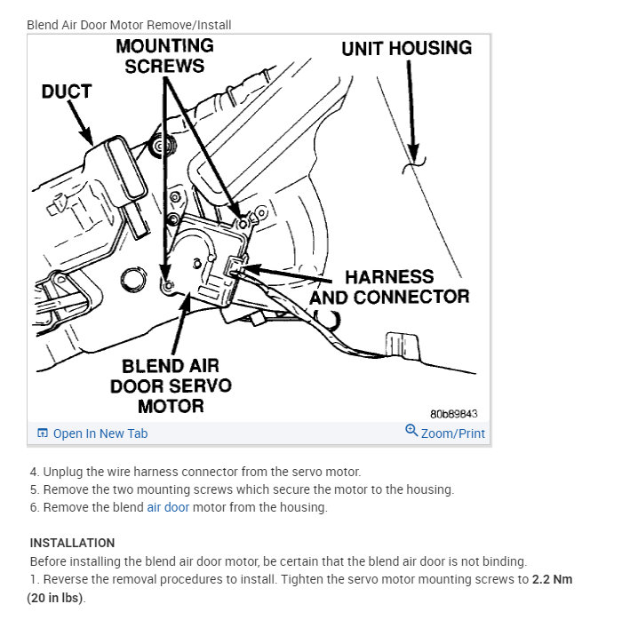

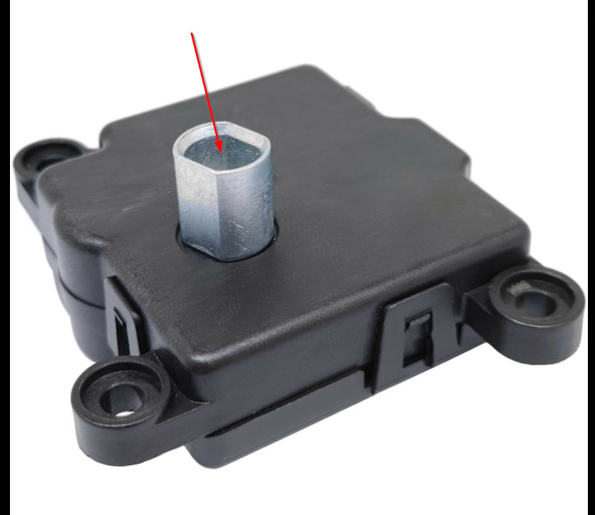

i need the plastic sleeve that connects the blend door pin to the control unit. where can i get one?
Nov 20, 2021 at 1:27 AM

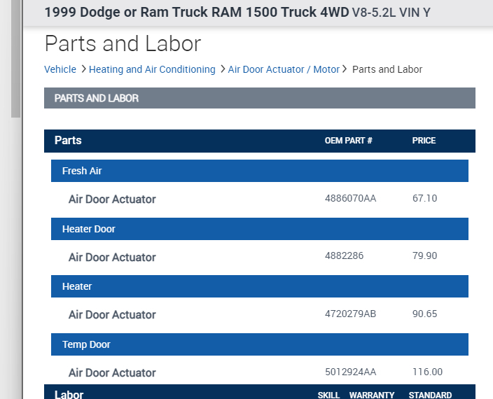

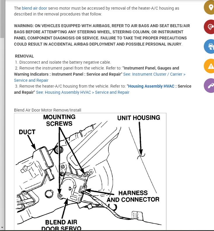

Are you talking about the actual pin that connects to the door inside the unit which inserts into the actuator?
I attached pictures below of what I am talking just to make sure we are on the same page.
I also attached the replacement info of the actuator for you or anyone else that needs it who visits this page.
If this is what you are referring to then I am not aware of anyone who sells this so you may need to go to a salvage yard and find one out of a unit.
Please review the attached info and let me know if you are talking about something different. Thanks
