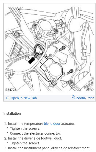

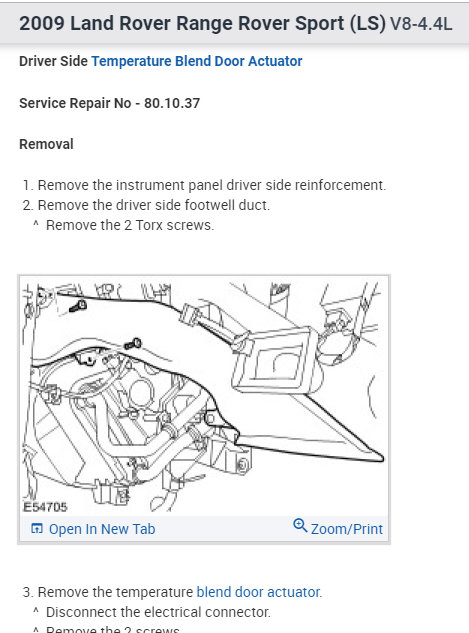

Where is my heater blend door actuator located at for the driver side?

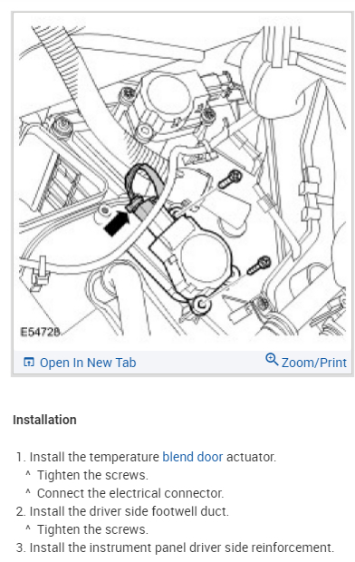

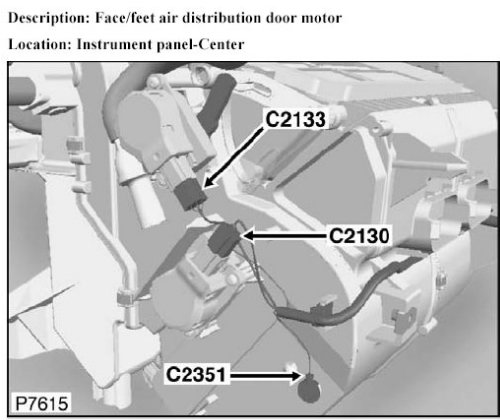

Hello, I'm Danny.
Here is a tutorial showing to to replace blend/air door actuator:
I've attached a picture of its location in the instrument panel- center and also attached are step-by -step directions for replacement.Hope this helps and thanks for using 2CarPros.
