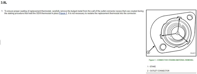

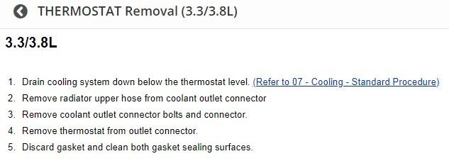

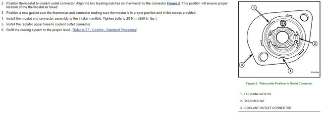

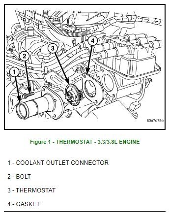

I would start with your thermostat. If it's stuck open, it's very possible it could be causing this condition. Attached below is the replacement procedure. Also, the attached link shows you how to test a thermostat for proper operation once it's removed from the engine.
https://www.2carpros.com/articles/how-an-engine-thermostat-works
Let us know what you find!

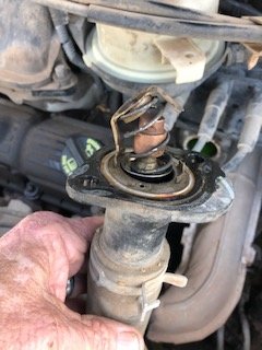

Masterwrench, I thought for sure you had me good to go when I saw the old thermostat. I put in a new one and it's doing the same thing. What should we try next?

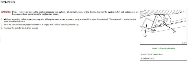

It does sounds like the cooling system has an air pocket. I would try to raise the car in the rear as far as you can while the engine and heater are running (fan on high) then raise the front this "tipping" can dislodge the air. Make sure the cooling system is open and be ready to add more coolant. These guides can help:
and
Nov 14, 2019 at 3:18 AM
