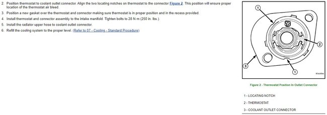

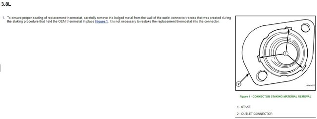

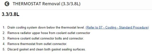

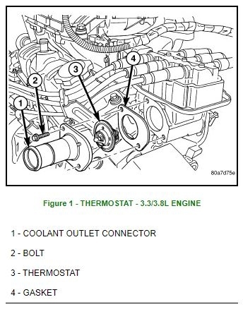

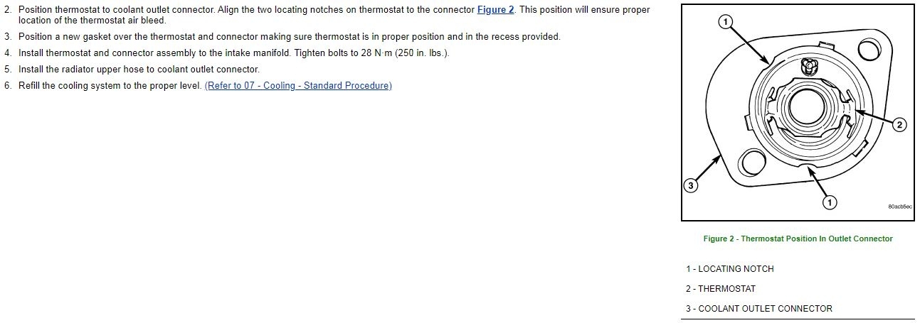

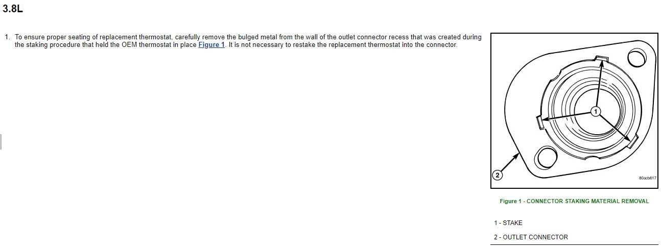

I would start with your thermostat. If it's stuck open, it's very possible it could be causing this condition. Attached below is the replacement procedure. Also, the attached link shows you how to test a thermostat for proper operation once it's removed from the engine.
https://www.2carpros.com/articles/how-an-engine-thermostat-works
Let us know what you find!

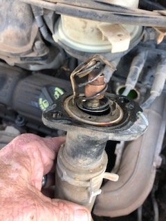

Masterwrench, I thought for sure you had me good to go when I saw the old thermostat. I put in a new one and it's doing the same thing. What should we try next?
Nov 10, 2019 at 12:26 AM
MASTERWRENCH
  • 258 POSTS
That's very strange. A thermostat in that condition would have most definitely caused the symptoms you were experiencing. For the condition to have not changed at all by replacing it, seems very odd. Has it improved at all? I would double check to make sure all the air has been purged from the cooling system. Take a look at the video below for more information.

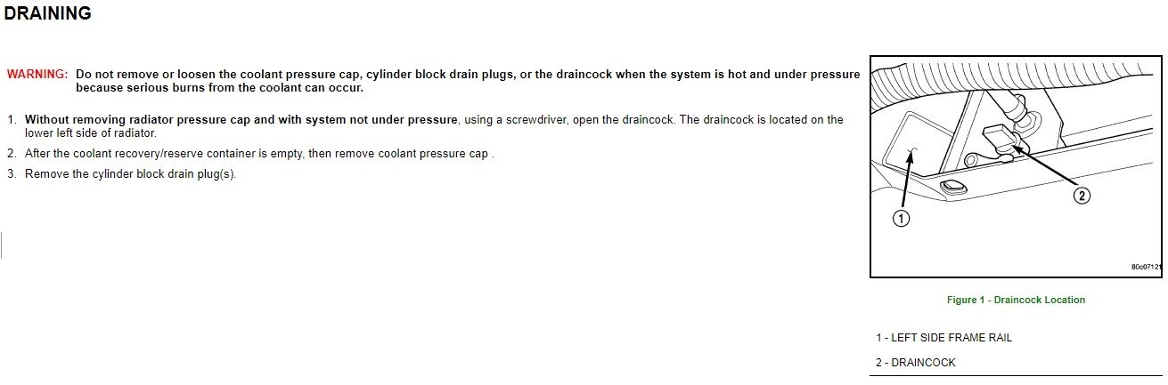

It does sounds like the cooling system has an air pocket. I would try to raise the car in the rear as far as you can while the engine and heater are running (fan on high) then raise the front this "tipping" can dislodge the air. Make sure the cooling system is open and be ready to add more coolant. These guides can help:
and
