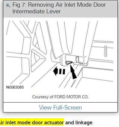

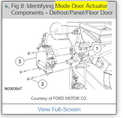

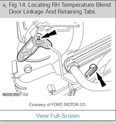

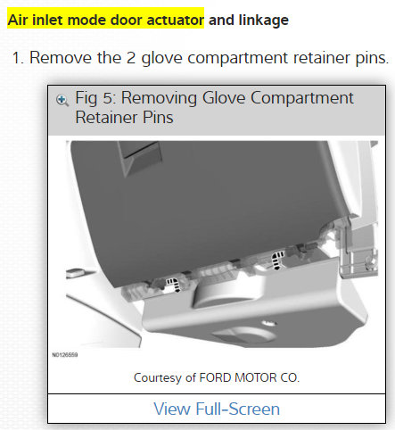

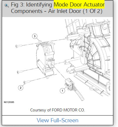

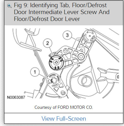

There is a blend door motor under the driver side of the dash that is the most common reason for this failure. I attached pictures and procedures for the replacement (BELOW).

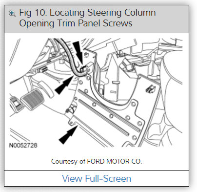

1. Remove the steering column trim panel.
- Remove the 2 steering column opening trim panel screws.
- Disengage the steering column opening trim panel from the retaining clips.
- Disconnect the electrical connector and aspirator hose, if equipped.

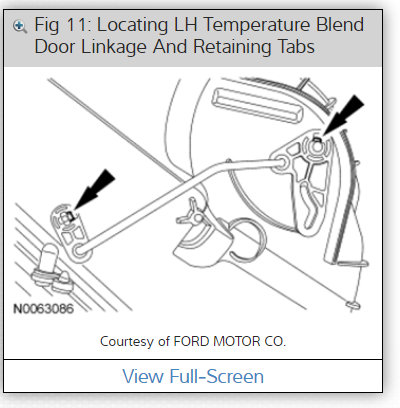

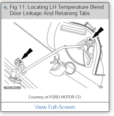

5. Manually operate, and inspect the LH temperature blend door linkage for incorrect placement, binding or damage.
LH temperature blend door linkage only
6. Detach the 2 retaining tabs and remove the LH temperature blend door linkage.
LH temperature blend door actuator and linkage
