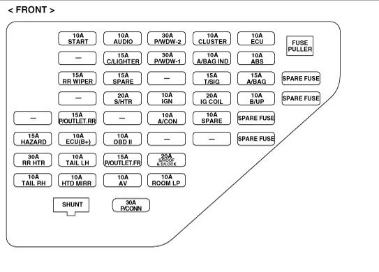

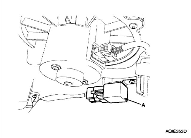

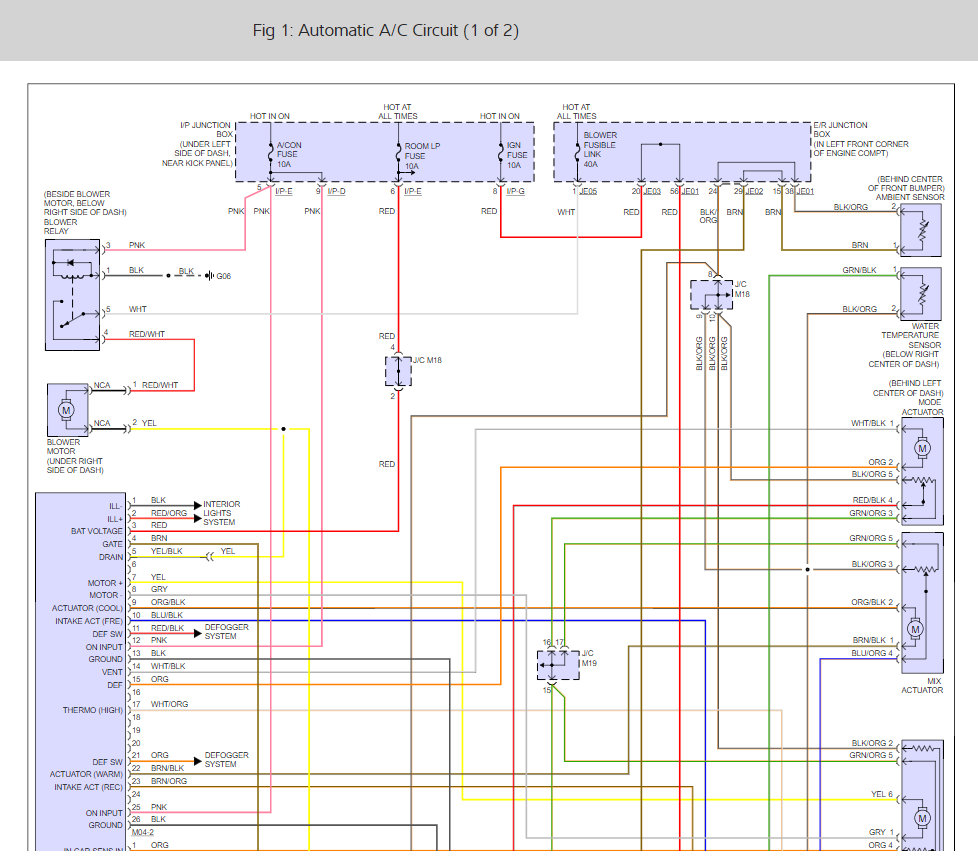

When you turn on the blower motor with the selection knob the fan does not turn on. I have tried replacing the thermistor resistor relay and also the fan itself and it still does not work.
Sep 30, 2017 at 9:04 AM
  • 55,433 POSTS

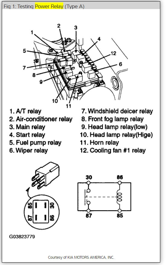

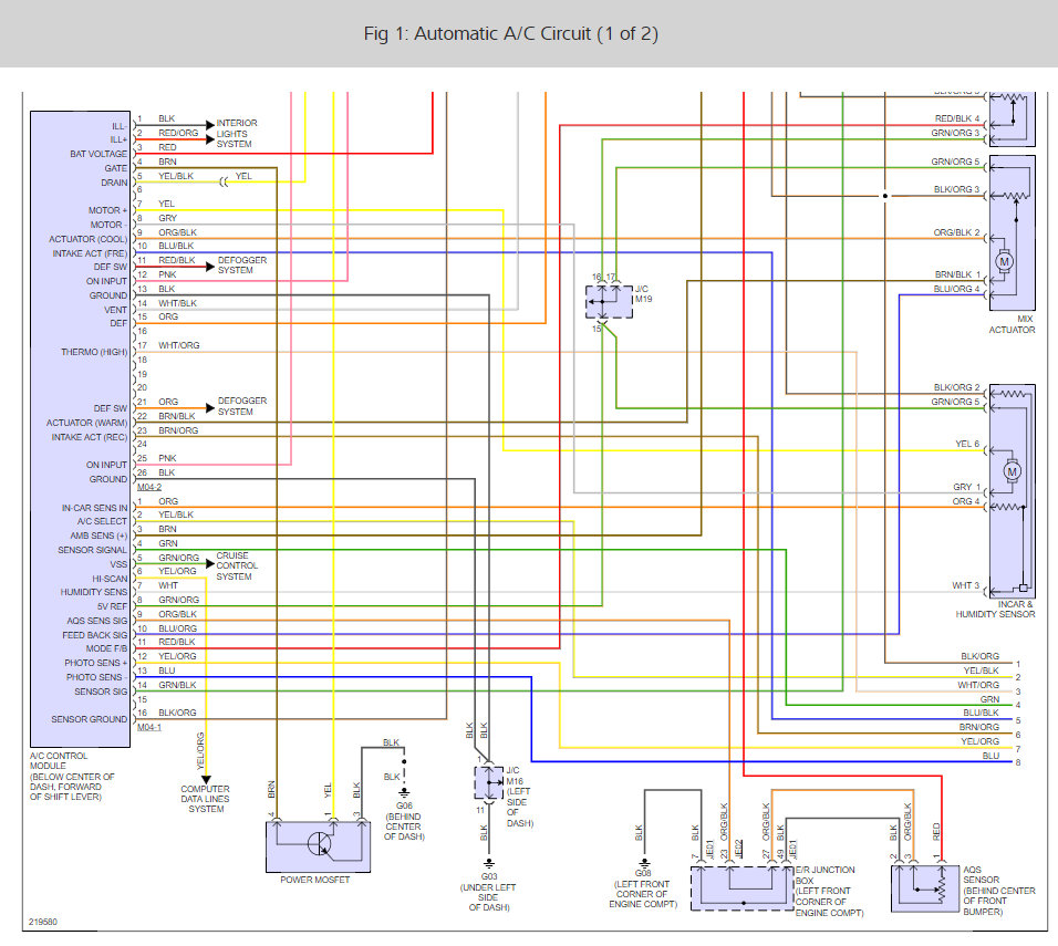

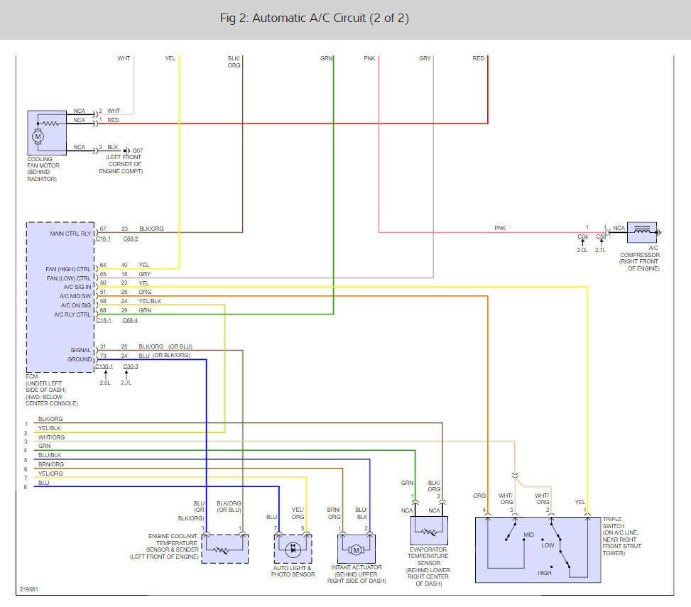

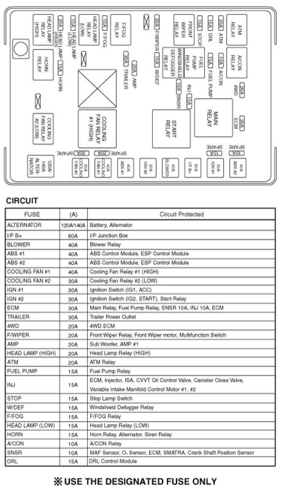

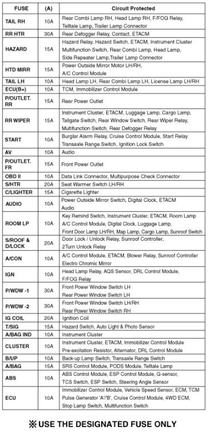

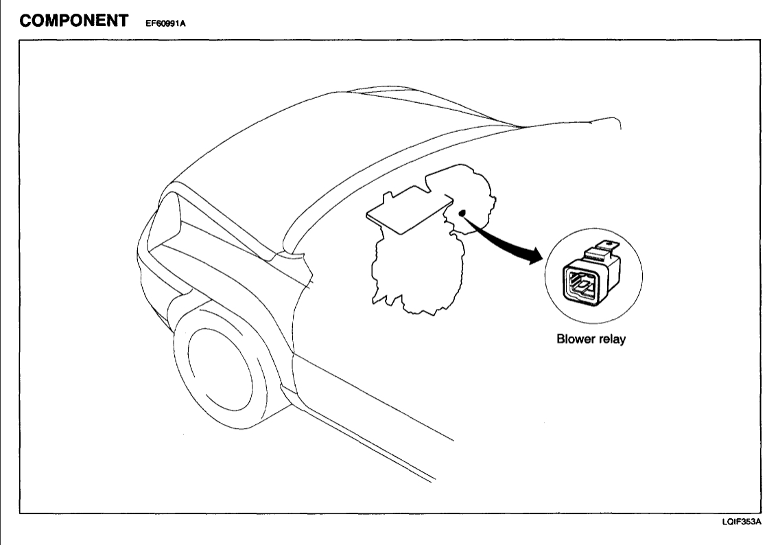

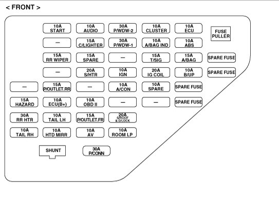

When you say thermistor relay is that the blower fan relay near the blower motor? We are losing power somewhere.
Here are some guides and diagrams to help us run some simple tests so we can get the problem fixed:
and
and
Please let us know what happens and upload pictures or videos of the problem.
