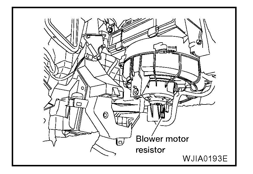

Hi! I have a problem with my heater/AC controls. The low and medium controls (1,2 and 3) don't work. Only the high (4) works! Can anyone tell me what the problem is and how I can fix it? Thanks!

It sounds like the blower motor resistor is bad. When they fail, most times they will only work on high speed.
Here are directions for replacement. The attached picture correlates with the directions.
_______________________
2003 Nissan-Datsun Altima L4-2.5L (QR25DE)
Procedures
Vehicle Heating and Air Conditioning Blower Motor Resistor Service and Repair Procedures
PROCEDURES
BLOWER FAN RESISTER
pic 1
Removal and Installation
1. Disconnect blower motor resistor connector.
2. Remove blower motor resistor screws and then remove it.

Hi Joe! Just to let you know that the resistor did take care of the problem. Thanks a lot for your help once again and take care of yourself.
