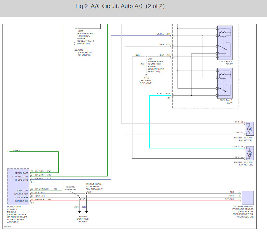

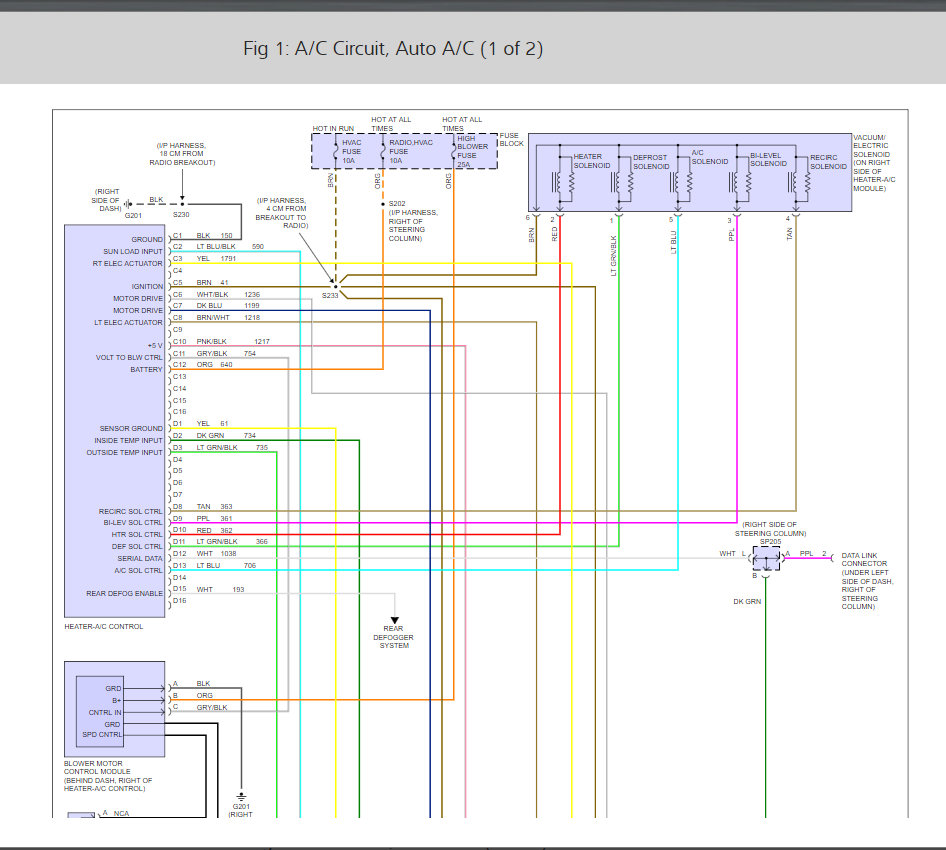

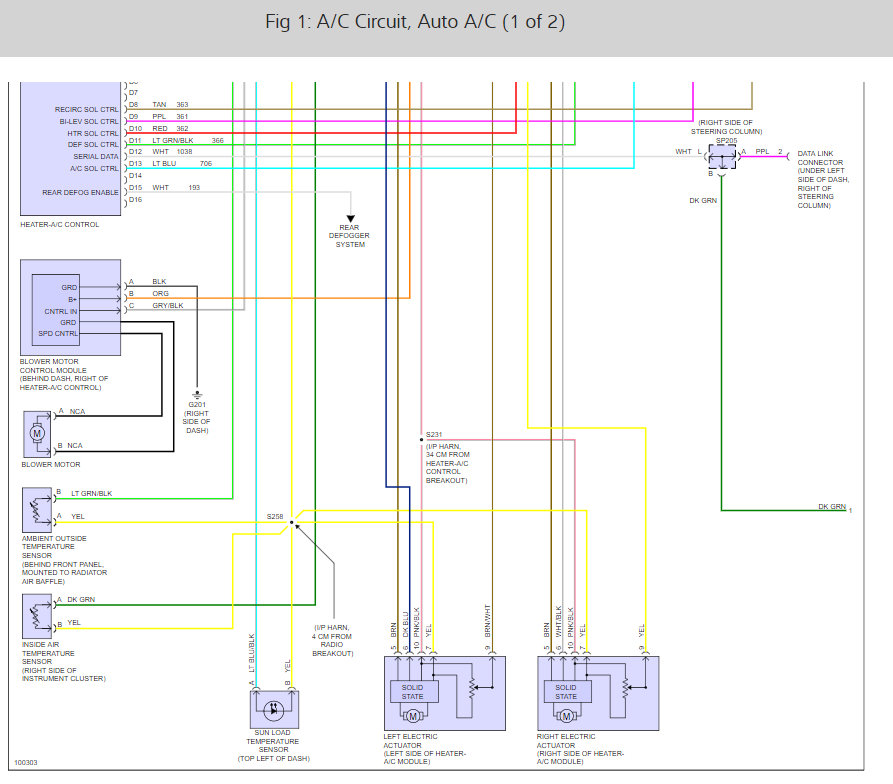

This guide will show you how to check the power and ground of the blower motor to help determine if the problem is the fan motor or something else.
https://www.2carpros.com/articles/blower-fan-motor-works-on-high-speed-only
Here is the blower fan wiring diagrams so you can see how then system works.
